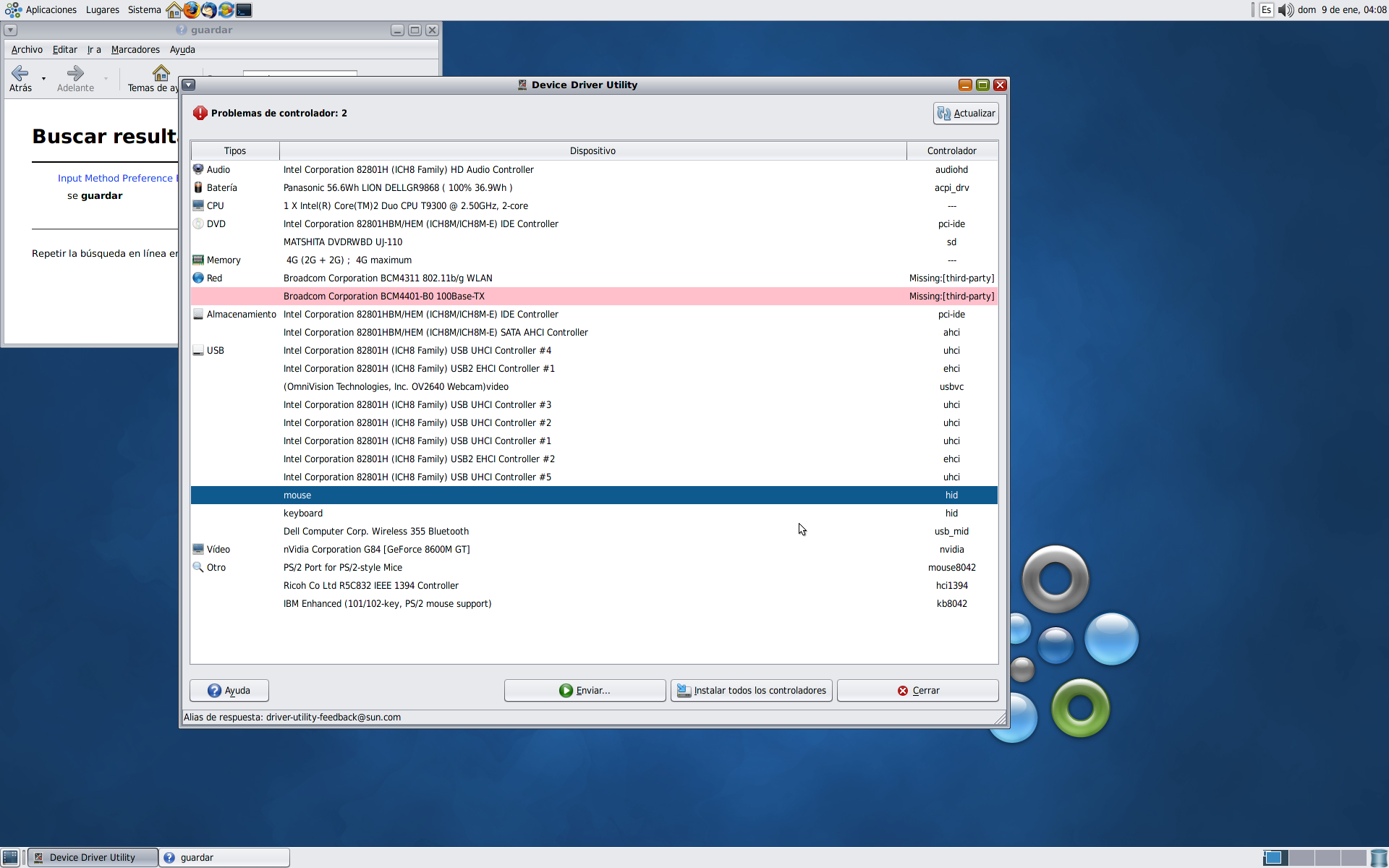

José Rodríguez Posted January 9, 2011 Share Posted January 9, 2011 Hi Sorry, it is an inspiron 1720 T9300, processor 2,5 ghz, chispet 965 , 4 gig memory, nvidia 8600GT 256 megas memory, I don´t Know if you need more information Thanks Hi Sorry, it is an inspiron 1720 T9300, processor 2,5 ghz, chispet 965 , 4 gig memory, nvidia 8600GT 256 megas memory, I don´t Know if you need more information Thanks Here all the information the chipset is Mobile Intel PM965 Express send_me.zip Link to comment https://www.insanelymac.com/forum/topic/235523-dsdt-auto-patcher/page/59/#findComment-1618586 Share on other sites More sharing options...
LatinMcG Posted January 9, 2011 Share Posted January 9, 2011 pin config is added to hdef section in dsdt.. jose u have almost same laptop almost as me. 1520 with 8600mgt try vostro1500=has x3100so try m1530 or m1330 .. or generic autopatch edit: u allready patched your dsdt apparently.. and u have USB device id in all the usb? i didnt need that. only EHC1 EHC2 patch. by the way u have 2 sata ports. i dont. Link to comment https://www.insanelymac.com/forum/topic/235523-dsdt-auto-patcher/page/59/#findComment-1618597 Share on other sites More sharing options...
José Rodríguez Posted January 9, 2011 Share Posted January 9, 2011 pin config is added to hdef section in dsdt.. jose u have almost same laptop almost as me. 1520 with 8600mgt try vostro1500 autopatch edit: u allready patched your dsdt apparently.. and u have USB device id in all the usb? i didnt need that. only EHC1 EHC2 patch. by the way u have 2 sata ports. i dont. Hi thank you for your help, this is a dsdt that I did some days ago but I am not sure if it is ok, can you take a look at it please? dsdt.Jos____Rodr___guez.zip Link to comment https://www.insanelymac.com/forum/topic/235523-dsdt-auto-patcher/page/59/#findComment-1618611 Share on other sites More sharing options...
