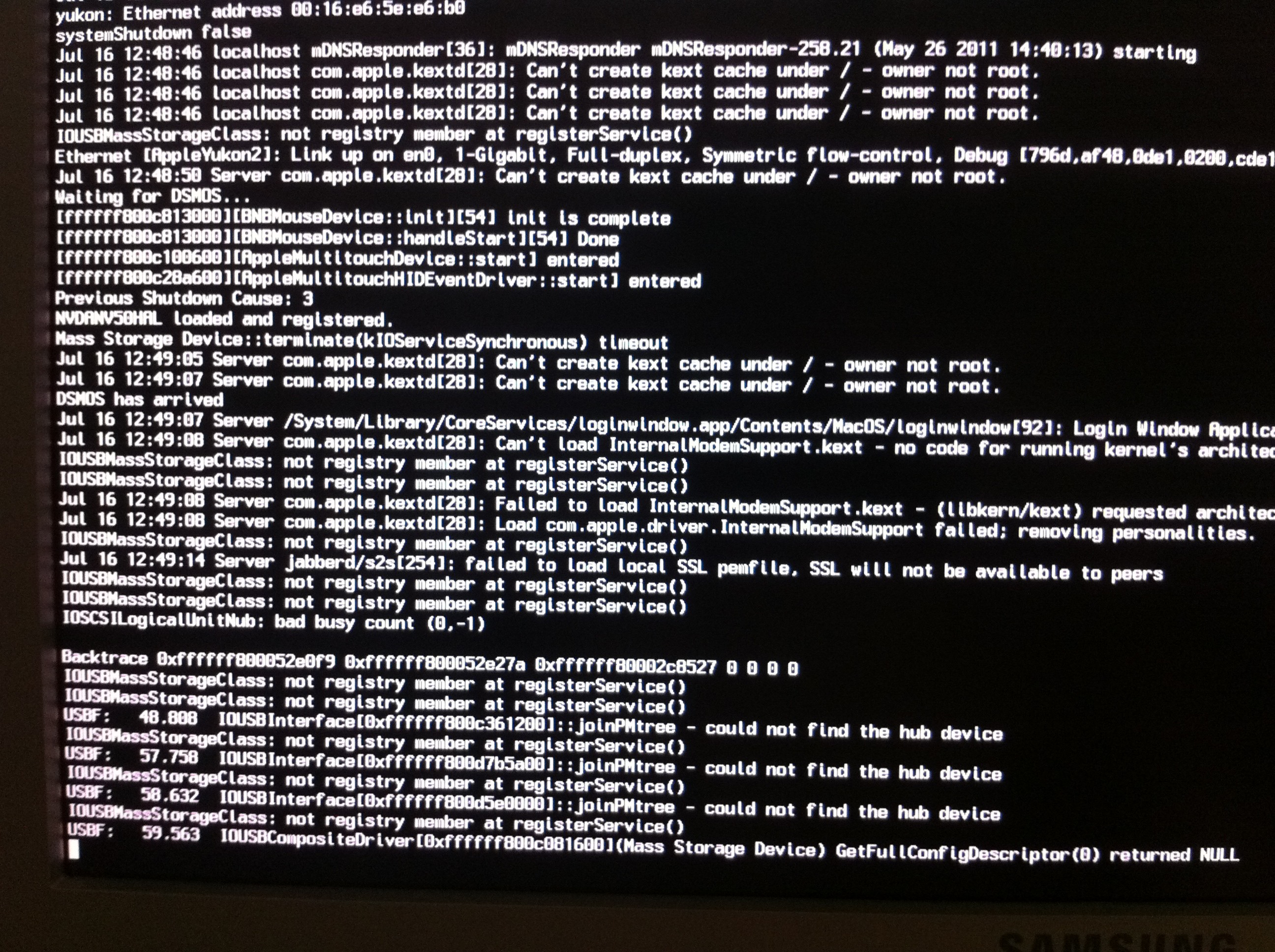

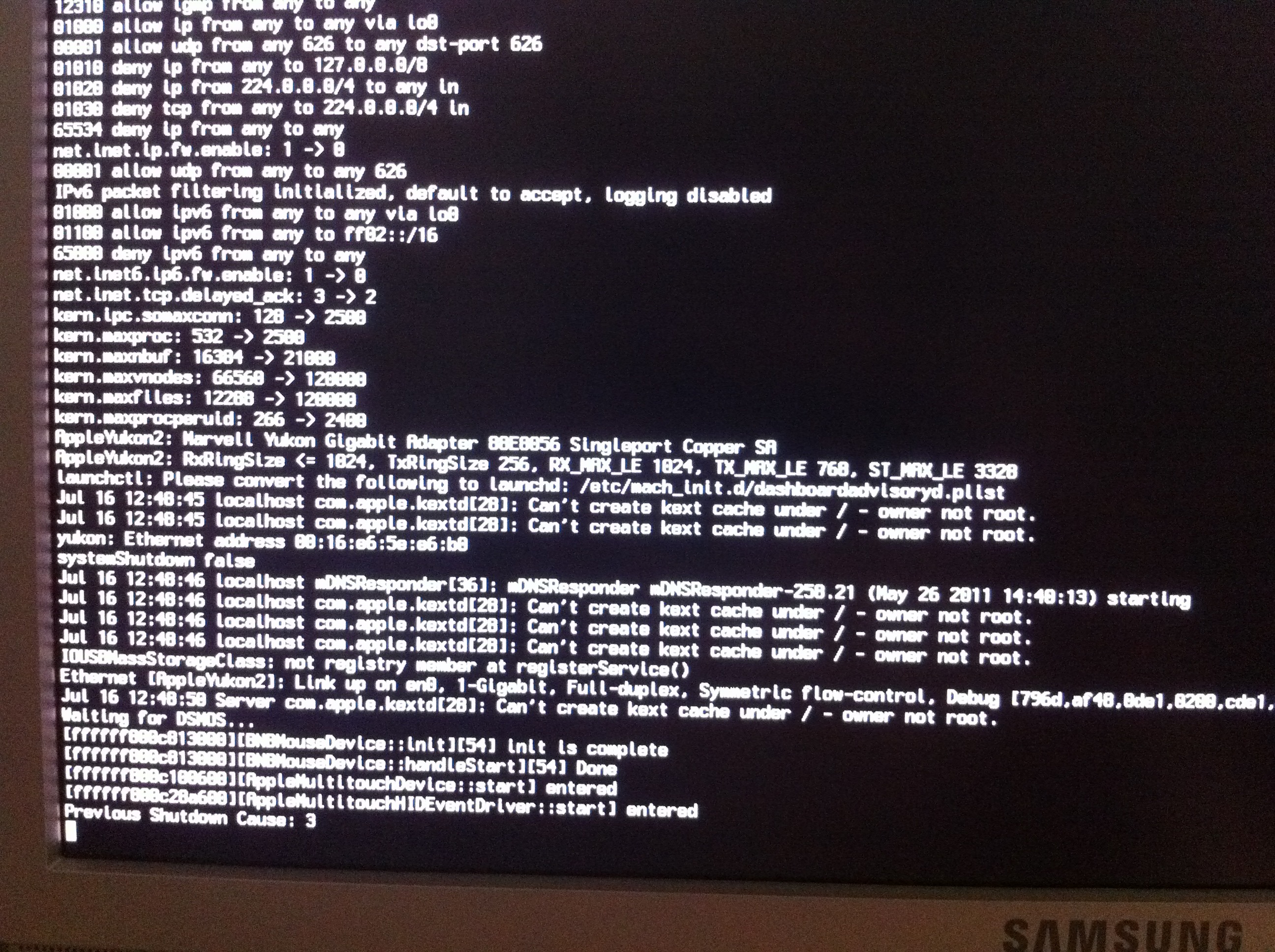

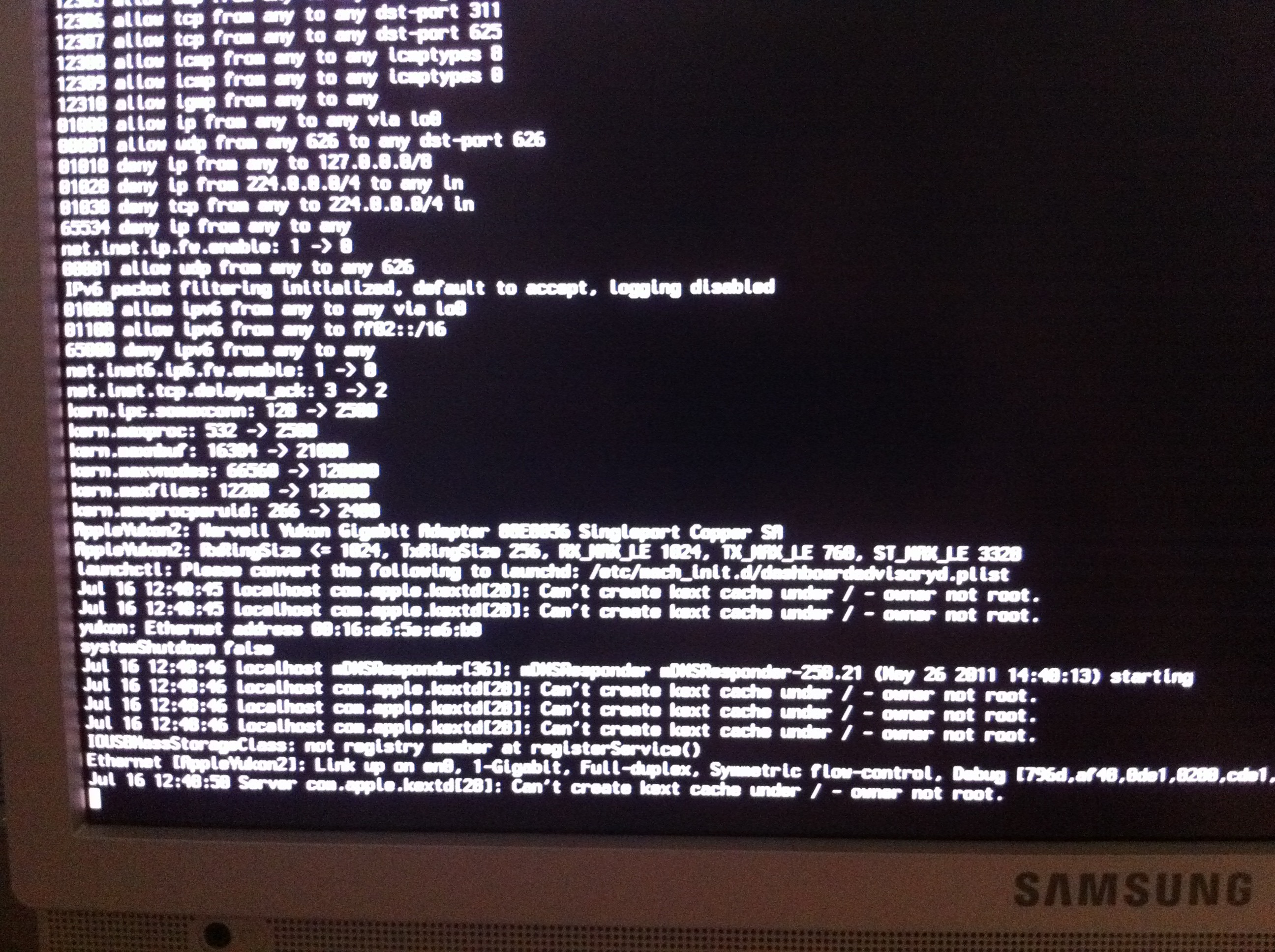

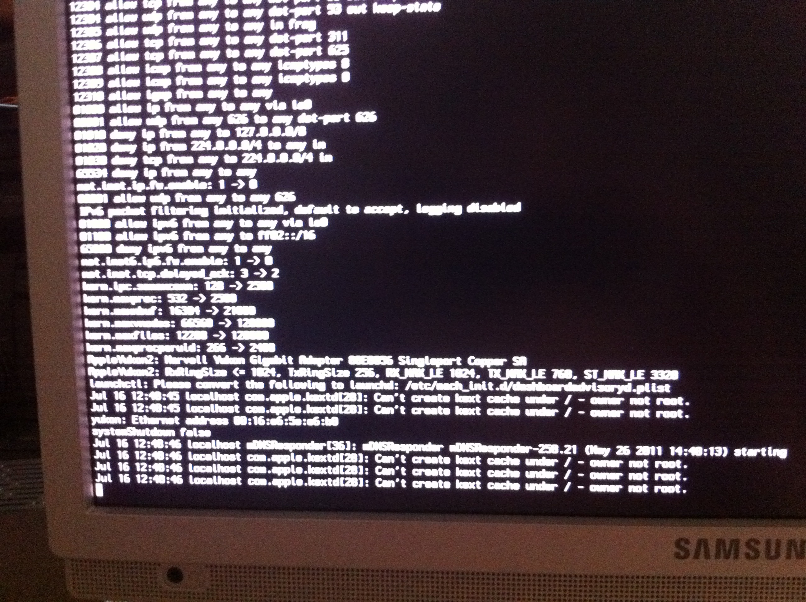

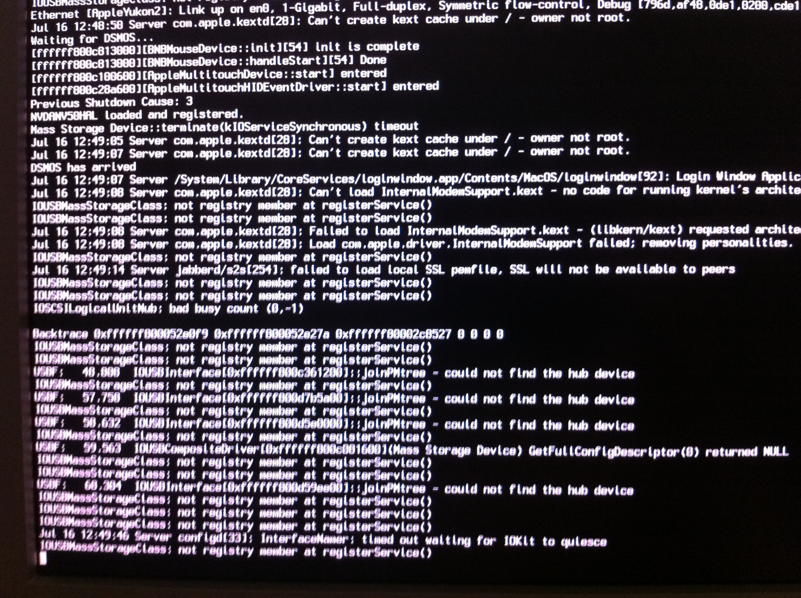

Cartier82 Posted July 15, 2011 Share Posted July 15, 2011 very strange try it dsdt.Cartier82.zip MaLd0n, thank you for answering so quickly I've tried and the problem persists with the front USBs. USB flash drives and USB hard drives are disconnected unexpectedly. What difference has this initial DSDT with mine? Keep the new or old? Any advice. Link to comment https://www.insanelymac.com/forum/topic/235523-dsdt-auto-patcher/page/178/#findComment-1715296 Share on other sites More sharing options...

MaLd0n Posted July 16, 2011 Author Share Posted July 16, 2011 I've tried and the problem persists with the front USBs. USB flash drives and USB hard drives are disconnected unexpectedly.What difference has this initial DSDT with mine? Keep the new or old? use old DSDT this problem must be "physical" no? Could you do my dsdt for Acer Aspire T630 P4 3ghz please. only basic dsdt.wokko.zip Link to comment https://www.insanelymac.com/forum/topic/235523-dsdt-auto-patcher/page/178/#findComment-1715351 Share on other sites More sharing options...

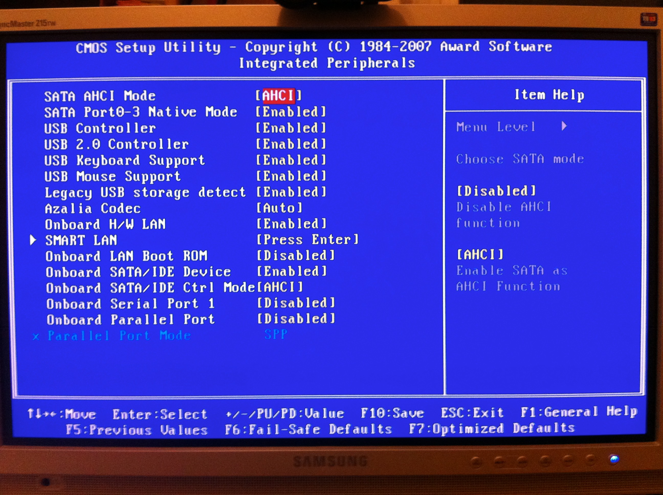

Cartier82 Posted July 16, 2011 Share Posted July 16, 2011 use old DSDTthis problem must be "physical" no? I think there is any hardware problem, when I installed Lion from a flash USB drive and I used the front USBs without problems. The USB bluetooth is running properly on the front USB. It's may be a conflict of drivers or bios settings wrong, I think. I send you a bios and boot screenshots. Thanks Link to comment https://www.insanelymac.com/forum/topic/235523-dsdt-auto-patcher/page/178/#findComment-1715443 Share on other sites More sharing options...

Cartier82 Posted July 16, 2011 Share Posted July 16, 2011 do you use USB RollBack? Nop, I only use AHCIPortInjector, FakeSMC, IOAHCIBlockStorageInjector from Extra_Mac Pro 3.1 and IONetworkingFamily (Network patcher). I have change AppleHDA in S/L/E to make sound work. Thanks Link to comment https://www.insanelymac.com/forum/topic/235523-dsdt-auto-patcher/page/178/#findComment-1715623 Share on other sites More sharing options...

MaLd0n Posted July 16, 2011 Author Share Posted July 16, 2011 Nop, I only use AHCIPortInjector, FakeSMC, IOAHCIBlockStorageInjector from Extra_Mac Pro 3.1 and IONetworkingFamily (Network patcher). I have change AppleHDA in S/L/E to make sound work. I have no idea ICH8 is very compatible vaio (VPCEB3C5E) remove Disabler.kext see the firt post, NativePM and restart fix dsdt.Dannii.zip Link to comment https://www.insanelymac.com/forum/topic/235523-dsdt-auto-patcher/page/178/#findComment-1715639 Share on other sites More sharing options...
