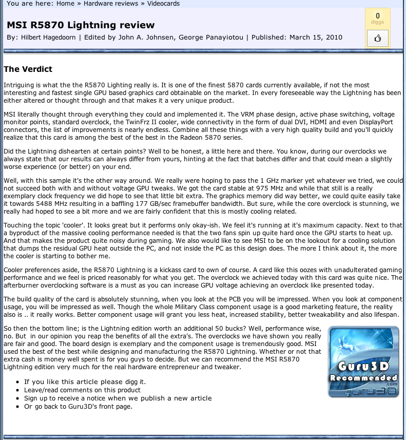

cairo_sc Posted September 18, 2010 Share Posted September 18, 2010 I have an Asus 5870, and it works fine, but if you buy a MSI R5870 Lightning 1GB, it gonna fly!! I w'd go, with no doubt, for a MSI R5870, and plus: you gonna save £78.38 =D p.s.: can't tell you about the compatibility with OSX, but i'm sure it gonna work like any other R5870. take a look on this screen, is a final thoughts about this card on Guru3d.com Link to comment https://www.insanelymac.com/forum/topic/231290-5870-up-and-running-64-bit-natively/#findComment-1550394 Share on other sites More sharing options...

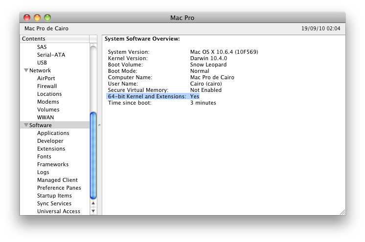

cairo_sc Posted September 19, 2010 Share Posted September 19, 2010 You have the same config I do, so I don't see why it wouldn't work on your hackintosh. Just make sure you use the rom from netkas and flash it wit atiflash and the following commands: ATIFLASH -fa -fm -fs -fp -p 0 XFX5870.rom Assuming you renamed the rom that way and that the card is in the top pci-e port. Strangely I manage to hook up a working display on every port (DVI x2, HDMI, and the minidisplay one) at the same time. Even tough ATI says this can't be done, but that is under Windows, maybe OSX has a different approach on how to address the card. 5: Flashed the card with the XFX5870_1.rom from netkas blog with the latest ATIFlash from TechPowerup. I don't see the point of doing it since Netkas only modified the EFI part of the ROM ?!i And also, try the bootloader from kabyl, it should exempt you from using a ROM file http://www.insanelymac.com/forum/index.php...231768&st=0 Yeap, i've go it working on 64 bits mode =D no UseAtiROM needed, and i should probably not have flashed my card. Just used bootloader from kabyl, thx Trauma! for the tip! And thx xgportal for your tutorial! Link to comment https://www.insanelymac.com/forum/topic/231290-5870-up-and-running-64-bit-natively/#findComment-1550656 Share on other sites More sharing options...

cairo_sc Posted September 19, 2010 Share Posted September 19, 2010 replace the boot file with traumas or Kabyl this is where i am confused... kabyl's boot is the one to be used, here the boot's link: kabyl's boot file and here is the topic: http://www.insanelymac.com/forum/index.php...231768&st=0 Link to comment https://www.insanelymac.com/forum/topic/231290-5870-up-and-running-64-bit-natively/#findComment-1550950 Share on other sites More sharing options...
