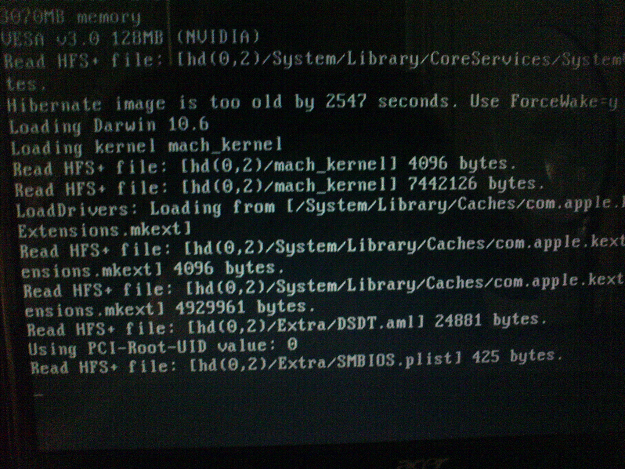

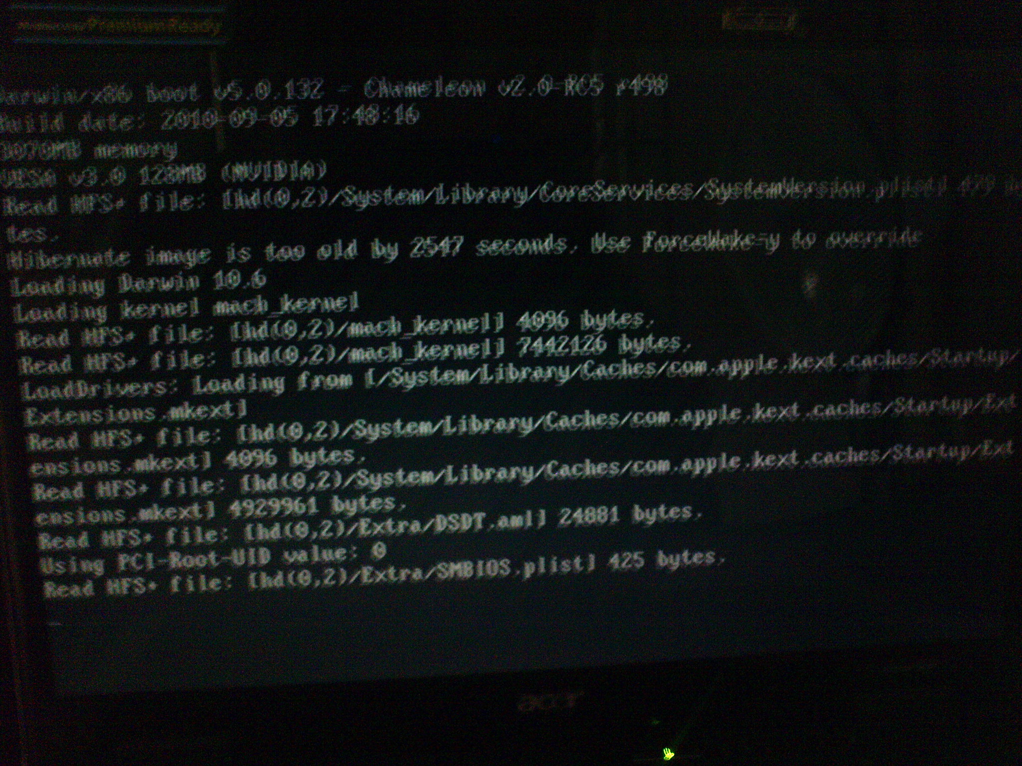

асик Posted September 10, 2010 Share Posted September 10, 2010 Has established Chameleon_v2.0_RC5_r498 on the laptop acer 5684. Costs Snow 10.6.3 (fakesmc_rev_391). At loading stops on it. smbios.zip Link to comment https://www.insanelymac.com/forum/topic/231075-chameleon-24svn-official-pkg-installer/page/2/#findComment-1545889 Share on other sites More sharing options...
mitch_de Posted September 10, 2010 Share Posted September 10, 2010 Maybe nothinh to do with chameleon. Does your PC needs 32 Bit Kernelflag to boot ? If you used much older chameleon, check if you also changed 32 Bit kernelflag to arch=i386 insted of very old -x32 flag. Also good to know it you had run the PC before the update of chameleon with sucess or its the first install. Also check you smbios for corruption if it freezes in that section. Link to comment https://www.insanelymac.com/forum/topic/231075-chameleon-24svn-official-pkg-installer/page/2/#findComment-1545909 Share on other sites More sharing options...
buoo Posted September 10, 2010 Share Posted September 10, 2010 Has established Chameleon_v2.0_RC5_r498 on the laptop acer 5684. Costs Snow 10.6.3 (fakesmc_rev_391). At loading stops on it. Why do you emulate a MacBookPro2,1 ? Maybe the problem is this. Test MacBookPro5,1 Link to comment https://www.insanelymac.com/forum/topic/231075-chameleon-24svn-official-pkg-installer/page/2/#findComment-1545918 Share on other sites More sharing options...

асик Posted September 10, 2010 Share Posted September 10, 2010 Why do you emulate a MacBookPro2,1 ?Maybe the problem is this. Test MacBookPro5,1 Put smbios from MacBookPro 5,1, all the same the same situation Maybe nothinh to do with chameleon.Does your PC needs 32 Bit Kernelflag to boot ? If you used much older chameleon, check if you also changed 32 Bit kernelflag to arch=i386 insted of very old -x32 flag. Also good to know it you had run the PC before the update of chameleon with sucess or its the first install. Also check you smbios for corruption if it freezes in that section. The system not to be loaded, in com.apple.boot.plist costs arch=i386 Chameleon_2.0_RC5_r513 It only put With Acerbln and a simple chameleon normally to be loaded Now I will start to reinstall system Link to comment https://www.insanelymac.com/forum/topic/231075-chameleon-24svn-official-pkg-installer/page/2/#findComment-1545943 Share on other sites More sharing options...
