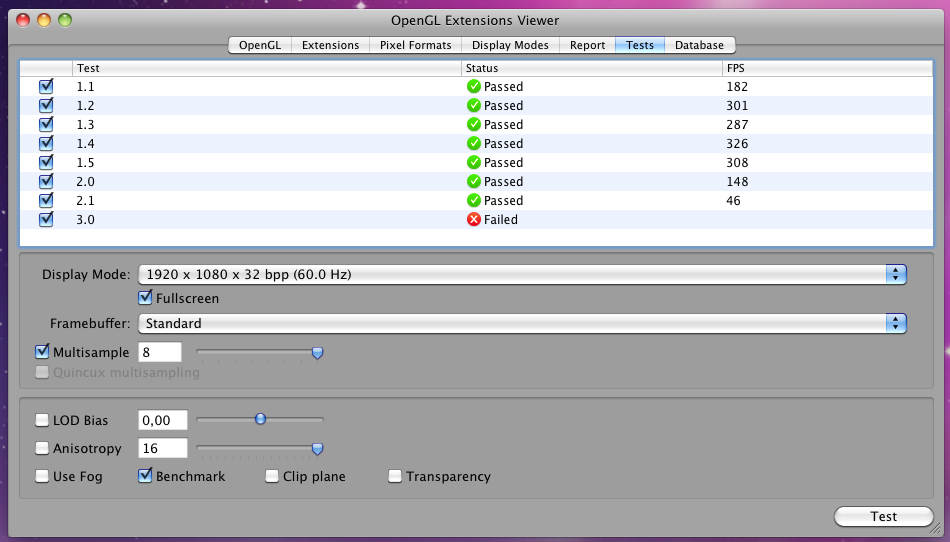

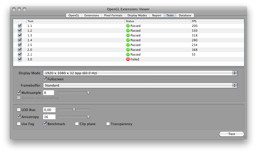

sch8mid Posted July 26, 2010 Share Posted July 26, 2010 Looking for testers Got a HD 5770 here in 10.6.4 tested a. in 32 bit mode with netkas drivers and ATY-init b. in 64 bit mode using 1.9 Aseres BL modified for 5xxxx Resolution-Quartz-dual Monitors - HDMI -TV all work OpenCL performance is very good with smalluxGPU benches (better than ATI 4870) BUT : Got severe degradation in "OpenGL Extensionviewer" benches and I think I am not the only one.. you can download this very good app , that shows you a lot information about your GC here: http://www.realtech-vr.com/glview/ In non benchmark mode my card hits 2800 fr . My 3 year old ATI 3870 4500 fr. And in Benchmark mode and activated Multisample and Anisotropy the card gets completely down on its knees . look: Can someone please confirm this ? please be sure that you hit the benchmark ,multisample,and anisotropy button ! Now the intersting part of the story : Morpheus/ Netkas 5xxx card seems to behave much better : And can someone of the more enlighted specialist shed a light on this ?? Best armin Link to comment Share on other sites More sharing options...

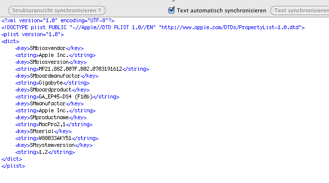

The Finale of Seem Posted July 26, 2010 Share Posted July 26, 2010 It's a longshot, but what model is your hackie pretending to be? I only ask because I just found out through some trial and error that 10.6.4 does not like Nvidia cards + Mac Pro 4,1 in OSx86. I was getting a fraction of the real performance until I edited the SMBIOS.plist file to make it a Mac Pro 3,1 instead, which magically restored performance. Don't ask me why, but it's a wild stab in the dark that might just work out for you. Link to comment Share on other sites More sharing options...
sch8mid Posted July 27, 2010 Author Share Posted July 27, 2010 Hi FoS Thats right and very interesting and its true , I am on Macpro 4.1 and will try your suggestion though in geekbench , measuring cpu and fpu performance there is no gap between my former mac pro 3.1 under 10.5.8 Thanks a lot Link to comment Share on other sites More sharing options...
sch8mid Posted July 27, 2010 Author Share Posted July 27, 2010 sorry to say edited smbios.plist macpro 3.1 no positive effect macpro 2.1 no positive effect here is my current : would be nice if one of the 5770 owners would add his personal test here cause I really have no clue , why i got so bad results compared to netkas tests. Link to comment Share on other sites More sharing options...
xX_SynT@x_Xx Posted July 27, 2010 Share Posted July 27, 2010 I made a test in 32bit. 64bit is not yet possible. HIS ATi 5770 Link to comment Share on other sites More sharing options...
sch8mid Posted July 27, 2010 Author Share Posted July 27, 2010 Thanx XX so we see the absolute same behavior Whats going on here ???? --and why does noone bother of the 5xxxx users ?? Link to comment Share on other sites More sharing options...

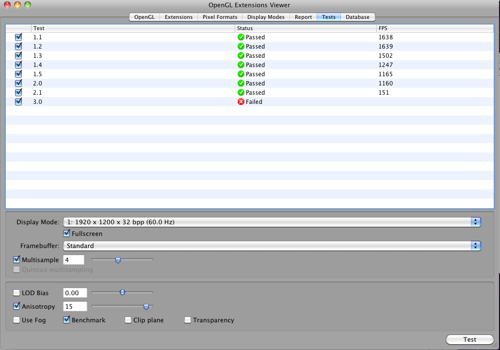

M0rpheus Posted July 27, 2010 Share Posted July 27, 2010 The screenshot of the OpenGL extensions viewer from Netkas' site was originally from my Hackintosh, as I was the first to get the 5870 working. I did however have a newer OpenGL and OpenCL framework installed on my machine than the normal 10.6.4. I installed the 10.6.4 update that was meant for the Mac Mini and contains the driver kexts for the 5000 series. These newer frameworks could have resulted in higher benchmark results for me. I recommend you download the Mac mini 10.6.4 specific update and extract the frameworks from that using Pacifist, and install them yourself. Link to comment Share on other sites More sharing options...
sch8mid Posted July 27, 2010 Author Share Posted July 27, 2010 thanx Morpheus...hat off this is a phantastic reply and saves me and others a lot of headache I even installed 10.6.4 twice ____ But: Whats the safest way to install the frameworks in question : OpenCL OpenGL ___ Quartz ? QuartzCore? Select it and install it with Pacifist ? Link to comment Share on other sites More sharing options...
xbb Posted July 27, 2010 Share Posted July 27, 2010 The screenshot of the OpenGL extensions viewer from Netkas' site was originally from my Hackintosh, as I was the first to get the 5870 working. I did however have a newer OpenGL and OpenCL framework installed on my machine than the normal 10.6.4. I installed the 10.6.4 update that was meant for the Mac Mini and contains the driver kexts for the 5000 series. These newer frameworks could have resulted in higher benchmark results for me. I recommend you download the Mac mini 10.6.4 specific update and extract the frameworks from that using Pacifist, and install them yourself. /System/Library/OpenCL.framework and /System/Library/OpenGL.framework just these two? Thanks Link to comment Share on other sites More sharing options...

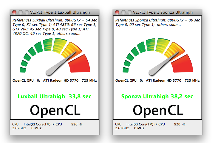

lenn4rd Posted July 27, 2010 Share Posted July 27, 2010 I started the benchmark incase you need another result for comparison. My system specs are listed below. I tried the smallux benchmark as well, but the slg process crashes. Update: I also ran the Luxball and Sponza Ultrahigh benchmarks and attached a screenshot. I got 33.8 and 38.2 sec, respectively. Kind regards, Lennard Link to comment Share on other sites More sharing options...
sch8mid Posted July 27, 2010 Author Share Posted July 27, 2010 I started the benchmark incase you need another result for comparison. My system specs are listed below. I tried the smallux benchmark as well, but the slg process crashes. Update: I also ran the Luxball and Sponza Ultrahigh benchmarks and attached a screenshot. I got 33.8 and 38.2 sec, respectively. Kind regards, Lennard Thanx Lennard Smalluxbenches OpenCL Pixelfilterbench is a no go for ati (appl. closes) But your VaporX 5770 performed best so far but way off Morpheus performance it would be interesting to see his OpenCL benches as a reference for you Sponza bench: 44 sec. Link to comment Share on other sites More sharing options...
lenn4rd Posted July 27, 2010 Share Posted July 27, 2010 You're welcome! Glad I could be of help because I always enjoy a comparison and being able to judge a system correctly. I'm wondering how much of a difference the newer Mac mini frameworks make. According to the screenshot posted they should improve performance by factor of 6 if only the graphics adaptor is measured (ran OpenGL Viewer for the first time). I'll try installing the frameworks over the next days—after backing up that is. Link to comment Share on other sites More sharing options...
sch8mid Posted July 27, 2010 Author Share Posted July 27, 2010 here are the results with win 7 though performance in non - benchmarkmode is slightly better with win 7 = 3200 fr the multiple cubes on win 7 = benchmark test on Mac performs just the same if not worse Now this is over my head where they got their 1000 fr in benchmarkmode and just a mac- 5670 benchmark was released with opengl 3.0 in green ??? Link to comment Share on other sites More sharing options...
mitch_de Posted July 28, 2010 Share Posted July 28, 2010 I started the benchmark incase you need another result for comparison. My system specs are listed below.I tried the smallux benchmark as well, but the slg process crashes. Update: I also ran the Luxball and Sponza Ultrahigh benchmarks and attached a screenshot. I got 33.8 and 38.2 sec, respectively. Kind regards, Lennard Thanks - very fast benchmark times ! Will be used as reference in soon uploaded macupdate version. ) ATI OpenCL drivers (5xxx gpus only) has problems in OpenCL Pixelfilterbench (its like CoreImage usage). ATI 48xx or any NV can run that. Also unclear if ATI can run the new Instances scene. Have you tried to run instances scene (select instances 130 Mill scene in the interactivemode). Link to comment Share on other sites More sharing options...

le jean Posted July 29, 2010 Share Posted July 29, 2010 I just installed the framework extracted from the mac mini Update, yet I can not see any progress in Glview scores. Link to comment Share on other sites More sharing options...

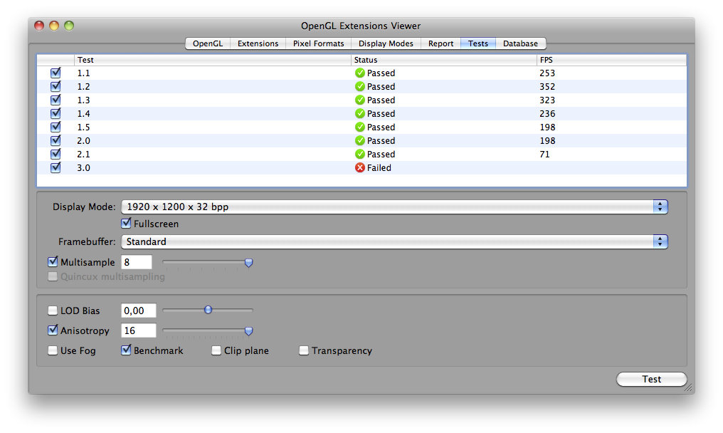

sch8mid Posted July 29, 2010 Author Share Posted July 29, 2010 Yepp same here did a Timemachine backup ...installed opengl framework with Pacifist -as well as the new framebuffers and the quartz frameworks) though do not know if all went well ..but had no KP restarted without any problems but just a little lower as your score under 200 fr. my 3850 scored 1400 in Benchmarkmode 4 years ago Thinks we have to wait for the champs Netkas and Morpheus best armin Link to comment Share on other sites More sharing options...

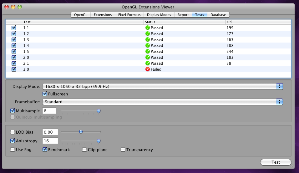

Mauley Posted July 30, 2010 Share Posted July 30, 2010 Hey guys, i would like to contribute as well. Here are my benchmark results. Link to comment Share on other sites More sharing options...
