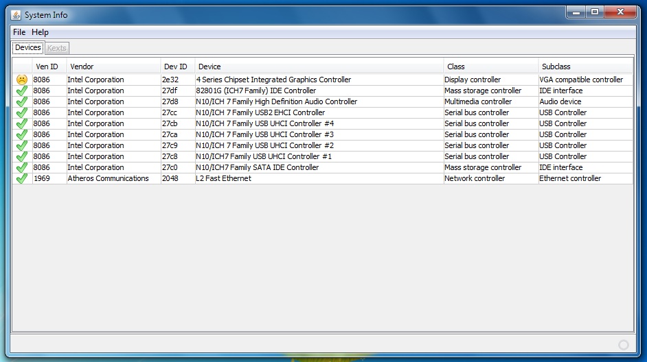

fbifido Posted July 16, 2010 Share Posted July 16, 2010 Use DSDT Editor -> DSL -> Extract from system i have win7 ultimate with bios mod dell slic 2.1 System info only video card may have problem 8086:2e32 it's the same as 8086:2a43 cpu_z_info.txt cpu_z_info.html ecs_g41t_m_dsdt_with_dell_slic21.zip Link to comment https://www.insanelymac.com/forum/topic/223205-dsdt-editor-and-patcher/page/5/#findComment-1512587 Share on other sites More sharing options...

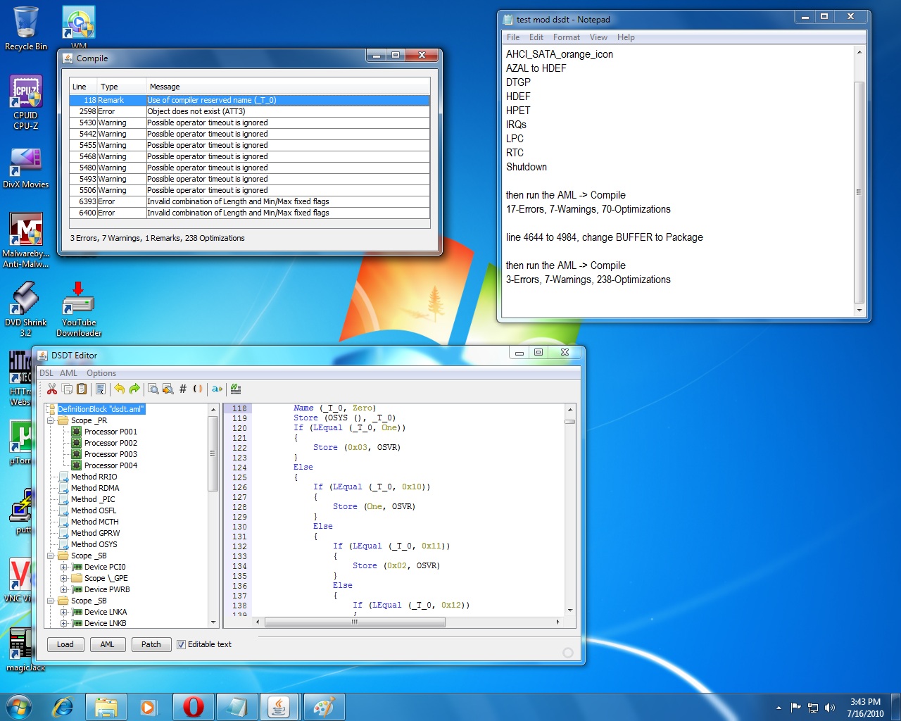

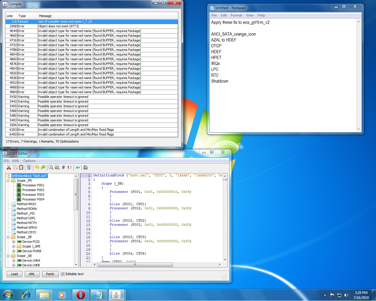

fbifido Posted July 16, 2010 Share Posted July 16, 2010 Apply these fix to ecs_g41t-m_v2: AHCI_SATA_orange_icon AZAL to HDEF DTGP HDEF HPET IRQs LPC RTC Shutdown then run the AML -> Compile 17-Errors, 7-Warnings, 70-Optimizations step1.jpg line 4644 to 4984, change BUFFER to Package then run the AML -> Compile 3-Errors, 7-Warnings, 238-Optimizations step2.jpg How do i fix the rest? Link to comment https://www.insanelymac.com/forum/topic/223205-dsdt-editor-and-patcher/page/5/#findComment-1512630 Share on other sites More sharing options...
oldnapalm Posted July 16, 2010 Author Share Posted July 16, 2010 Don't apply the HPET fix, it won't work on your mobo. Try this patch for SpeedStep 14_states__P001_4.txt I got the P-states from this post http://www.insanelymac.com/forum/index.php...t&p=1404740 If it's not the same CPU, use PStateChanger to get the P-states. Link to comment https://www.insanelymac.com/forum/topic/223205-dsdt-editor-and-patcher/page/5/#findComment-1512642 Share on other sites More sharing options...

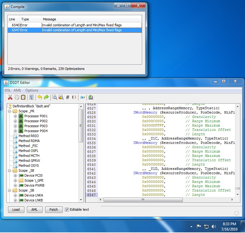

fbifido Posted July 17, 2010 Share Posted July 17, 2010 Apply these fix to ecs_g41t-m_v2: AHCI_SATA_orange_icon AZAL to HDEF DTGP HDEF HPET_IRQs IRQs LPC RTC Shutdown 14_states__P001_4 then run the AML -> Compile 2-Errors, 0-Warnings, 239-Optimizations step3.jpg test5.zip Link to comment https://www.insanelymac.com/forum/topic/223205-dsdt-editor-and-patcher/page/5/#findComment-1512754 Share on other sites More sharing options...
oldnapalm Posted July 17, 2010 Author Share Posted July 17, 2010 I think it's an issue with the Windows iASL, under Mac OS it compiles fine ASL Input: test5.dsl - 6729 lines, 235406 bytes, 2957 keywords AML Output: dsdt.aml - 25307 bytes, 852 named objects, 2105 executable opcodes Compilation complete. 0 Errors, 0 Warnings, 0 Remarks, 239 Optimizations Link to comment https://www.insanelymac.com/forum/topic/223205-dsdt-editor-and-patcher/page/5/#findComment-1512758 Share on other sites More sharing options...
fbifido Posted July 17, 2010 Share Posted July 17, 2010 Windows 7 ULTIMATE x64 Intel ACPI Component Architecture ASL Optimizing Compiler version 20100528 [May 28 2010] Copyright © 2000 - 2010 Intel Corporation Supports ACPI Specification Revision 4.0a Usage: iasl [Options] [Files] Link to comment https://www.insanelymac.com/forum/topic/223205-dsdt-editor-and-patcher/page/5/#findComment-1512765 Share on other sites More sharing options...
kizwan Posted July 17, 2010 Share Posted July 17, 2010 then run the AML -> Compile2-Errors, 0-Warnings, 239-Optimizations step3.jpg This is easy to fix. Correct the "Length" value with this formula using calculator set to programming mode (HEX):- Length = Range Maximum - Range Minimum + 1 Newer IASL (ver 4.0a) detect this error. Link to comment https://www.insanelymac.com/forum/topic/223205-dsdt-editor-and-patcher/page/5/#findComment-1512779 Share on other sites More sharing options...
fbifido Posted July 17, 2010 Share Posted July 17, 2010 It works Length = Range Maximum - Range Minimum + 1 Length = ( 0x00000000 - 0x00000000 ) + 1 Length = 1 Link to comment https://www.insanelymac.com/forum/topic/223205-dsdt-editor-and-patcher/page/5/#findComment-1512785 Share on other sites More sharing options...

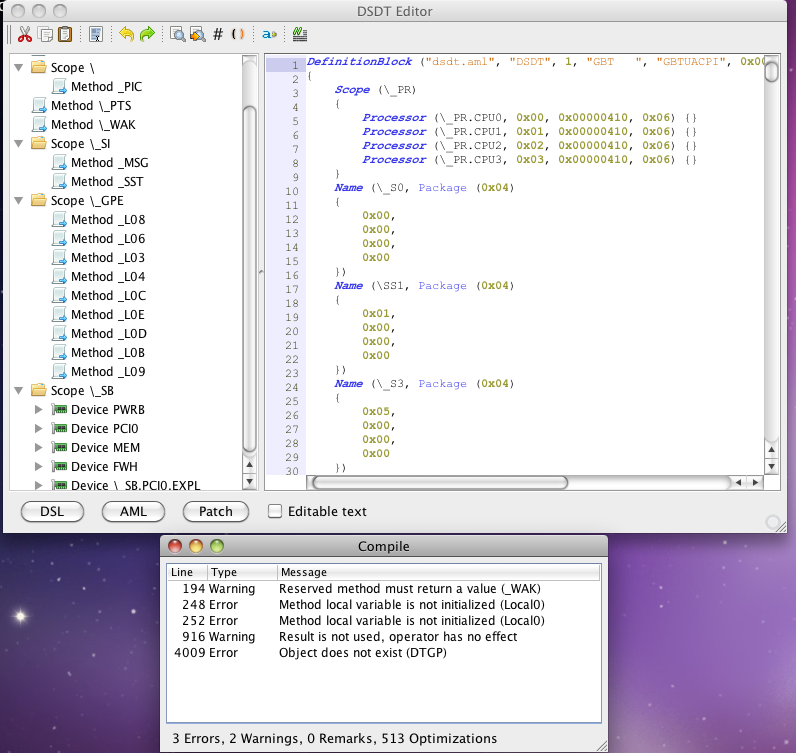

macusers Posted July 18, 2010 Share Posted July 18, 2010 Gentlemen, I need some help from your expertise, i try to patch my ALC883 on borad audio with the provide insert text file, but i get a couple errors, please see the attach screen shot plus my dsdt which was extracted from my system. Thank you in advance. dsdt.zip Link to comment https://www.insanelymac.com/forum/topic/223205-dsdt-editor-and-patcher/page/5/#findComment-1513857 Share on other sites More sharing options...

macusers Posted July 19, 2010 Share Posted July 19, 2010 @macusers: apply the DTGP patch, and in lines 248 and 252, you can remove the line, or replace Store (Local0, Local0) by Store ("Local0", Local0) Thanks, I will give that a try. Link to comment https://www.insanelymac.com/forum/topic/223205-dsdt-editor-and-patcher/page/5/#findComment-1514004 Share on other sites More sharing options...
kizwan Posted July 19, 2010 Share Posted July 19, 2010 Thanks, I will give that a try. You might want to try change this:- Store (Local0, Local0) to Store (Local0, Local0, Local0) This form will store result of operator back to Local0, probable intention of the statement. Link to comment https://www.insanelymac.com/forum/topic/223205-dsdt-editor-and-patcher/page/5/#findComment-1514012 Share on other sites More sharing options...
