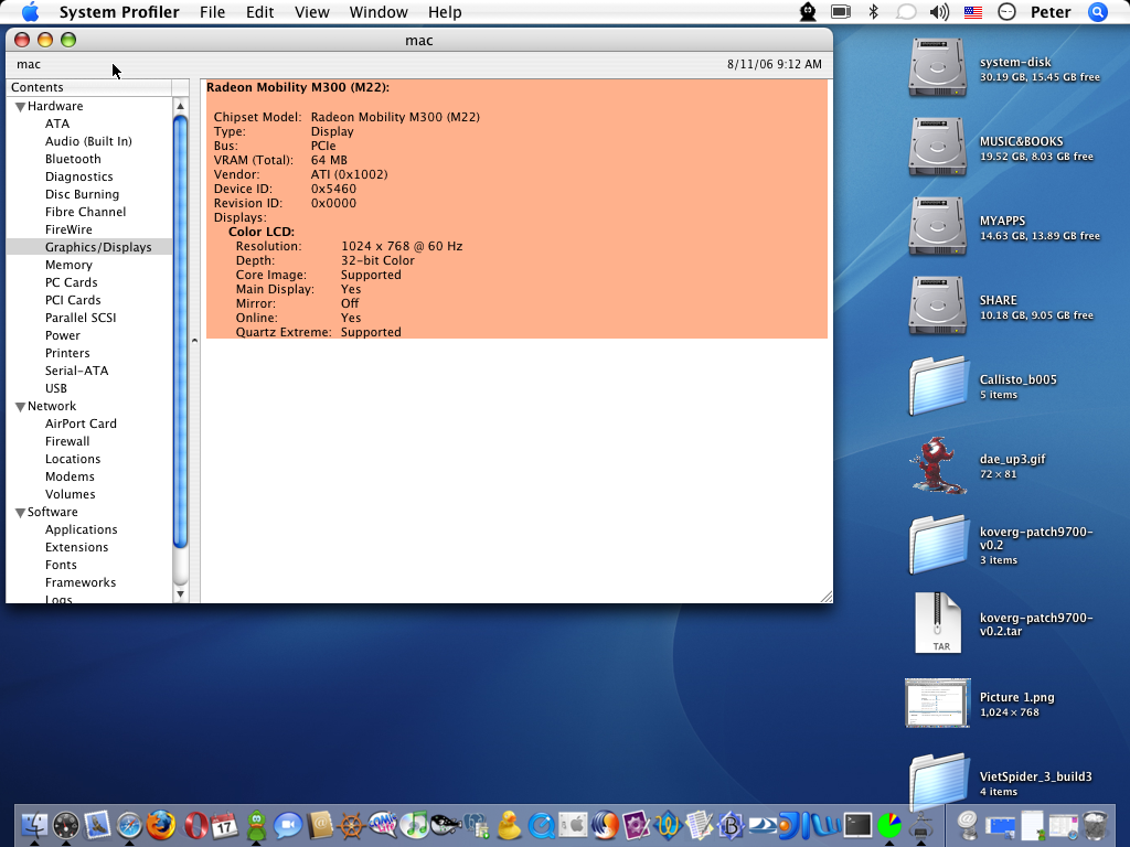

maweiba Posted August 11, 2006 Share Posted August 11, 2006 My M300 works well now,Thanks Link to comment https://www.insanelymac.com/forum/topic/22215-howto-mobility-x300-qecl-w-widescreen/#findComment-160967 Share on other sites More sharing options...

neon_eddy Posted August 12, 2006 Share Posted August 12, 2006 I have it working on my laptop .. 1920x1200!!!!! the step Iwas always missing was adding in my monitor 128bit hex number from the callisto drivers. Link to comment https://www.insanelymac.com/forum/topic/22215-howto-mobility-x300-qecl-w-widescreen/#findComment-162096 Share on other sites More sharing options...
