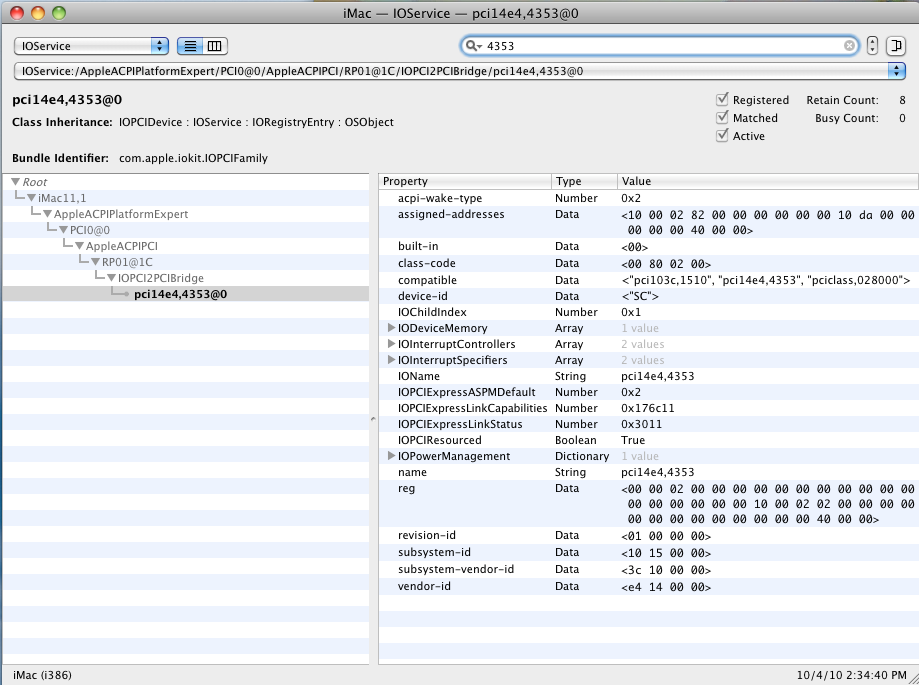

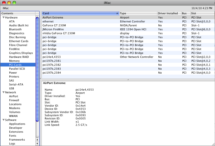

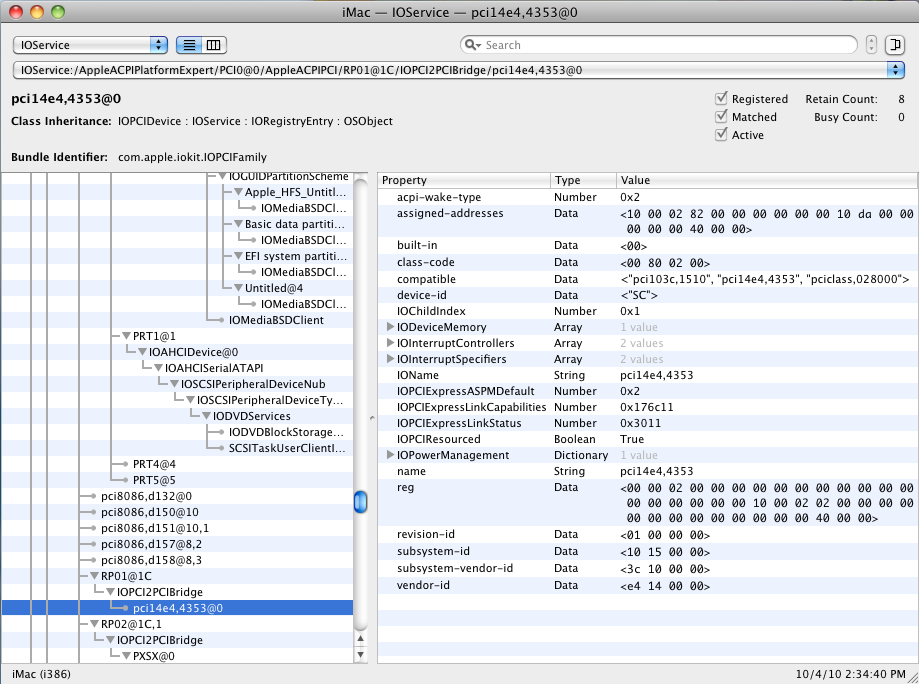

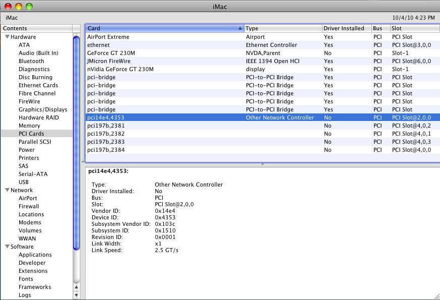

juanerson Posted October 4, 2010 Share Posted October 4, 2010 @yehia Amer, Hi, if you have using a DSDT, maybe your problem coming from there, because in your captures: one (PCI cards) appear the wlan attached to pci slot 2, and in IOReg capture (the most reliable for me) appear RP01 (slot 1)... I think can be fixed from DSDT way, by injecting it on the proper address and deleting the pci wrong/unnecessary (SUN) part, which would have to be "AirPort" slot name (genuine MacBook since late 2007 models)... So, upload your dsdt, I will take a look. Link to comment https://www.insanelymac.com/forum/topic/221653-guide-hp-dv8-dv7-dv6-dv5-1064-easy-comprehensive-installation/page/16/#findComment-1558785 Share on other sites More sharing options...
yehia2amer Posted October 4, 2010 Share Posted October 4, 2010 @yehia Amer, Hi, if you have using a DSDT, maybe your problem coming from there, because in your captures: one (PCI cards) appear the wlan attached to pci slot 2, and in IOReg capture (the most reliable for me) appear RP01 (slot 1)... I think can be fixed from DSDT way, by injecting it on the proper address and deleting the pci wrong/unnecessary (SUN) part, which would have to be "AirPort" slot name (genuine MacBook since late 2007 models)... So, upload your dsdt, I will take a look. thanks for your help , i think you are right because i tried to play with my dsdt from a week ago to fix this problem and now the card appears twice as "AirPort Extreme", but it don't work and as "other Network Controller" those are the ioreg screen shots and the ioreg.rtf if you need it ioreg.rtf finally my DSDT dsdt.aml.zip and thanks again for your help Link to comment https://www.insanelymac.com/forum/topic/221653-guide-hp-dv8-dv7-dv6-dv5-1064-easy-comprehensive-installation/page/16/#findComment-1558906 Share on other sites More sharing options...
juanerson Posted October 4, 2010 Share Posted October 4, 2010 thanks for your help , i think you are right because i tried to play with my dsdt from a week ago to fix this problem and now the card appears twice as "AirPort Extreme", but it don't work... and as "other Network Controller" ... those are the ioreg screen shots and the ioreg.rtf if you need it ... finally my DSDT ... and thanks again for your help You can try the attached... I think should works. But please consider that AirPort Extreme its just cosmetic on PCI section (system profile). I commented out those parts on your dsdt. Is NOT cosmetic if appear on Network -- (AirPort) part as Extreme card (rebranding). In fact, real macbook (since late 2007) AirPort not appear as PCI Cards..., but appear on Ethernet Cards as "other Network Controller" or "AirPort" (dsdt). So, if you want to recognize as real (Apple genuine) Extreme, then you need to rebrand your card, which is the procedure mentioned in current topic. The rest of dsdt hacks are unnecessaries apply to your broadcom (pci14e4,4353) which is native (not including Apple "subsystem-id" and "subsystem-vendor-id" of course). Notes: If you want to know what I did, look the .dsl for reference. Also, maybe its necessary to add/activate (+ button) manually the AirPort interface on System Preferences -- Network. Good Luck. Link to comment https://www.insanelymac.com/forum/topic/221653-guide-hp-dv8-dv7-dv6-dv5-1064-easy-comprehensive-installation/page/16/#findComment-1559107 Share on other sites More sharing options...
yehia2amer Posted October 5, 2010 Share Posted October 5, 2010 You can try the attached... I think should works. But please consider that AirPort Extreme its just cosmetic on PCI section (system profile). I commented out those parts on your dsdt. Is NOT cosmetic if appear on Network -- (AirPort) part as Extreme card (rebranding). In fact, real macbook (since late 2007) AirPort not appear as PCI Cards..., but appear on Ethernet Cards as "other Network Controller" or "AirPort" (dsdt). So, if you want to recognize as real (Apple genuine) Extreme, then you need to rebrand your card, which is the procedure mentioned in current topic. The rest of dsdt hacks are unnecessaries apply to your broadcom (pci14e4,4353) which is native (not including Apple "subsystem-id" and "subsystem-vendor-id" of course). Notes: If you want to know what I did, look the .dsl for reference. Also, maybe its necessary to add/activate (+ button) manually the AirPort interface on System Preferences -- Network. Good Luck. i didn't work Although the card is detected on the the ioreg and the AppleAirPortBrcm43224.kext is loaded , it is not detected on system info or on System Preferences at all not even showed as before what do you think the problem is ? ioreg_after_dsdt_fix.rtf i tried to rebrand my card but at this step , ubuntu does not see my wireless card , so i don't know what to do !!!!!!! Once everything is ready , now here comes the crucial part , type SSB_SPROM=$(find /sys/devices -name ssb_sprom) and then followed by echo $SSB_SPROM If you see something like /sys/device/pci/<numbers>/ssb_sprom. Then you’re in luck. But when you type echo $SSB_SPROM and you get nothing. You should stop now as ubuntu does not see your wireless card. However if you see more then 1 entry , you should consider reading this also if i rebrand my card , do i have to add it to my hp bios white list ???? Link to comment https://www.insanelymac.com/forum/topic/221653-guide-hp-dv8-dv7-dv6-dv5-1064-easy-comprehensive-installation/page/16/#findComment-1559224 Share on other sites More sharing options...
