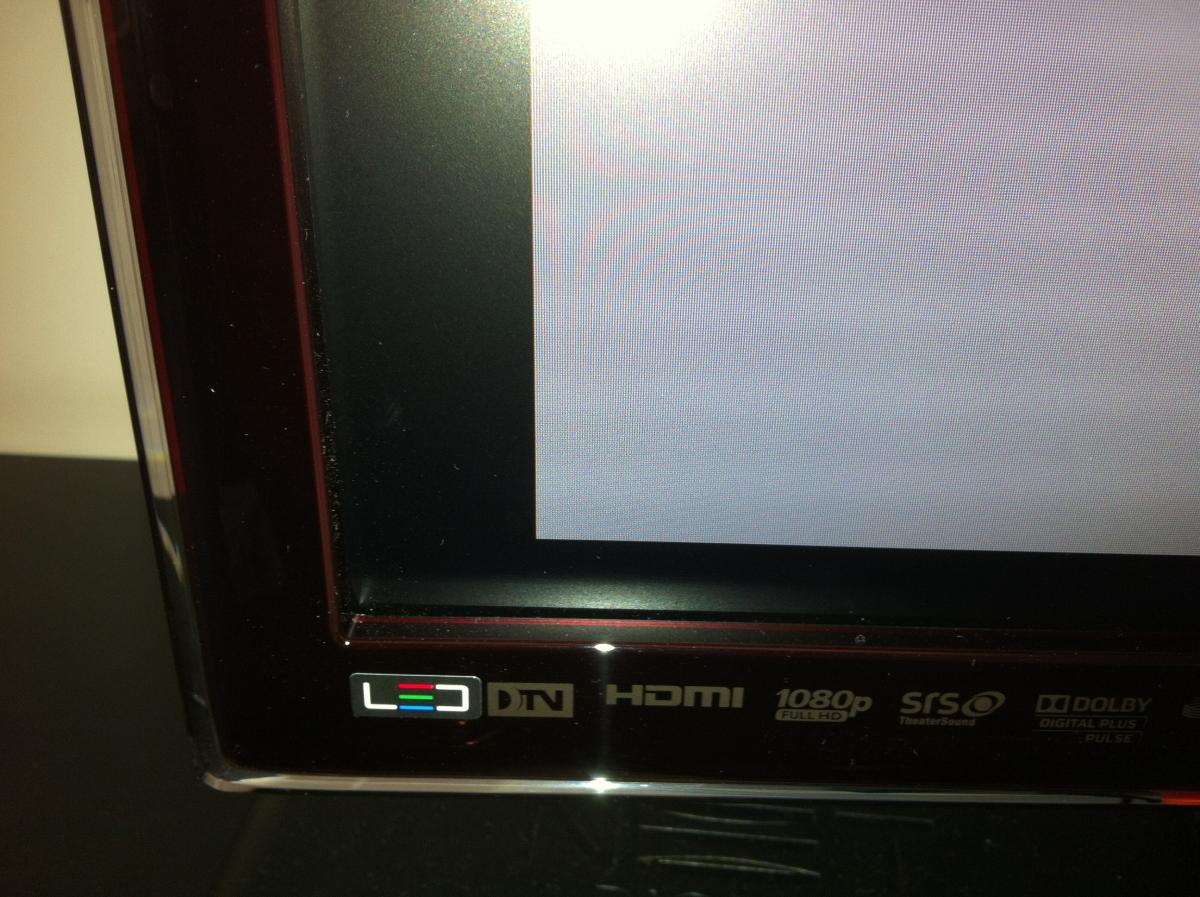

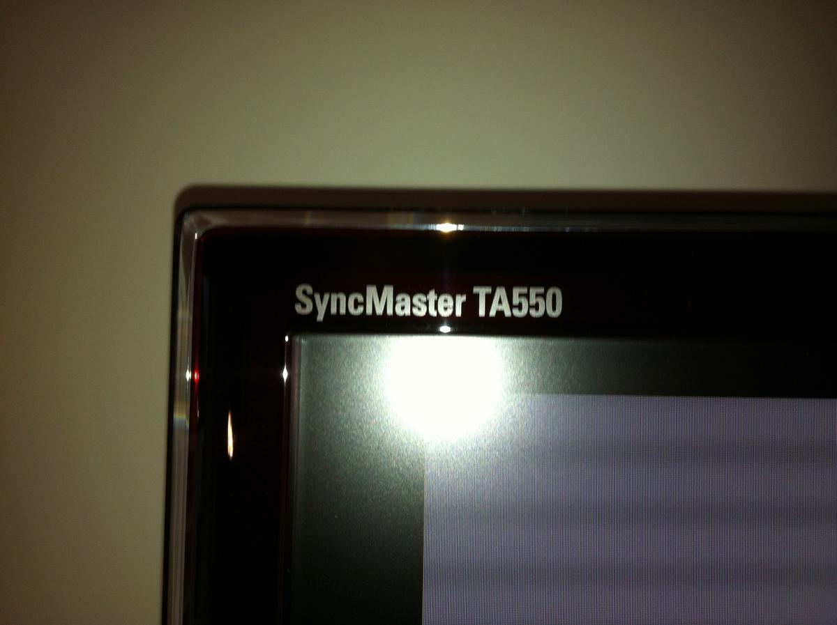

langweiler94 Posted December 9, 2011 Share Posted December 9, 2011 Thanks to dublove i was finally able to hard flash my MSi ATi HD 5870, i can get now 1920 x 1080, but i still have those 1 inch thick, awful borders. Does anyone know, how to remove them? Link to comment https://www.insanelymac.com/forum/topic/211294-information-on-vesa-modes-in-atinvidia-bios/page/7/#findComment-1776964 Share on other sites More sharing options...

Guilherme Araújo Posted January 27, 2012 Share Posted January 27, 2012 Thanks to dublove i was finally able to hard flash my MSi ATi HD 5870, i can get now 1920 x 1080, but i still have those 1 inch thick, awful borders. Does anyone know, how to remove them? I have the same problem, with an HD 4850. I noticed the resolution did change, because during boot there were some lines that wouldn't fit in one line and now it does. Besides, in case of any problem with my monitor, I believe it would be safer to have 800x600 mode. I guess it'd be better to replace another "less useful" resolution, perhaps 1152x864. How can I do that? Edit: another reason, look what happened to my BIOS screen (previously, it was fullscreen, almost full, with the same black borders). Edit2: I managed to replace 1600x1200 with 1920x1080, so BIOS went back to normal, but I still have those borders. Link to comment https://www.insanelymac.com/forum/topic/211294-information-on-vesa-modes-in-atinvidia-bios/page/7/#findComment-1790157 Share on other sites More sharing options...

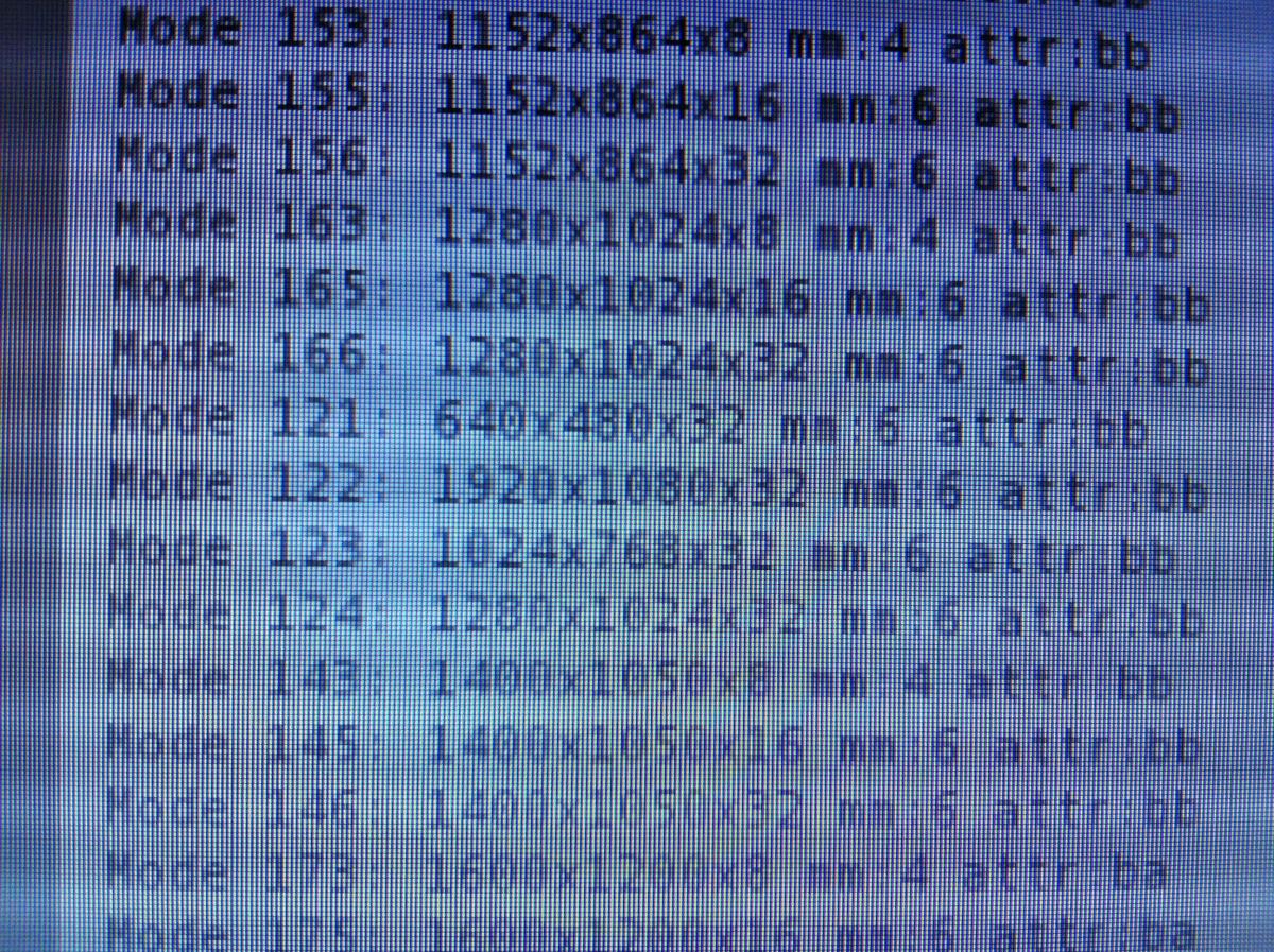

aylamrin Posted January 28, 2012 Share Posted January 28, 2012 Well Guilherme, I don't know if DieBuche is still around. But it looks like that we are yet to find someone who could post screenshots of Chameleon boot screen which does not have the blackborders. Since you claimed that you were able to change the resolution, did you also try to set the resolution in the theme.plist file in your theme folder? Link to comment https://www.insanelymac.com/forum/topic/211294-information-on-vesa-modes-in-atinvidia-bios/page/7/#findComment-1790430 Share on other sites More sharing options...

Guilherme Araújo Posted January 28, 2012 Share Posted January 28, 2012 Well Guilherme, I don't know if DieBuche is still around. But it looks like that we are yet to find someone who could post screenshots of Chameleon boot screen which does not have the blackborders. Since you claimed that you were able to change the resolution, did you also try to set the resolution in the theme.plist file in your theme folder? Yes, I changed the theme size as well. I believe it might be a BIOS limitation, because the BIOS screen and POST screen have the same borders, even before loading anything of any OS. Interesting to note, when I shut OS X down, there are a few lines on a black screen, but this time they fit the whole screen. Link to comment https://www.insanelymac.com/forum/topic/211294-information-on-vesa-modes-in-atinvidia-bios/page/7/#findComment-1790492 Share on other sites More sharing options...
