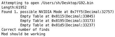

Dr. C Posted February 24, 2010 Share Posted February 24, 2010 I did the flash for 1920x1080 - without success. No problems so far booting 10.6.2, but still Chameleon displays 1280x1024x32 max. Some extra infos: Attempting to open G73.bin Length:65024 Found 1. possible NVIDIA Mode at 0x97af(Decimal:38831) Empty Table at 0x98ef(Decimal:39151) Empty Table at 0x990f(Decimal:39183) Empty Table at 0x994f(Decimal:39247) Empty Table at 0x996f(Decimal:39279) Empty Table at 0x998f(Decimal:39311) Correct number of finds Mod should be working I attached the before and after from Hex Fiend. My GPU is a Gigabyte 7600GT. Before: After: Thanks Dr. C Link to comment https://www.insanelymac.com/forum/topic/211294-information-on-vesa-modes-in-atinvidia-bios/page/2/#findComment-1417052 Share on other sites More sharing options...
DieBuche Posted February 24, 2010 Author Share Posted February 24, 2010 @eberts That's a bummer; your offsets et al. are fine. To be honest, i can't see why it doesn't work. We just copied a mode which is working on an 8800GT? Im probably gonna get a cheap used nvidia to try... Link to comment https://www.insanelymac.com/forum/topic/211294-information-on-vesa-modes-in-atinvidia-bios/page/2/#findComment-1417096 Share on other sites More sharing options...

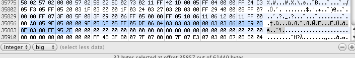

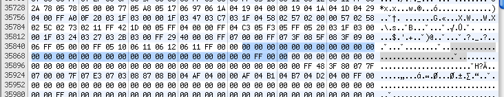

DieBuche Posted February 25, 2010 Author Share Posted February 25, 2010 You copied it to the wrong offset See the pic. If u attach the rom, ill patch it.. or make sure u click into the hex view before you jump to the offset, so that you get that flashing cursor to point you to the right place Buche, do you have any idea what could be the problem with the 1920x1080 resolution? I have nothing like the previous mentioned video swap in my dsdt, so I`m hoping for your input Thanks Dr. C Thats great news! Confirmed working at 1920x1200 on an Asus HD5870! This is only to add more resolutions, if your display is working Notebooks are much more tricky&I got little expirecnce on them... is there any chance to help vaio user to have internal screen enabled Link to comment https://www.insanelymac.com/forum/topic/211294-information-on-vesa-modes-in-atinvidia-bios/page/2/#findComment-1417687 Share on other sites More sharing options...
Dr. C Posted February 25, 2010 Share Posted February 25, 2010 Hey Buche, thanks again for your help. Here is my second try - the same result, nothing went bad, but no success either. I`ve included the original ROM, just in case I did it wrong again Thanks for looking into it, Dr. C G73_ROMs.zip Link to comment https://www.insanelymac.com/forum/topic/211294-information-on-vesa-modes-in-atinvidia-bios/page/2/#findComment-1418110 Share on other sites More sharing options...

shishank Posted March 6, 2010 Share Posted March 6, 2010 Hi DieBuche Can you patch my BIOS My card is nVidia 9800GT My Display Res is 1920*1080 G92.bin.zip Link to comment https://www.insanelymac.com/forum/topic/211294-information-on-vesa-modes-in-atinvidia-bios/page/2/#findComment-1424010 Share on other sites More sharing options...
