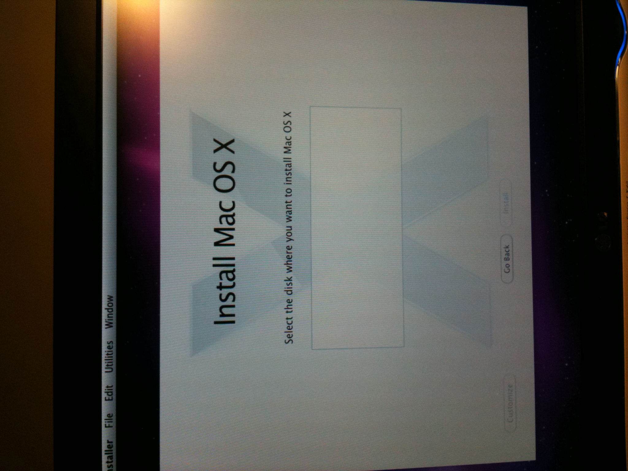

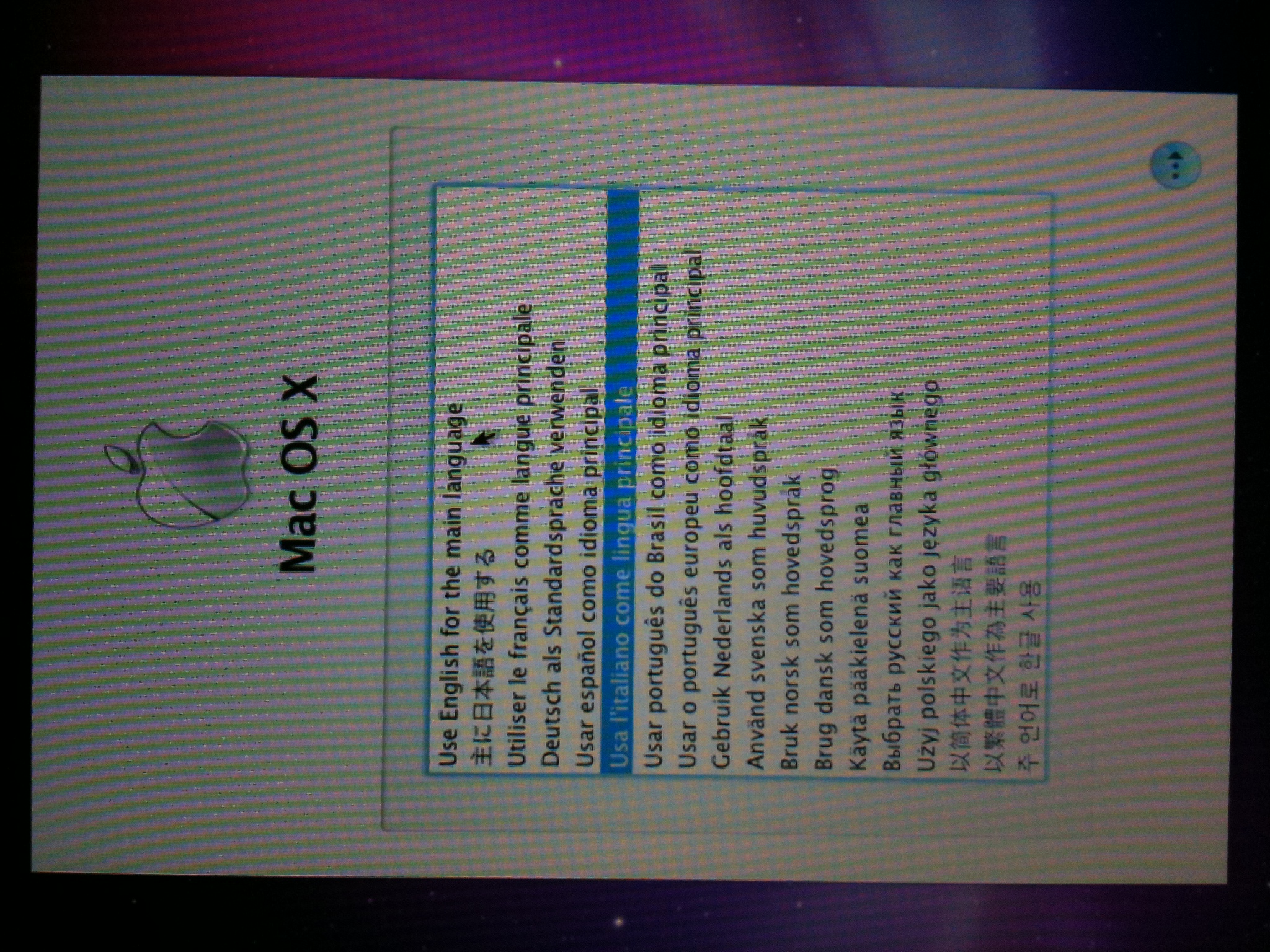

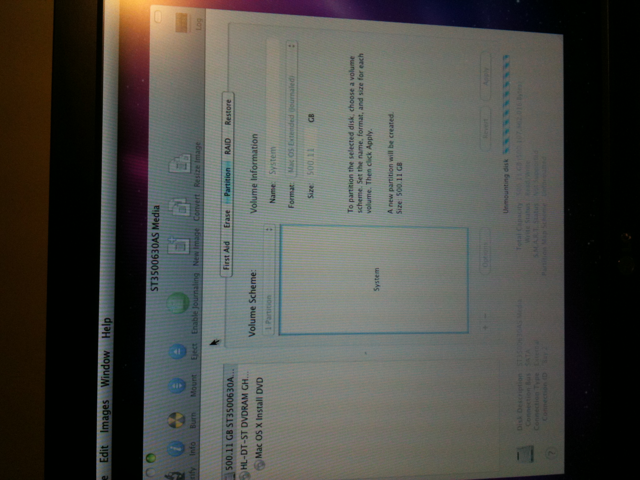

Maybe I'm not been clear ...
After chameleon I start the S/L retail DVD and I have the first screen where i choose the language and next ;
After agree the T&C if I select next S/L ask me in witch disk I would install but, if I don't use disk utility, I will see nothing in the disk list so I need to use this utility;
but
disk utility doesn't format or partition my disk.
This is my problem ....
Sorry for image but I don't know why :)
Any help ?

EDIT: formattato il disco con gparted live alla schermata di selezione della partizione in cui installare carica all'infinito e disk utiliti uguale ...
Provo un'altro disco.
Anche secondo disco niente da fare ...

This is most unusual, your disk recognised & formatted with Linux but still not recognised by disk utility ??? :)
The only other thing's I can think off that may cause this is if the Bios is not set to AHCI or a faulty SATA cable.
If not already can you update to latest Bios & then reset as in first post. Make sure H/D SATA connected to 1st SATA
outlet on MOBO & DVD to 2nd then try again..
If that fails & nobody has any more suggestions, can you get use of a working Mac & an external H/D to USB cable,
connector or case ? With these it is possible to load OSX & dgobe's installer direct to the H/D (if it is then recognised).
More on that later if you have too. :)

I have already the latest bios (1003), i tried to reset the bios and retype all the settings as in the guide...
Now i try another cable and put hd on sata1 and dvd on sata2 ...
Olllé !!
Incredible ... It was the sata cable or sata position or HD ... (I tried to change all :-) )
Now I have OSX :-) with some problem ...
I don't have ethernet (I have already execute "sudo ..." but nothing,
Every boot i have tu use the boot cd and prompt "GraphicEnabler=n" because i nedd to install gt220 driver ...
In each case it doesn't reboot or shutdown or bootup automatically but first i need internet and graphic !!
Any idea ?

That's excellent, did you remember to go through post install process, install P6TDeluxeV2Installer.pkg & use
terminal to touch /System/Library/Extensions. "OSX86 Tools" & "Kext Utilllity" applications (Google them) will
be your friends if you need to add extra kexts etc.

My only last question is why my seagate 500 doesn't work whit mac but run perfectly on win ...

When I purchased my Unibody MBP I also purchased separately a 500G Seagate H/D. All S/L & updates installed
on this ok. Then I received (via apple update) a firmware upgrade that was to "improve stability for 500G H/D's".
After this was installed my MBP failed to start (Blue screen only). Apple solution was for me to bye a new Logic board &
not update firmware or change H/D until they found a solution. They promised to notify me as soon as a solution found
(that was 12mth's ago) & still no news. That said I put the drive in my daughters 1.83 MBP, there was no firmware
update offered from apple & the drive continues to work fine.
With my limited understanding technically of getting S/L to run on PC's I guess the relevance here is that 'maybe' there is something in fakeSMC that does not like/or triggers compatibility issues with the seagate 500g drive & S/L.
If you are curious maybe you could one day have a play swapping around fakeSMC's that are known to work with our MOBO to see if any work. If you do please report findings. dgobe iFabio or @@Smith may know all these version's if you ask to make this test easier for you.
Please anybody feel free to shoot me down in flames here, this is only a guess based on my experience
and limited knowledge..
