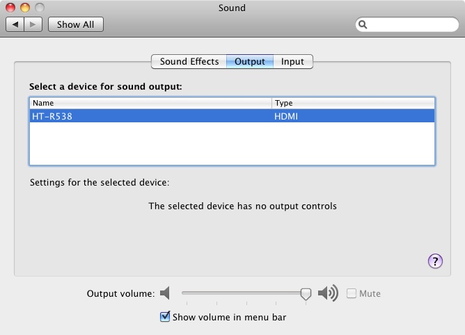

VCH888 Posted February 6, 2011 Share Posted February 6, 2011 Is there HDMI sound working for HD 5770? My Sapphire HD5770's HDMI audio is working and I must add some lines in DSDT. Device (PEGP) { Name (_ADR, 0x00010000) Device (GFX0) { Name (_ADR, Zero) Method (_DSM, 4, NotSerialized) { Store (Package (0x02) { "hda-gfx", Buffer (0x0A) { "onboard-1" } }, Local0) DTGP (Arg0, Arg1, Arg2, Arg3, RefOf (Local0)) Return (Local0) } } Device (HDAU) { Name (_ADR, One) Method (_DSM, 4, NotSerialized) { Store (Package (0x02) { "hda-gfx", Buffer (0x0A) { "onboard-1" } }, Local0) DTGP (Arg0, Arg1, Arg2, Arg3, RefOf (Local0)) Return (Local0) } } } Link to comment https://www.insanelymac.com/forum/topic/205802-ati-hd-5770/page/43/#findComment-1635147 Share on other sites More sharing options...
jason761 Posted February 8, 2011 Share Posted February 8, 2011 My Sapphire HD5770's HDMI audio is working and I must add some lines in DSDT. Device (PEGP) { Name (_ADR, 0x00010000) Device (GFX0) { Name (_ADR, Zero) Method (_DSM, 4, NotSerialized) { Store (Package (0x02) { "hda-gfx", Buffer (0x0A) { "onboard-1" } }, Local0) DTGP (Arg0, Arg1, Arg2, Arg3, RefOf (Local0)) Return (Local0) } } Device (HDAU) { Name (_ADR, One) Method (_DSM, 4, NotSerialized) { Store (Package (0x02) { "hda-gfx", Buffer (0x0A) { "onboard-1" } }, Local0) DTGP (Arg0, Arg1, Arg2, Arg3, RefOf (Local0)) Return (Local0) } } } How do i add that to my DSDT? Link to comment https://www.insanelymac.com/forum/topic/205802-ati-hd-5770/page/43/#findComment-1636262 Share on other sites More sharing options...
