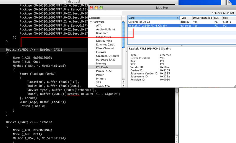

leslieking Posted April 11, 2010 Share Posted April 11, 2010 I switched to Chameleon, but there is one PCI card in system profiler. PCEFI shows two cards. I have a PCI Ethernet Controller and Chameleon doesn't show that. Screenshoot: http://bit.ly/9mDe2d Any idea, why? Link to comment https://www.insanelymac.com/forum/topic/201902-chameleon-rc4-is-out/page/40/#findComment-1446117 Share on other sites More sharing options...
THe KiNG Posted April 11, 2010 Share Posted April 11, 2010 I switched to Chameleon, but there is one PCI card in system profiler. PCEFI shows two cards.I have a PCI Ethernet Controller and Chameleon doesn't show that. Screenshoot: http://bit.ly/9mDe2d Any idea, why? B/c PCEFI code is wrong, built-in Ethernet card(soldered on board) shouldn't show up on PCI cards in system profiler. only those that use PCI/PCI express slot. Link to comment https://www.insanelymac.com/forum/topic/201902-chameleon-rc4-is-out/page/40/#findComment-1446383 Share on other sites More sharing options...
Detrich Posted April 11, 2010 Share Posted April 11, 2010 B/c PCEFI code is wrong, built-in Ethernet card(soldered on board) shouldn't show up on PCI cards in system profiler. only those that use PCI/PCI express slot. I think he talk about this ,so PCEFI is OK. Link to comment https://www.insanelymac.com/forum/topic/201902-chameleon-rc4-is-out/page/40/#findComment-1446450 Share on other sites More sharing options...
cparm Posted April 11, 2010 Share Posted April 11, 2010 B/c PCEFI code is wrong, built-in Ethernet card(soldered on board) shouldn't show up on PCI cards in system profiler. only those that use PCI/PCI express slot. humm, i don't know, i use a modded chameleon version and it also show my ethernet card in the pci section because i added a _sun entry in the (GIGE) section, if he use dsdt maybe he should look into it Link to comment https://www.insanelymac.com/forum/topic/201902-chameleon-rc4-is-out/page/40/#findComment-1446463 Share on other sites More sharing options...
leslieking Posted April 11, 2010 Share Posted April 11, 2010 B/c PCEFI code is wrong, built-in Ethernet card(soldered on board) I don't use built-in ethernet. I have a NetGear GA311M PCI LAN card. There is not GIGE section in DSDT. Link to comment https://www.insanelymac.com/forum/topic/201902-chameleon-rc4-is-out/page/40/#findComment-1446473 Share on other sites More sharing options...
THe KiNG Posted April 12, 2010 Share Posted April 12, 2010 Built-in cards shouldn't show up on PCI Cards under system profiler, adding _SUN for soldered stuff is so WRONG, then why to inject built-in code if is on pci/pcie slot? LOL If is about a PCI or PCIe card then things changes, it should show up on system profiler PCI section, but only if there is a _SUN added on DSDT to identify the slot number plus a check to see if the slot is empty or not(and not publish the pcibridge if empty), or booter can do the same if it can enumerate the slots correctly, most cases NOT(at least with actual code). Apple can give you a free exampe in his DSDT's... Link to comment https://www.insanelymac.com/forum/topic/201902-chameleon-rc4-is-out/page/40/#findComment-1446804 Share on other sites More sharing options...

leslieking Posted April 12, 2010 Share Posted April 12, 2010 The King is right! And zolik, cross posting is rude check your same post on VoodooProject forums. Calm down, dude. I just posted because I wanted a fast answer. No, I'm not a cross poster. It's not my habit. I made a mistake and sorry! Built-in cards shouldn't show up on PCI Cards under system profiler, adding _SUN for soldered stuff is so WRONG, then why to inject built-in code if is on pci/pcie slot? LOL If is about a PCI or PCIe card then things changes, it should show up on system profiler PCI section, but only if there is a _SUN added on DSDT to identify the slot number plus a check to see if the slot is empty or not(and not publish the pcibridge if empty), or booter can do the same if it can enumerate the slots correctly, most cases NOT(at least with actual code). Apple can give you a free exampe in his DSDT's... Thank you very much! Link to comment https://www.insanelymac.com/forum/topic/201902-chameleon-rc4-is-out/page/40/#findComment-1447012 Share on other sites More sharing options...

cparm Posted April 12, 2010 Share Posted April 12, 2010 Built-in cards shouldn't show up on PCI Cards under system profiler, adding _SUN for soldered stuff is so WRONG, then why to inject built-in code if is on pci/pcie slot? LOL only because it's possible to do Link to comment https://www.insanelymac.com/forum/topic/201902-chameleon-rc4-is-out/page/40/#findComment-1447185 Share on other sites More sharing options...

THe KiNG Posted April 13, 2010 Share Posted April 13, 2010 only because it's possible to do Adding _SUN on a built-in component kills the built-in feature, however you can still inject the built-in stuff but "apple" will see that component as external device and that is wrong...especial for network Link to comment https://www.insanelymac.com/forum/topic/201902-chameleon-rc4-is-out/page/40/#findComment-1447329 Share on other sites More sharing options...
leslieking Posted April 13, 2010 Share Posted April 13, 2010 Hello guys, I'm using Chameleon RC5 PreRelease 18 Build 112. I am using the restart fix and its great when it works but its a 50 50 chance that it works. Has anyone else experienced this? Thanks! D I'm using RC5 prerelease (trunk). I never had problems with restart. Adding _SUN on a built-in component kills the built-in feature, however you can still inject the built-in stuff but "apple" will see that component as external device and that is wrong...especial for network Is it better to avoid _SUN for the PCI LAN adater? Or do you mean just "on-board" stuff? I'm totally confused. Link to comment https://www.insanelymac.com/forum/topic/201902-chameleon-rc4-is-out/page/40/#findComment-1447395 Share on other sites More sharing options...
