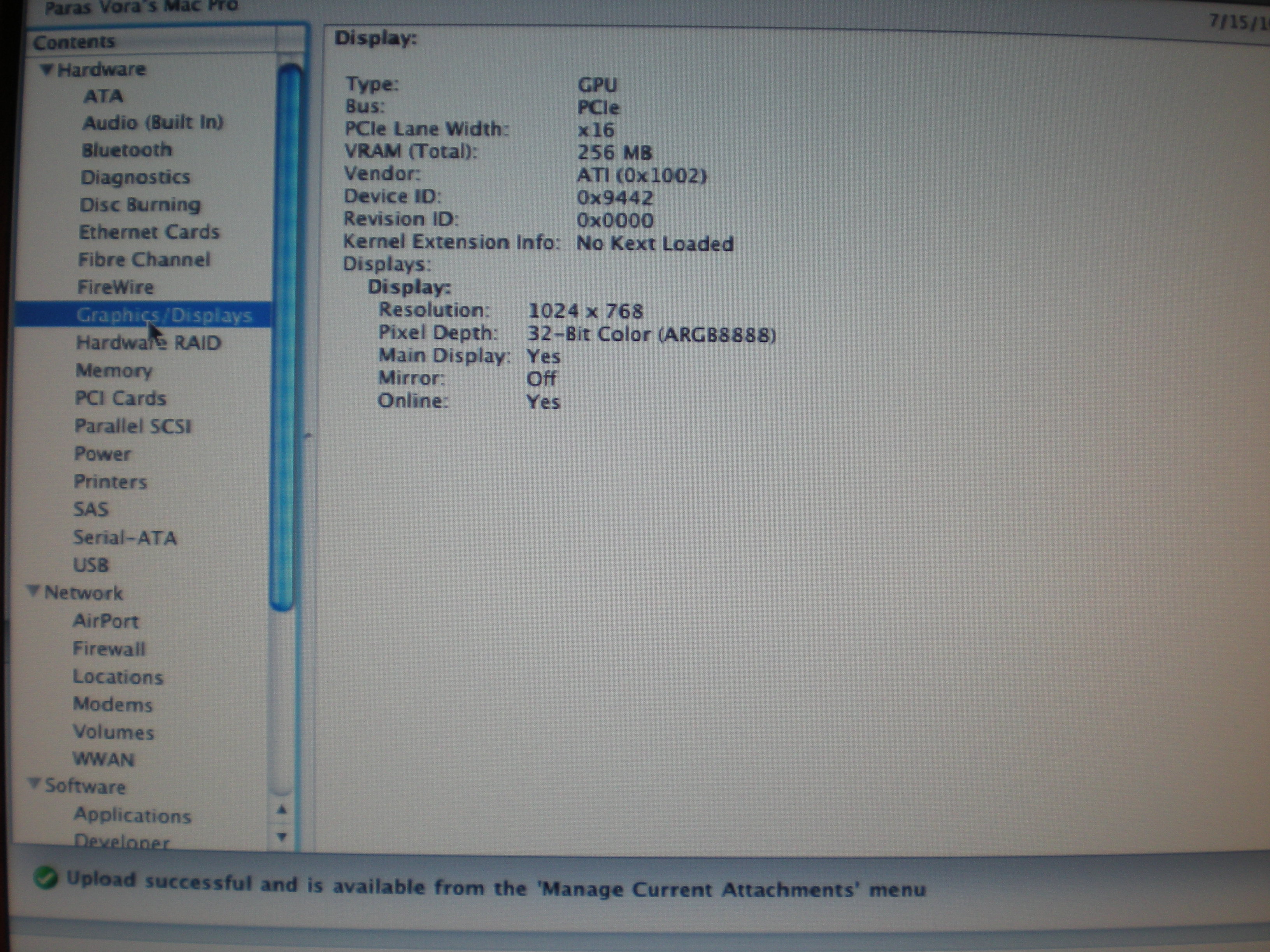

wesman Posted July 7, 2010 Share Posted July 7, 2010 http://www.insanelymac.com/forum/index.php?showtopic=161430 Tweak, thanks for all the help! My system now runs flawlessly for 10.6.0. Video card works great. Quartz is up and running. Sound is good. However, when I tried to update to 10.6.4, my video card stopped being recognized by the OS. It is labeled as GPU in the system profiler. Currently, my GeForce 7600 runs perfect without the use of EFI Strings or injections such as NVinject. It runs on the "internal" driver. My os is completely vanilla. No special kexts or anything. What do you reckon I should do to restore video functionality in version 6.4? Is there other info you need? Link to comment https://www.insanelymac.com/forum/topic/189052-asus-p6t-se-retail-snow-leopard-installation-guide-flashdrive-updated-jun-28/page/33/#findComment-1506215 Share on other sites More sharing options...
Mystroe Posted July 9, 2010 Share Posted July 9, 2010 in the p6t se essentials.zip there is a folder called "ready" (in \p6t se essentials\script files) with 3 files. move the files to the folder above (where also the smbios2.plist is) and run the boot prep-script again - worked for me Am having similar issue. System: p6tse i7 930, 2gb ram(4start) Anyway to solve this without a Mac? Link to comment https://www.insanelymac.com/forum/topic/189052-asus-p6t-se-retail-snow-leopard-installation-guide-flashdrive-updated-jun-28/page/33/#findComment-1507829 Share on other sites More sharing options...
wesman Posted July 10, 2010 Share Posted July 10, 2010 Tweak, thanks for all the help! My system now runs flawlessly for 10.6.0. Video card works great. Quartz is up and running. Sound is good. However, when I tried to update to 10.6.4, my video card stopped being recognized by the OS. It is labeled as GPU in the system profiler. Currently, my GeForce 7600 runs perfect without the use of EFI Strings or injections such as NVinject. It runs on the "internal" driver. My os is completely vanilla. No special kexts or anything. What do you reckon I should do to restore video functionality in version 6.4? Is there other info you need? Ok, problem solved. Just bought a new graphics card. Got a good deal on a gts 250 from newegg. Boots sl with no special kexts or efi strings or anything. It also plays crysis on ultra high. I am a happy nerd... Link to comment https://www.insanelymac.com/forum/topic/189052-asus-p6t-se-retail-snow-leopard-installation-guide-flashdrive-updated-jun-28/page/33/#findComment-1508601 Share on other sites More sharing options...

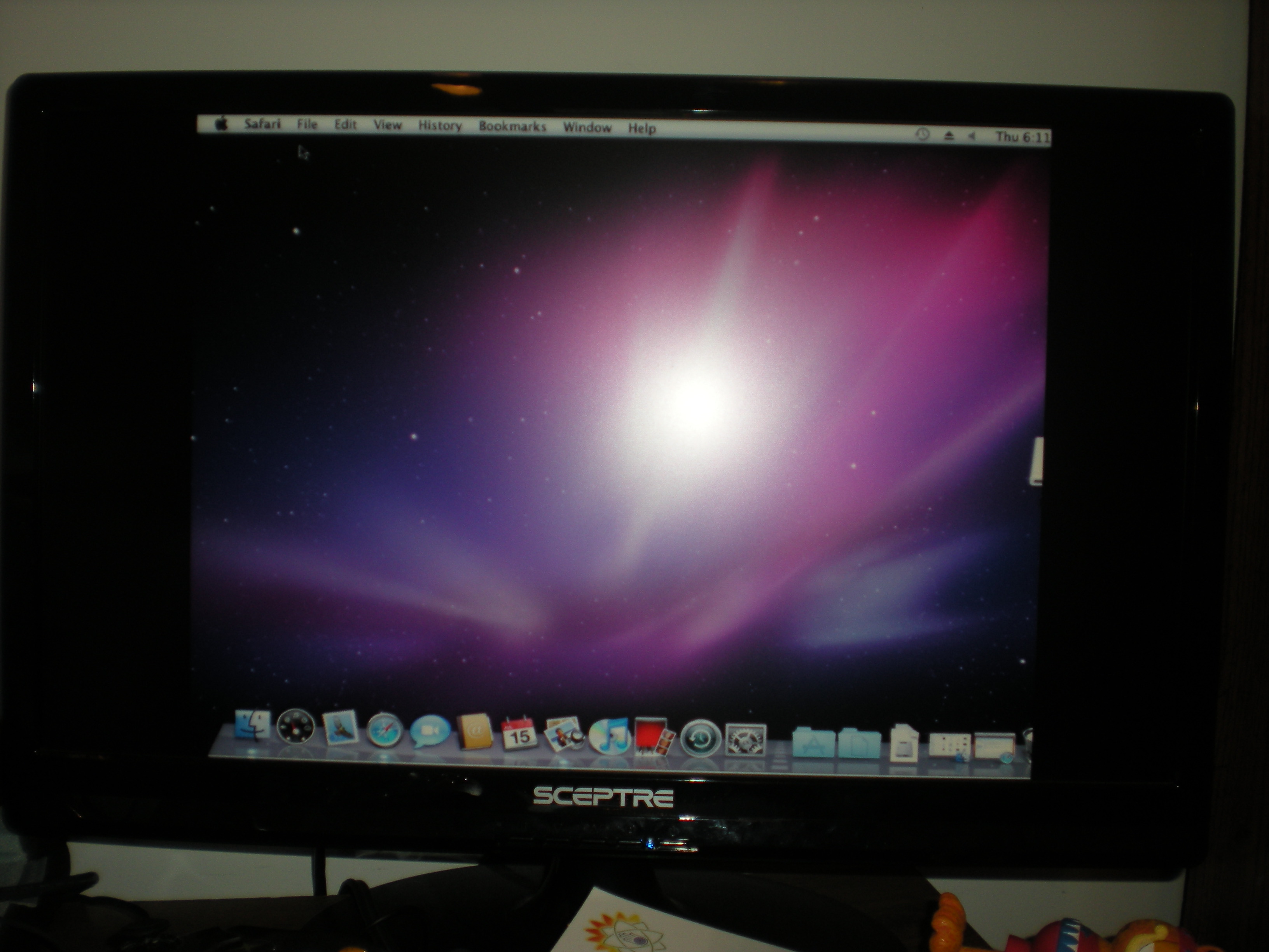

paravorheim Posted July 10, 2010 Share Posted July 10, 2010 So...I have a question. Again. After not having run SL on my pc for a while, I really want to so I can learn objective C for iPhone apps. Problem is, I also want to keep my windows installation when i reinstall through dual-booting on the same drive. What I was thinking was to make a complete image of my Windows drive, so that all the data stays intact. Will it still restore the image? Also, what should I do exactly to dual boot on the same drive? I haven't tried any of these suggestions here, but I would really like a complete explanation. Sorry if this sounds kind of stupid, but I really don't want any more problems. Link to comment https://www.insanelymac.com/forum/topic/189052-asus-p6t-se-retail-snow-leopard-installation-guide-flashdrive-updated-jun-28/page/33/#findComment-1508639 Share on other sites More sharing options...
paravorheim Posted July 11, 2010 Share Posted July 11, 2010 I don't know what I'm doing wrong, but I have a kernel panic every time I try and boot OS X after updating from 10.6.0 to 10.6.4. I'm pretty sure that my boot.plist and smbios.plist are correctly edited. I'm using pc efi 10 v6, no idea what dsdt. Can someone post a complete package of everything I need to be able to boot into os x correctly after this update? If not, I'll just try and reinstall from the beginning, no use in worrying about it for too long. Link to comment https://www.insanelymac.com/forum/topic/189052-asus-p6t-se-retail-snow-leopard-installation-guide-flashdrive-updated-jun-28/page/33/#findComment-1509268 Share on other sites More sharing options...

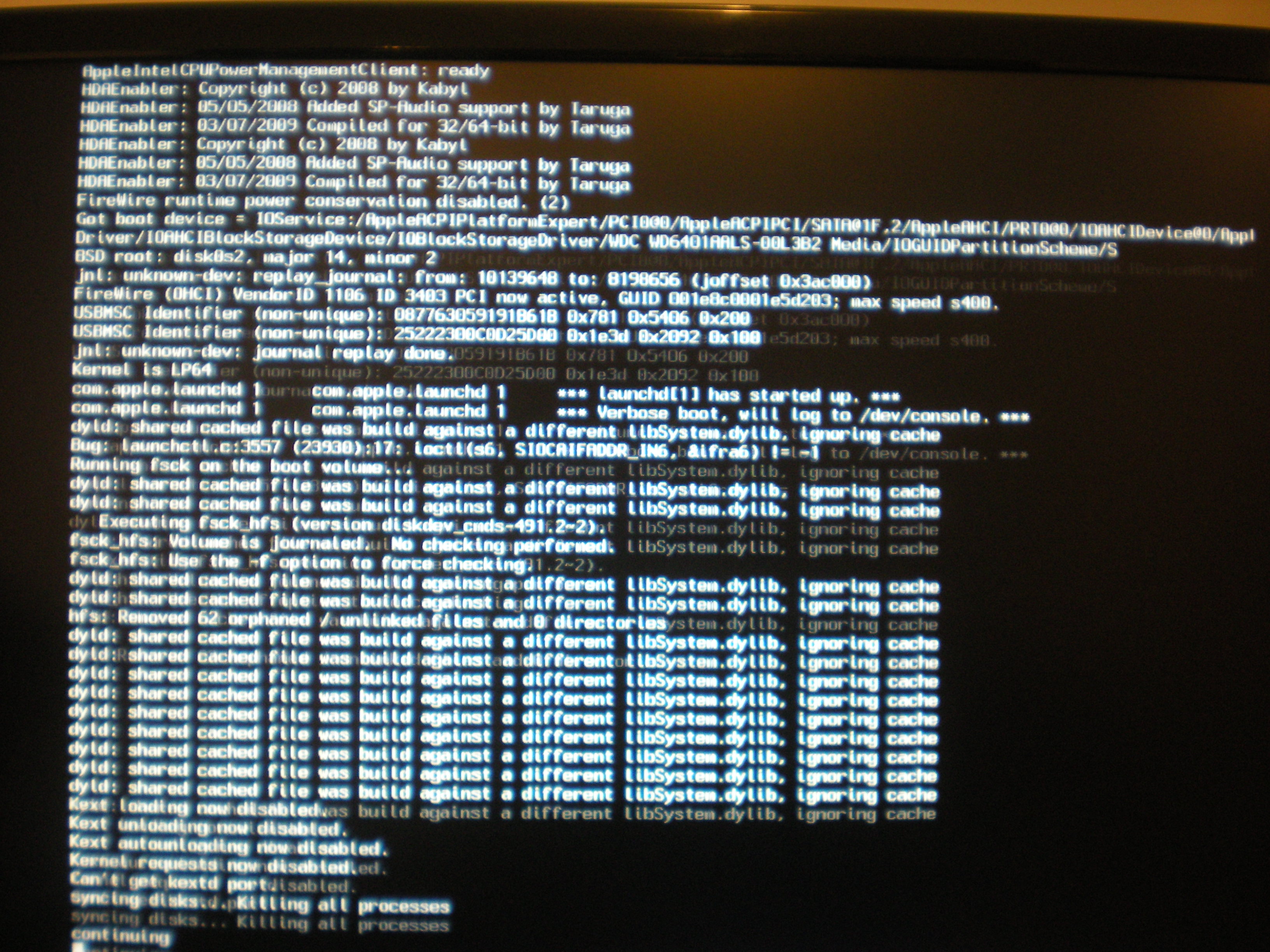

_Wolverine_ Posted July 12, 2010 Share Posted July 12, 2010 Guys the first time i boot my hack on the morning like 8am it boots but after a minute or so all coolers go to max speed and my screen turns black After a reboot everything is fine.... Any ideas? @paravorheim can you post a pic of the kp? and your smbios.plist and com.apple.boot.plist Link to comment https://www.insanelymac.com/forum/topic/189052-asus-p6t-se-retail-snow-leopard-installation-guide-flashdrive-updated-jun-28/page/33/#findComment-1509598 Share on other sites More sharing options...
paravorheim Posted July 14, 2010 Share Posted July 14, 2010 When I updated from 10.6 to 10.6.4, I downloaded it, and it installed, but when it asked me to reboot, I let it, since I already made the flash drive, it had a kernel panic while finishing installing the update. So, I turned my computer off, then turned it back on, and when I tried to boot into it using my bootable flash drive, it gave me this screen (attachments, JPG.). I'm including the contents of my bootable flash drive as well. Specs: p6t se ati radeon hd 4850 core i7 920 wd caviar black 640gb 6gb OCZ 1600 DDR3 Samsung sata dvd drive Thanks Archive.zip Link to comment https://www.insanelymac.com/forum/topic/189052-asus-p6t-se-retail-snow-leopard-installation-guide-flashdrive-updated-jun-28/page/33/#findComment-1511177 Share on other sites More sharing options...
_Wolverine_ Posted July 14, 2010 Share Posted July 14, 2010 1st remove extensions.mkext from /extra folder 2nd remove AppleHDA.kext and openhaltrestart.kext from /Extra/Extensions 3rd remove those uuid smuuid from com.apple.boot.plist and smbios.plist and remove the smbiosdefault from boot plist 4th reboot with -v -f and if it dont work post it back Link to comment https://www.insanelymac.com/forum/topic/189052-asus-p6t-se-retail-snow-leopard-installation-guide-flashdrive-updated-jun-28/page/33/#findComment-1511213 Share on other sites More sharing options...

paravorheim Posted July 15, 2010 Share Posted July 15, 2010 1st remove extensions.mkext from /extra folder2nd remove AppleHDA.kext and openhaltrestart.kext from /Extra/Extensions 3rd remove those uuid smuuid from com.apple.boot.plist and smbios.plist and remove the smbiosdefault from boot plist 4th reboot with -v -f and if it dont work post it back When you say to remove extensions.mkext, will I be remake this using kext utility? What do you mean by removing the uuid and smuuid and smbiosdefault? To literally remove the entire string? Thanks, I'll try it when I get home later today. Link to comment https://www.insanelymac.com/forum/topic/189052-asus-p6t-se-retail-snow-leopard-installation-guide-flashdrive-updated-jun-28/page/33/#findComment-1512015 Share on other sites More sharing options...
paravorheim Posted July 15, 2010 Share Posted July 15, 2010 1st remove extensions.mkext from /extra folder2nd remove AppleHDA.kext and openhaltrestart.kext from /Extra/Extensions 3rd remove those uuid smuuid from com.apple.boot.plist and smbios.plist and remove the smbiosdefault from boot plist 4th reboot with -v -f and if it dont work post it back I did what you said, or at least what I think you said, and believe it or not, it booted up! Problem is, sound doesn't work, display is at 1024x768 when it should be at 1920x1080, and I don't believe qe/ci is working. Here is a screenshot of the desktop itself, the info on the graphics, and my smbios and boot.plist. Thanks, Para Vorheim Archive.zip Link to comment https://www.insanelymac.com/forum/topic/189052-asus-p6t-se-retail-snow-leopard-installation-guide-flashdrive-updated-jun-28/page/33/#findComment-1512043 Share on other sites More sharing options...
