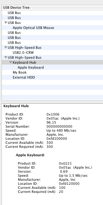

vol264 Posted February 4, 2010 Share Posted February 4, 2010 Hi MC, First to clear the issue from post #626. It was caused due to RAM speed settings. Sleep now works, also autosleep works without the autosleep script. What interests me now is what did you do to get wake from sleep with Apple Keyboard working. I use the latest Apple wired aluminum with numeric keypad. Wake with mouse did not work until I connected it directly to the backside USB port of the box. What can I do to recognize the keyboard so as the mouse is recognized when connected directly to the computer. Another thing I've noticed with the USB ports is that the NTFS is read only on USB drives but on my original MacBook is read/write. Checked the permissions but haven't got a clue what could be the problem. Regards, dsdt.rar Link to comment https://www.insanelymac.com/forum/topic/188920-master-chiefs-p5k-pro-acpi-warfare/page/32/#findComment-1403372 Share on other sites More sharing options...

Master Chief Posted February 4, 2010 Share Posted February 4, 2010 Hi MC, First to clear the issue from post #626. It was caused due to RAM speed settings. Sleep now works, also autosleep works without the autosleep script. Interesting. Is this 'feature' reproducible? Note that I am using illegal (even) memory settings here and sleep still works. What interests me now is what did you do to get wake from sleep with Apple Keyboard working... Can't remember what I did, but everything I changed can be found in my DSDT's. I see that you are using an ICH10 based motherboard, and thus things are kind of different. The patch by mm67 is most likely a closer match for your board. Another thing I've noticed with the USB ports is that the NTFS is read only on USB drives but on my original MacBook is read/write. Checked the permissions but haven't got a clue what could be the problem. Sorry. I don't use NTFS myself so I can't really help you with this, but the first thing I would normally do is to compare the ioreg output of both systems. That might give hints as to what can be done but your mileage may vary. I'm even willing to have a look at it when you attach them. For Asus p5k e wifi/ap boards, could you post the extra added methods/objects LPCB AG3E for your stated DSDT SHUTDOWN solution? Let's start with the basics: Help me to help you. Start by adding a signature with relevant info including chip set (ICH9/10). I don't know where or what to put in the missing objects that cannot be found for compiling the DSDT, or are these also in the native DSDT from p5k pro? The object you might need to change is _PTS() where Arg0 is 0x05 for shutdown. Note: A shutdown issue might not be fixed with a (simple) DSDT patch. At least not when say installed software is preventing it from shutting down properly. p.s. Have you searched / asked other people here (with the same motherboard) if they have shutdown problems? Link to comment https://www.insanelymac.com/forum/topic/188920-master-chiefs-p5k-pro-acpi-warfare/page/32/#findComment-1403897 Share on other sites More sharing options...
