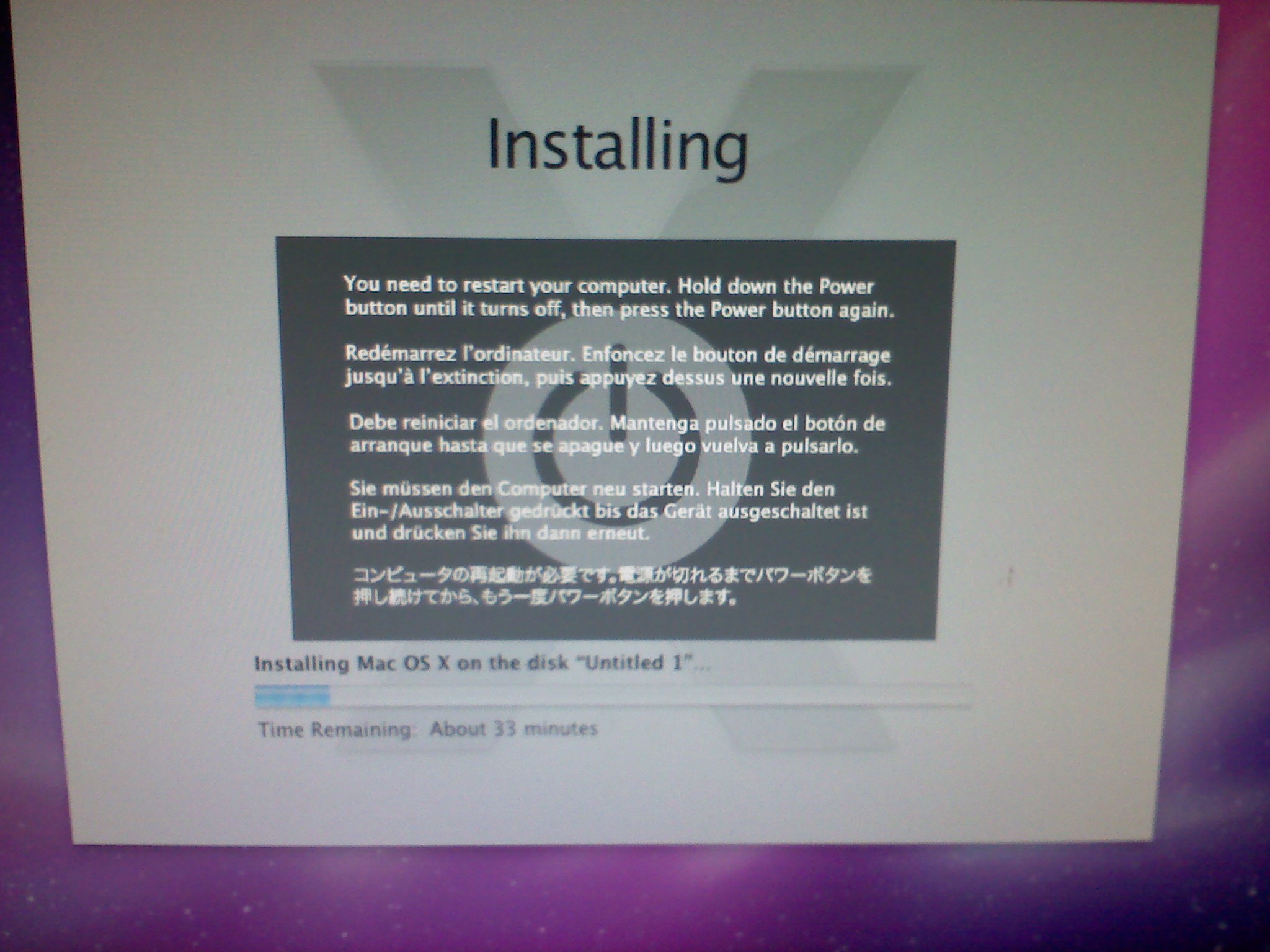

nopx Posted May 26, 2010 Share Posted May 26, 2010 guys you are amazing for this information. Thanks!! Here is my situation. 1) Installed Snow Leopard Retail to USB using transmac. 2) Cartri's Bios Installed 3) Boot132 cd , choose USB to install 4) Partition sata with Disk Utility (set guid) 5) Install Install fails at the begining giving me "You must restart your computer" message. Picture attached. Any help is appreciated. Thanks everyone. System: EP45-UD3l 2.5 gb DDr2 Core 2 Duo E6600 9800GT Zotac 250gb SATA hdd Link to comment https://www.insanelymac.com/forum/topic/187906-ga-ep45-ud3l-snow-leopard-install-guide-v10-for-newbies/page/17/#findComment-1475900 Share on other sites More sharing options...
breakingbad Posted May 26, 2010 Share Posted May 26, 2010 bb I bricked my mobo moving my office to the basement. Anyways, I got a new one and installed cartris bios right away and booted right up.......only my ethernet port is not working. do you have any suggestions? other than the internet....everything is the same and working. Cheers **EDIT** Scratch that bb. I went into my network preferences and it recognized the connection ALL IS GOOD! Nice to know everything is back to normal. I have noticed that, using Cartri BIOS, when I enable the option of GreenLan in my BIOS config OS X doesn't see the ethernet port and doesn't connect using it... but, in the other hand, disabling it make everything works fine then. That's what I'd suggest you to check in BIOS and see if this config could be the problem. Cheers, bb. guys you are amazing for this information. Thanks!! Here is my situation. 1) Installed Snow Leopard Retail to USB using transmac. 2) Cartri's Bios Installed 3) Boot132 cd , choose USB to install 4) Partition sata with Disk Utility (set guid) 5) Install Install fails at the begining giving me "You must restart your computer" message. Picture attached. Any help is appreciated. Thanks everyone. System: EP45-UD3l 2.5 gb DDr2 Core 2 Duo E6600 9800GT Zotac 250gb SATA hdd Hi nopx. I would suggest you to try the install booting this flags -v -f arch=i386 So this way you will avoid some minor issues that may occur. It's a must to check minutely your BIOS config because a little difference in it could avoid a successfull install. Cheers, bb. Does anyone get a message AHCI BIOS not installed when starting up their computer? Hi frog... Have you changed your BIOS to AHCI instead of IDE in Integrated Peripherals options? Cheers, bb. Link to comment https://www.insanelymac.com/forum/topic/187906-ga-ep45-ud3l-snow-leopard-install-guide-v10-for-newbies/page/17/#findComment-1475903 Share on other sites More sharing options...
nopx Posted May 26, 2010 Share Posted May 26, 2010 thanks for the reply, I tried that those flags and same problem "setup unable to copy files". Do you think its the usb stick i made with transmac? I checked md5 of the image before writing. Some more info, my boot cd is this version boot v5.0132 chameleon v2.0-RC1 r I've tripple checked bios settings. Thanks for the help. Link to comment https://www.insanelymac.com/forum/topic/187906-ga-ep45-ud3l-snow-leopard-install-guide-v10-for-newbies/page/17/#findComment-1475984 Share on other sites More sharing options...
breakingbad Posted May 26, 2010 Share Posted May 26, 2010 thanks for the reply, I tried that those flags and same problem "setup unable to copy files". Do you think its the usb stick i made with transmac? I checked md5 of the image before writing. Some more info, my boot cd is this version boot v5.0132 chameleon v2.0-RC1 r I've tripple checked bios settings. Thanks for the help. Hi. I have some info on success using the USB Stick as the way of install OS X, but I confess I prefer the nice old DVD disk into the drive method. Assuming you have the DMG file of OS X, burn it into a DVD media the slowest as you can. Maybe 2X or at max 4X... Look for verdant's DVD Boot Disk here in the forum - pages 8-10 I believe - and once again burn it into a DVD media as slow as you can. Once you done that, go for it and try to install. Remember to partition HDD target as GPT and Mac OS Extended (Journaled) and use the flags -v -f arch=i386. I believe it's not necessary, but you can even try using this more extended flag -v -f arch=i386 cpus=1 maxmem=2048 This flag will only boot one core of you CPU and just 2 Gb of RAM to cause you less trouble, but I don't believe it's quite necessary. Let me know what happens. Be sure to have the boot loader Chameleon 2 RC4 to run it nice. If you use Cartri BIOS this version of the boot loader is a must have. All the codes inside his bios are made based on this version. Cheers, bb. Link to comment https://www.insanelymac.com/forum/topic/187906-ga-ep45-ud3l-snow-leopard-install-guide-v10-for-newbies/page/17/#findComment-1476043 Share on other sites More sharing options...

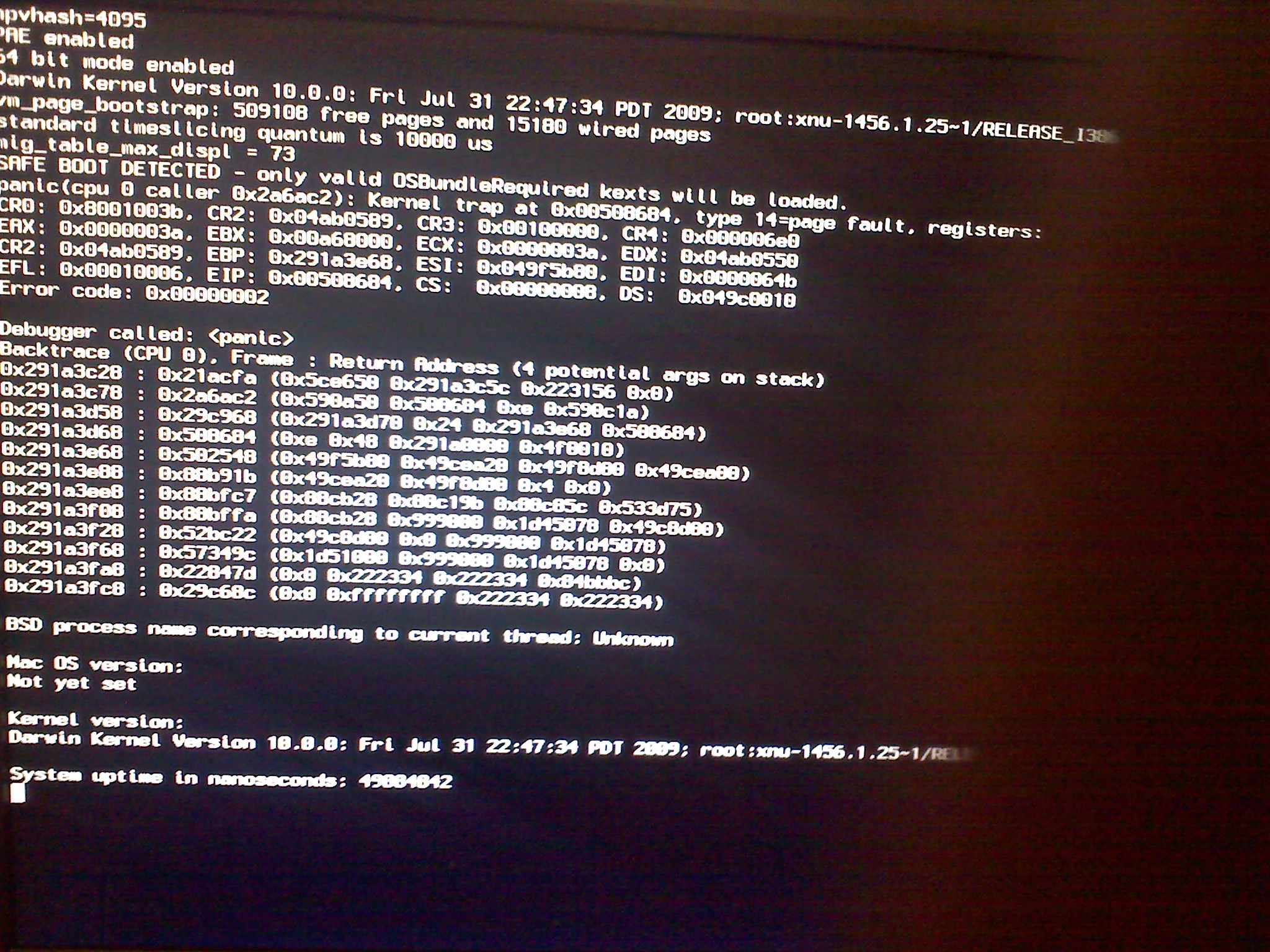

nopx Posted May 26, 2010 Share Posted May 26, 2010 I tried those flags with my current usb and got the attached kernel panic. Does it always say 64 bit mode even with the i386 switch? Anyway, my friend has a usb stick he created when he install SL on his pc with the same mobo so I'm going to give that a go tonight, just to rule out the image. We'll see what happens. Thanks. Link to comment https://www.insanelymac.com/forum/topic/187906-ga-ep45-ud3l-snow-leopard-install-guide-v10-for-newbies/page/17/#findComment-1476059 Share on other sites More sharing options...
breakingbad Posted May 26, 2010 Share Posted May 26, 2010 I tried those flags with my current usb and got the attached kernel panic. Does it always say 64 bit mode even with the i386 switch? Anyway, my friend has a usb stick he created when he install SL on his pc with the same mobo so I'm going to give that a go tonight, just to rule out the image. We'll see what happens. Thanks. Have you checked if HPET mode is in 32 or 64 bits in BIOS? Could be that... When we're going to install it for the first time, we have to be sure that it will be a nice install in 32 bits first and then we do the step to achieve 64 bits. Cheers, bb. Link to comment https://www.insanelymac.com/forum/topic/187906-ga-ep45-ud3l-snow-leopard-install-guide-v10-for-newbies/page/17/#findComment-1476091 Share on other sites More sharing options...
nopx Posted May 27, 2010 Share Posted May 27, 2010 I checked and set it correctly and still same issues. I had my flash stick formatted by my friend but it would not boot his pc, install failed again "can't copy necessary support files" when I use boot132 and load from usb. I'm going to try testing ram modules and hdd tonight, if that does not work, I'm going to grab a few DL dvd's and give it another try. We'll see how it turns out. Link to comment https://www.insanelymac.com/forum/topic/187906-ga-ep45-ud3l-snow-leopard-install-guide-v10-for-newbies/page/17/#findComment-1476547 Share on other sites More sharing options...
nopx Posted May 28, 2010 Share Posted May 28, 2010 Bad ram module, thanks BreakingBad+ everyone who helped accumulate all this info, I now have a SL install. Only problems are no audio and gfx right now, but i just need to do some more searching and reading to figure it out. Link to comment https://www.insanelymac.com/forum/topic/187906-ga-ep45-ud3l-snow-leopard-install-guide-v10-for-newbies/page/17/#findComment-1477073 Share on other sites More sharing options...
