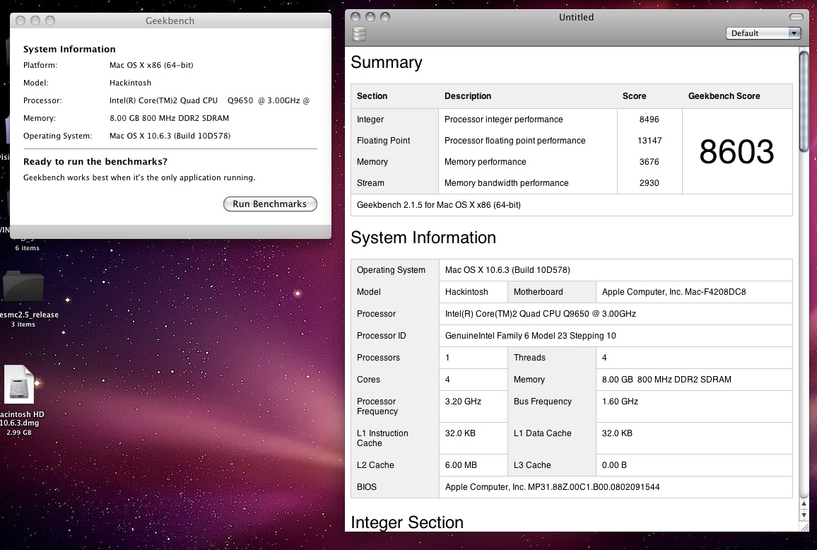

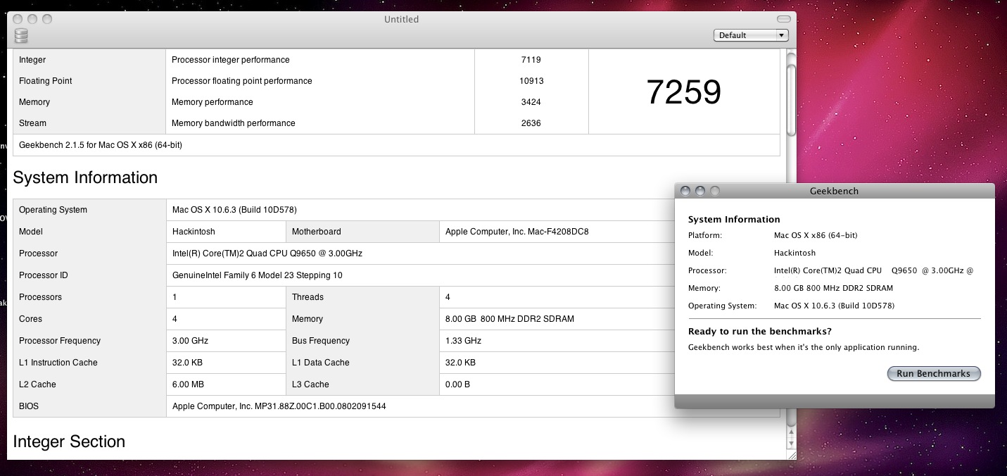

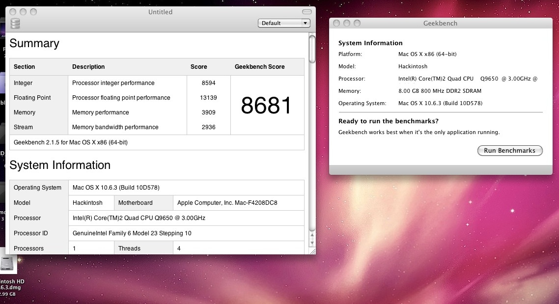

Would you mind running Geekbench (64-bit) here: http://cl.ly/16IV
as we have similar build except the CPU?
I'm courious if I should really think about CPU upgrade as yet.
Here is my score:
http://cl.ly/19Ia
I might have a friend pick me one of these at Microcenter. Really good deal $180. Newegg sells them for $278 lmao
