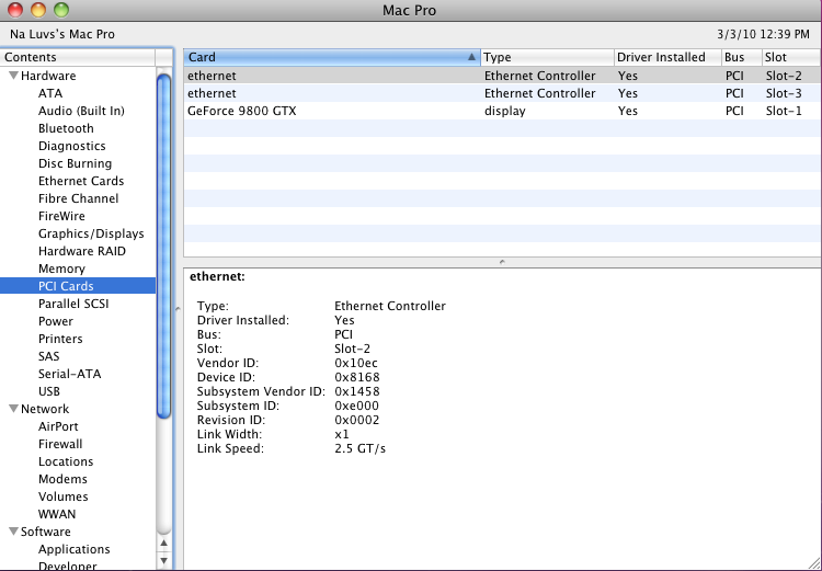

naluvs01 Posted March 3, 2010 Share Posted March 3, 2010 Hey guys I'm still having problems with my pci slots. I have the 1.6 rev MoBo and everything works great. Both of my LAN ports work and pci-e cards as well (whether or not it supports bonjour or not I don't know, but that is not important to me right now). However, I have installed two audio dsp card by universal audio (UAD-1) and they don't show up in the system profiler. The two LAN ports show as pci slot 2 and 3 Do I need to downgrade the bios? Any help would be greatly appreciated and then I can say my system is %100 vs %99.9. Also, this was my first computer I ever built and it was one of the most rewarding experiences of my life. Thank God for OSx86, insanely Mac, Adam @lifeHacker, Stell and all you guys for sharing your invaluable knowledge. Link to comment https://www.insanelymac.com/forum/topic/187440-lifehacker-guide-with-ga-ep45-ud3p-motherboard/page/50/#findComment-1422206 Share on other sites More sharing options...
leppy700m Posted March 3, 2010 Share Posted March 3, 2010 Hey guys I'm still having problems with my pci slots. I have the 1.6 rev MoBo and everything works great. Both of my LAN ports work and pci-e cards as well (whether or not it supports bonjour or not I don't know, but that is not important to me right now). However, I have installed two audio dsp card by universal audio (UAD-1) and they don't show up in the system profiler. The two LAN ports show as pci slot 2 and 3 Do I need to downgrade the bios? Any help would be greatly appreciated and then I can say my system is %100 vs %99.9. Also, this was my first computer I ever built and it was one of the most rewarding experiences of my life. Thank God for OSx86, insanely Mac, Adam @lifeHacker, Stell and all you guys for sharing your invaluable knowledge. You didn't say - have you installed the appropriate software to support these devices on OS X 10.6.x with the kernel type you are running? Even with a Mac, stuff doesn't just auto-magically appear in profiler if there is no soft support - and with third party devices it is often up to the user to add that soft support by installing software. I doubt this is a bios issue - rather an issue of a device not natively supported - native meaning without additional software other than what is included with a base OS X install. Since these are third party devices, it's highly unlikely you've got native support. Proposed FAQ Item: Q: I installed my hardware widget, but it doesn't work and doesn't show up in profiler. (Substitute word widget for ANY hardware being added - including alternate video cards, sound devices, mousetraps and thingamajigs) A: Only devices natively supported in OS X will work without additional software. It is up to the user to make sure that each hardware device added to any machine on any OS is supported in the target environment and understand that 3rd party vendor support does not mean automatic support in that environment. Often, software has to be installed to support third party devices (for OS X not 100% compatible with apple- supplied devices) or custom solutions developed. While it's possible that someone else has installed this widget successfully, instead of asking such a question in a forum not specifically supporting your widget, it's usually best form to Google up some info about your widget and OS X - something like "widget 1000 snow leopard" or heading off to a forum specifically about your widget, if available. Link to comment https://www.insanelymac.com/forum/topic/187440-lifehacker-guide-with-ga-ep45-ud3p-motherboard/page/50/#findComment-1422267 Share on other sites More sharing options...
