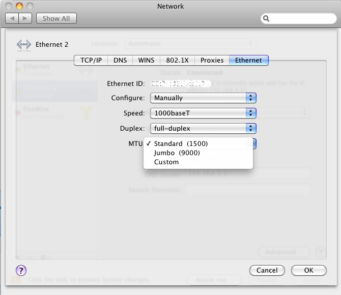

snood Posted January 13, 2010 Share Posted January 13, 2010 How were you setting this and testing it? I decided to treat myself and bought http://store.apple.com/us/product/MB977G/A...mco=MTA4NzI5Mjk I tried sudo networksetup -setMTU en0 9000 Seems to work on the apple card in 10.6.2 en0: flags=8863<UP,BROADCAST,SMART,RUNNING,SIMPLEX,MULTICAST> mtu 9000 I did read http://support.apple.com/kb/TA21333 and it says Warnings: 1. All devices on a local network must be configured to use Jumbo Frames, or loss of connectivity could occur on that network. I'm connecting to an apple timecapsule via ethernet but I didn't find the performance as good as with mtu1500 (2x 1GB full duplex) Didn't work, I am finding transferring files to my NAS to be extremely slow. I tried using a gigabit switch with only my desktop and NAS and still slow. main:~$ sudo networksetup -setMTU en0 9000 Password: Error - 9000 is not in the valid MTU range of 72-1500 ** Error: The parameters were not valid. Link to comment https://www.insanelymac.com/forum/topic/185097-guide-scripted-yosemitemavericks-install-on-gigabyte-mobos/page/71/#findComment-1384245 Share on other sites More sharing options...

rgb Posted January 13, 2010 Share Posted January 13, 2010 You need to ensure that your other routers etc support jumbo's or else you will have problemsI believe the Apple Airport routers don't support jumbo frames, what router are you using? If you use a native apple supported NIC then you can just jumbo frames via the advance ethernet features I am using Airport Extreme Base Station (N), according this page the apple router supports JF http://www.vonwentzel.net/ABS/Dissection-E...me-n/index.html My NIC is ex58's onboard one, using RT1000_SL.kext under ionetworkfamily.kext However the max MTU i can select in system preferences is 1500 Link to comment https://www.insanelymac.com/forum/topic/185097-guide-scripted-yosemitemavericks-install-on-gigabyte-mobos/page/71/#findComment-1384281 Share on other sites More sharing options...
LocusOfControl Posted January 13, 2010 Share Posted January 13, 2010 Didn't work, I am finding transferring files to my NAS to be extremely slow. I tried using a gigabit switch with only my desktop and NAS and still slow. main:~$ sudo networksetup -setMTU en0 9000 Password: Error - 9000 is not in the valid MTU range of 72-1500 ** Error: The parameters were not valid. I guess it is a limitation of the RealtekR1000.kext then ... I disabled my onboard NIC and bought an apple card, after doing the above my network prefs changed automatically and I can select it via the pref screen as well as via command line. Since I'm using a real apple card I can use the native kexts You could try an intel card http://www.insanelymac.com/forum/index.php?showtopic=202183 (mine uses the same chip as above apparently) Link to comment https://www.insanelymac.com/forum/topic/185097-guide-scripted-yosemitemavericks-install-on-gigabyte-mobos/page/71/#findComment-1384282 Share on other sites More sharing options...

rgb Posted January 13, 2010 Share Posted January 13, 2010 I guess it is a limitation of the RealtekR1000.kext then ... I disabled my onboard NIC and bought an apple card, after doing the above my network prefs changed automatically and I can select it via the pref screen as well as via command line. Since I'm using a real apple card I can use the native kexts You could try an intel card http://www.insanelymac.com/forum/index.php?showtopic=202183 (mine uses the same chip as above apparently) I wish i can use card without onboard nic, but all pci and pcie slots are used by another card Link to comment https://www.insanelymac.com/forum/topic/185097-guide-scripted-yosemitemavericks-install-on-gigabyte-mobos/page/71/#findComment-1384369 Share on other sites More sharing options...
