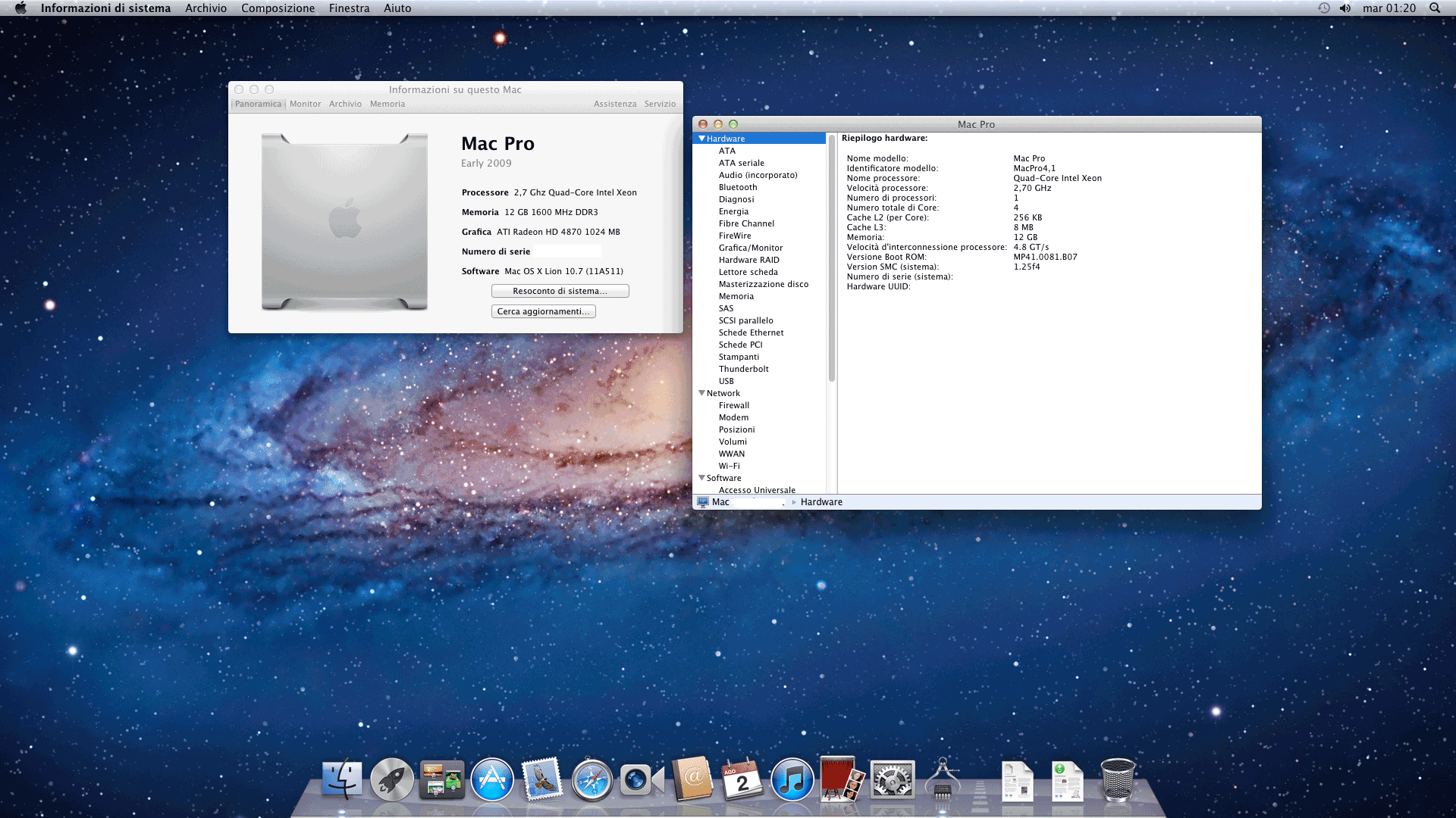

Z4g0r Posted August 1, 2011 Share Posted August 1, 2011 Hi Maj Lion is done! (102!) Proc is seen as Xeon quad core and hardware show 4 cores only Ram is shown 1600 but in real is 1333 GPU card is correct i need to work on ..... Link to comment https://www.insanelymac.com/forum/topic/185097-guide-scripted-yosemitemavericks-install-on-gigabyte-mobos/page/147/#findComment-1727686 Share on other sites More sharing options...
mangopeach Posted August 2, 2011 Share Posted August 2, 2011 Since your present install is a primary work computer, I would suggest obtaining another HD and cloning your present install. Make the clone operational and do the upgrading on the clone to make sure everything works before changing the 'main' install. Going from 10.6.2 to 10.6.8 is not difficult and does not require a lot of changes. First remove any sleepenabler.kext you are using on 10.6.2 - guaranteed KP with the old sleepenabler installed during first boot into 10.6.8. The other thing that will 'break' is audio. You are probably using an audio enabler presently, keep that and make a copy of the present (10.6.2) AppleHDA.kext. Installing those two kexts to replace the 10.6.8 audio kexts usually gets audio to working again. No need (at this time) to use a different bootloader or to change to a newer script version. Except for audio and sleepenabler (and possibly video) the present kexts in the kext folders will work. If you use GraphicsEnabler=yes or a EFI string in the boot.plist video should work. If you use one of the injection kexts that could be a problem (do a little research on that one). With the above considerations, download the 10.6.8 ComboUpdater from Apple and install from the resulting .dmg file to your cloned drive. Once booted into the updated cloned drive do the necessary tweaks (audio, new sleepenabler and possibly video) to complete the transition. Once you are satisfied with the update and operation, rinse and repeat onto your main drive. thanks... i will use a spare and play with it until i get it stable. Link to comment https://www.insanelymac.com/forum/topic/185097-guide-scripted-yosemitemavericks-install-on-gigabyte-mobos/page/147/#findComment-1727752 Share on other sites More sharing options...
digital_dreamer Posted August 2, 2011 Author Share Posted August 2, 2011 Hi MajLion is done! (102!) Proc is seen as Xeon quad core and hardware show 4 cores only Ram is shown 1600 but in real is 1333 GPU card is correct i need to work on ..... Cool. That memory speed might be because there may be a "SMmemspeed" key in the smbios.plist with "1600" as the string. Just change it or you may be able to delete the key entirely and get the bootloader to figure the RAM speed. RE: renaming the kext directory from "Stored Kext" to Extensions (Was it really "Stored Kext" or "Stored_Kexts"?) Was the script not making a boot cache for you in /Extra or did the script fail to change the name of the kext folder when you wanted to use the /Extra/Extensions setup? MAJ Link to comment https://www.insanelymac.com/forum/topic/185097-guide-scripted-yosemitemavericks-install-on-gigabyte-mobos/page/147/#findComment-1727819 Share on other sites More sharing options...
