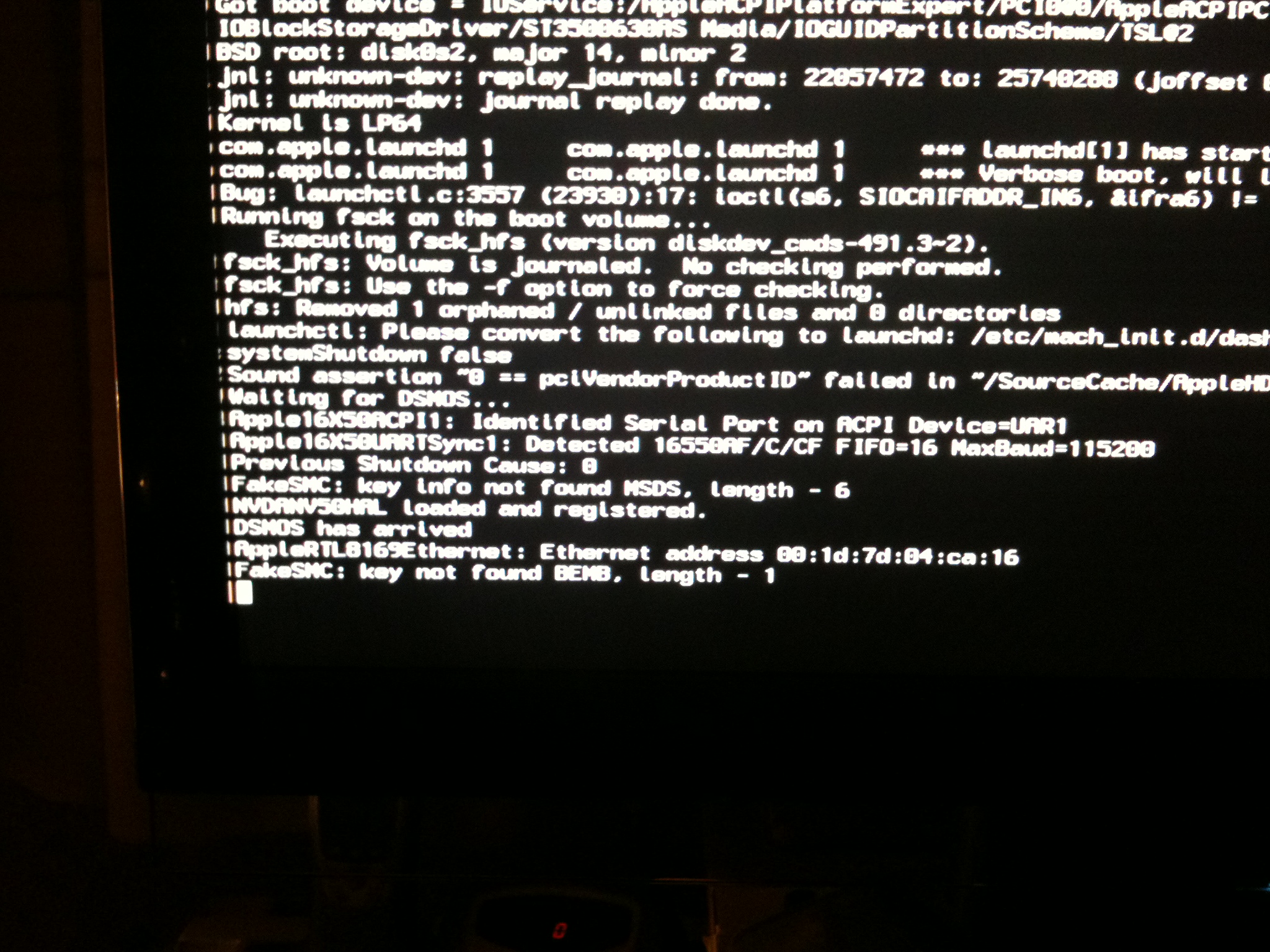

RichardJ Posted March 10, 2011 Share Posted March 10, 2011 Ok I found the time to do the attempt at a clean install. I unplugged all the sata cables except for the DVD and the one test drive. I then followed the new instructions to the letter. All the instructions seemed to work in that I could install snow leopard. I could install The GA-P35-DS4 Snow Leopard Installer. I could reboot and boot off the installed volume. The problem was previously I couldn't update past 10.6.2 so I tried installing the 10.6.6 combo updater and it installed, I then restarted, it got to the chamelon boot screen, I selected the drive, and it started booting and looked like it got part of the way but then failed and switched to a blue screen. I repeated this several times just to be sure and then booted with -v. Here is the picture right before the blue screen... Any hints? Thanks! Link to comment https://www.insanelymac.com/forum/topic/184367-guide-snow-leopard-vanilla-retail-guide-for-ga-p35-ds4-and-other-related-boards/page/29/#findComment-1652572 Share on other sites More sharing options...
tseug Posted March 10, 2011 Author Share Posted March 10, 2011 Ok I found the time to do the attempt at a clean install. I unplugged all the sata cables except for the DVD and the one test drive. I then followed the new instructions to the letter. All the instructions seemed to work in that I could install snow leopard. I could install The GA-P35-DS4 Snow Leopard Installer. I could reboot and boot of the installed volume. The problem was previously I couldn't update past 10.6.2 so I tried installing the 10.6.6 combo updater and it installed, I then restarted, it got to the boot chamelon boot screen I selected the drive and it started booting and looked like it got part of the way but then failed and switched to a blue screen. I repeated this several times just to be sure and then booted with -v. Here is the picture right before the blue screen... Any hints? Thanks! Try waiting 5 minutes on the blue screen. I get the same blue screen and it takes a while the first time. Link to comment https://www.insanelymac.com/forum/topic/184367-guide-snow-leopard-vanilla-retail-guide-for-ga-p35-ds4-and-other-related-boards/page/29/#findComment-1652742 Share on other sites More sharing options...
nathandw Posted March 14, 2011 Share Posted March 14, 2011 Hi there. I was getting the same annoying blue screen. There is no cursor appearing, nor any window. The solution I found, is to switch over to 32-bit mode. Tseug put a 'arch=x86_32' as kernel flag. Chameleon RC5 needs 'arch=i386' to go to 32-bit mode. Just give it a try! Greetz Jan Link to comment https://www.insanelymac.com/forum/topic/184367-guide-snow-leopard-vanilla-retail-guide-for-ga-p35-ds4-and-other-related-boards/page/29/#findComment-1655215 Share on other sites More sharing options...
CmCd01 Posted March 15, 2011 Share Posted March 15, 2011 Hi there. I was getting the same annoying blue screen. There is no cursor appearing, nor any window. The solution I found, is to switch over to 32-bit mode. Tseug put a 'arch=x86_32' as kernel flag. Chameleon RC5 needs 'arch=i386' to go to 32-bit mode. Just give it a try! Greetz Jan I was having a different problem - related to video - but this update fixed it. THANKS Link to comment https://www.insanelymac.com/forum/topic/184367-guide-snow-leopard-vanilla-retail-guide-for-ga-p35-ds4-and-other-related-boards/page/29/#findComment-1655577 Share on other sites More sharing options...

tseug Posted March 16, 2011 Author Share Posted March 16, 2011 Hi there. I was getting the same annoying blue screen. There is no cursor appearing, nor any window. The solution I found, is to switch over to 32-bit mode. Tseug put a 'arch=x86_32' as kernel flag. Chameleon RC5 needs 'arch=i386' to go to 32-bit mode. Just give it a try! Greetz Jan Fixed. Guide updated. Thanks for the heads up Link to comment https://www.insanelymac.com/forum/topic/184367-guide-snow-leopard-vanilla-retail-guide-for-ga-p35-ds4-and-other-related-boards/page/29/#findComment-1656245 Share on other sites More sharing options...
RichardJ Posted March 17, 2011 Share Posted March 17, 2011 Well I tried leaving the machine overnight (ie 8 hours) and it didn't work... I then tried just now changing: /Library/Preferences/SystemConfiguration/com.apple.Boot.plist find there: <key>Kernel Flags</key> <string></string> and change it to <key>Kernel Flags</key> <string>arch=x86_32</string> But I am still getting the blue screen of death. Do I need to try installing everything again? Is there a different way to say use 32 bit instead of 64 bit? (I also tried at the chamelon prompt just entering 'arch=i386' and also 'arch=x86_32' but neither of these did anything...) Thanks! Richard Link to comment https://www.insanelymac.com/forum/topic/184367-guide-snow-leopard-vanilla-retail-guide-for-ga-p35-ds4-and-other-related-boards/page/29/#findComment-1656725 Share on other sites More sharing options...
tseug Posted March 17, 2011 Author Share Posted March 17, 2011 Well I tried leaving the machine overnight (ie 8 hours) and it didn't work... :censored2: I then tried just now changing: /Library/Preferences/SystemConfiguration/com.apple.Boot.plist find there: <key>Kernel Flags</key> <string></string> and change it to <key>Kernel Flags</key> <string>arch=x86_32</string> But I am still getting the blue screen of death. Do I need to try installing everything again? Is there a different way to say use 32 bit instead of 64 bit? (I also tried at the chamelon prompt just entering 'arch=i386' and also 'arch=x86_32' but neither of these did anything...) Thanks! Richard change to arch=i386 in /Extra/com.apple.Boot.plist . /Library/Preferences/SystemConfiguration/com.apple.Boot.plist should not be touched. That is: undo anything you did to it. Link to comment https://www.insanelymac.com/forum/topic/184367-guide-snow-leopard-vanilla-retail-guide-for-ga-p35-ds4-and-other-related-boards/page/29/#findComment-1656772 Share on other sites More sharing options...
