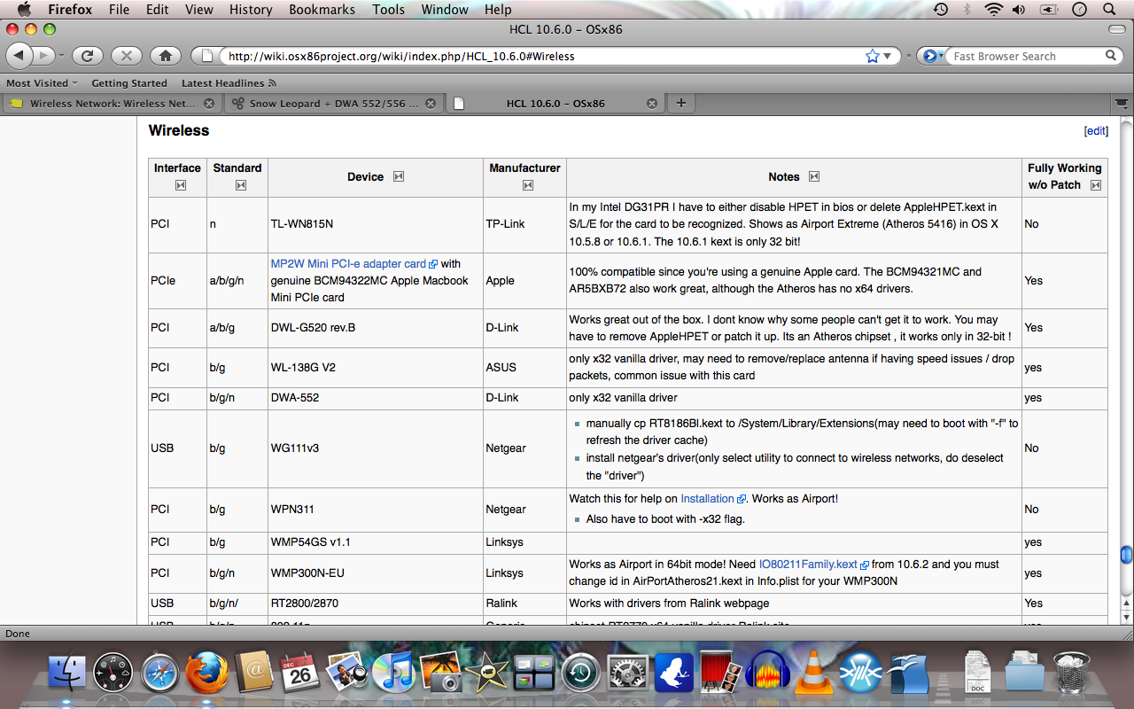

CaptainJack Posted December 26, 2009 Share Posted December 26, 2009 I am using a DWA552 with Snow Leopard 10.6.2 32-bit EFI. I am having the same problem as many of you all. I can connect to a wireless network but as soon as I do my computer completely locks up. The thing I don't understand is someone put in the HCL for 10.6.0 that it works. See screen shot. Does anyone know what the description means in regards to a vanilla driver? Link to comment https://www.insanelymac.com/forum/topic/184328-snow-leopard-dwa-552556-aka-atheros-ar5416/page/2/#findComment-1369110 Share on other sites More sharing options...

s01iD Posted January 25, 2010 Share Posted January 25, 2010 I am using a DWA552 with Snow Leopard 10.6.2 32-bit EFI. I am having the same problem as many of you all. I can connect to a wireless network but as soon as I do my computer completely locks up. The thing I don't understand is someone put in the HCL for 10.6.0 that it works. See screen shot. Does anyone know what the description means in regards to a vanilla driver? Disable HPET Mode in the BIOS. This did the trick for me ... Working fine since some hours ... Link to comment https://www.insanelymac.com/forum/topic/184328-snow-leopard-dwa-552556-aka-atheros-ar5416/page/2/#findComment-1395790 Share on other sites More sharing options...
