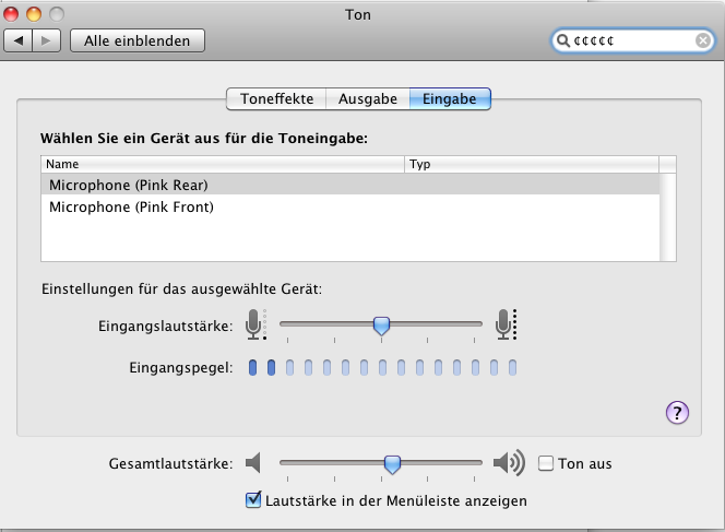

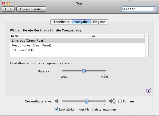

Just got lan working. My 630i had marvell yukon 88e8056 chipset. I just edited some strings inside the IONetworkingFamily.kext and i could connect to the network after rebooting.
I'm still trying to get the graphics card to work properly. Editing the string manually didnt fix it.
I forgot to mention that sound(ALC888) isnt working either. :)
UPDATE:
VoodooHDA x64 fixed the audio.

Now for the audio [sarcasm]yay![/sarcasm]
More EDIT: I got the Audio working just with the latest VoodooHDA (In /S/L/E Of course, /E doesn't work with all kexts for me.) I have an ALC889(A?)
