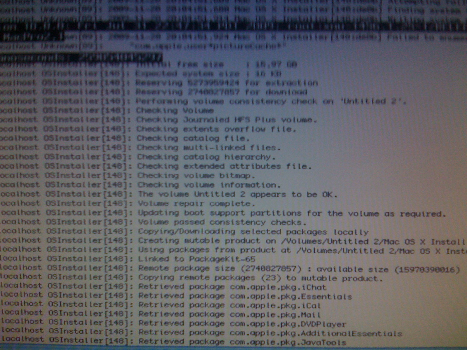

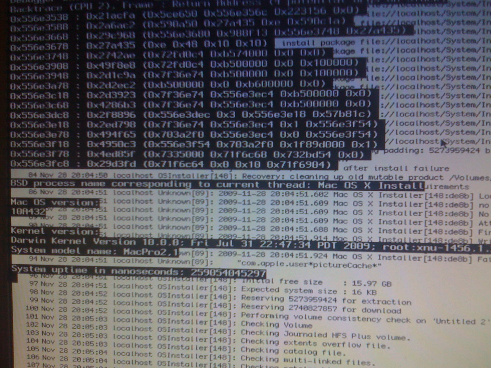

Hi artsin,
Are you saying you are able to install Snow using P5N-E SLI mobo?
That is the same motherboard that I have. I am able to create a bootable USB (from 10A432) using the guide in this thread, but when I try to install on a MBR partitioned IDE drive, I get a kernel panic.
At installation, under "Customize", I deselected all checkboxes, but it always panics at this point during installation.
Looking at the install log, the last few lines are this:
118 Nov 28 20:05:05 localhost OSInstaller[148]: Remote packages size (27408027857) : available size (15970390016)
119 Nov 28 20:05:05 localhost OSInstaller[148]: Copying remote packages (23) to mutable product
120 Nov 28 20:05:06 localhost OSInstaller[148]: Retrieved Package com.apple.pkg.iChat
121 Nov 28 20:05:48 localhost OSInstaller[148]: Retrieved Package com.apple.pkg.Essentials
122 Nov 28 20:05:49 localhost OSInstaller[148]: Retrieved Package com.apple.pkg.iCal
123 Nov 28 20:05:49 localhost OSInstaller[148]: Retrieved Package com.apple.pkg.Mail
124 Nov 28 20:05:50 localhost OSInstaller[148]: Retrieved Package com.apple.pkg.DVDPlayer
125 Nov 28 20:05:50 localhost OSInstaller[148]: Retrieved Package com.apple.pkg.AdditionalEssentials
126 Nov 28 20:05:50 localhost OSInstaller[148]: Retrieved Package com.apple.pkg.JavaTools
Please see attached pictures.
Thanks in advance
@ toloot
The OSInstall.mpkg approach for installing is often problematic.........
An alternative option is to install Snow Leopard onto a GPT/HFS+ partition/formatted USB flash drive (8GB or larger) or onto a external USB HDD and then clone it to your desktop MBR volume.....

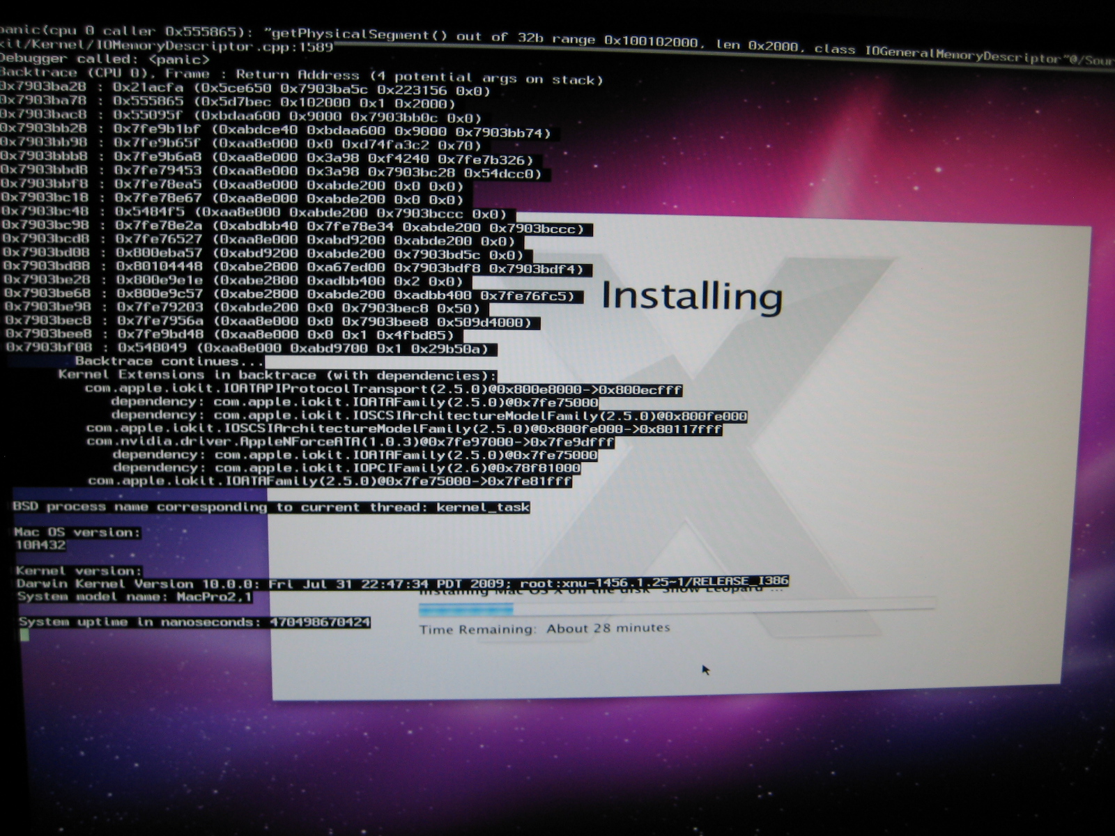

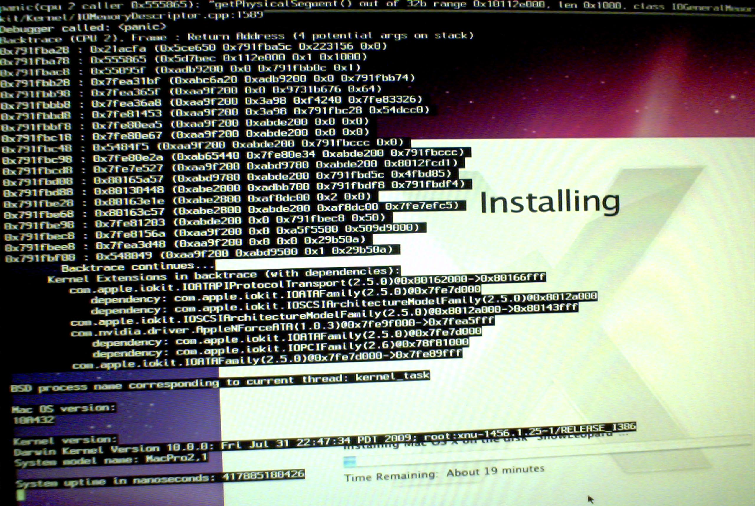

The first problem kext appears to be IOATAPIProtocolTransport (2.5.0) and then other IO*.kexts and the AppleNForceATA kext.......with the initial kernel panic related to 32bit versus 64bit memory accessing because you have more than 3GB RAM installed.....
So, the system panics with the following message type in the kernel panic log:
panic(cpu X caller 0xXXXXXXXX): getPhysicalSegment() out of 32b range
0xXXXXXXXX, len 0xXXXX, class IOGeneralMemoryDescriptor.......
AFAIK the reason is that getPhysicalSegment returns a 32 bit address but because the physical memory address cannot fit in 32 bits a panic occurs.....which invariably happens when more than 3GB of RAM is installed on the MOBO.....
Have you installed slashack's AppleNForceATA v0.1 kext yet?......if not, then you should do so because it supports 64bit memory addressing.......and boot Snow Leopard in 32bit mode....
Even with slashack's AppleNForceATA v0.1 kext installed, which enables use of >3GB RAM without any problems for 99% of the time, there still seem to be some apps that cause memory addressing kernel panics either during installation or during large data file transfers e.g. video/audio files......

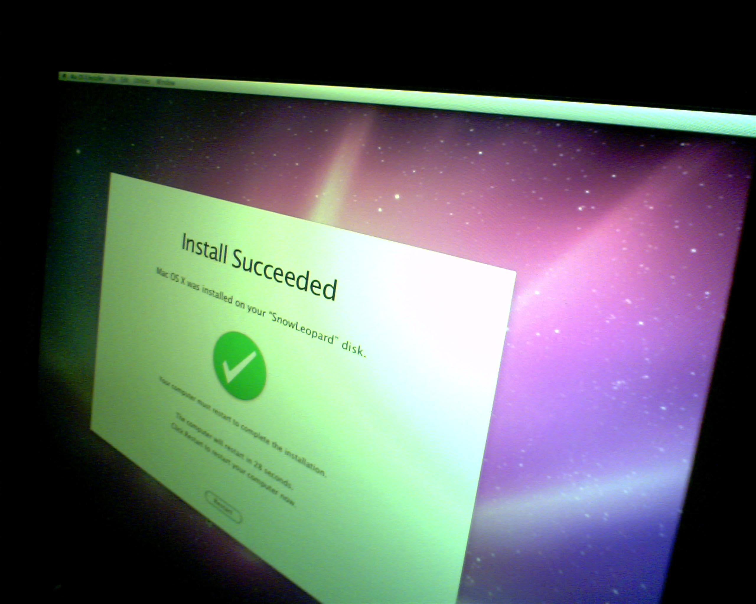

Woohoo! It works! :D Verdant <3
Now to boot....
Anyone know why my monitor would lose signal while booting + 2 minutes later the computer restarts itself?
I'm guessing this is a graphics issue? Any advice?
Actually I tried booting off of the nForceSLBoot132DVD.iso and it works! :D, no idea why. :) Sound doesn't work.
Finally though, vanilla yumminess :)

Well considering I do have 6 GB's of Ram. I'll take some out and see if it makes a difference. I did try slashacks kext, and anv's and Medevils AppleNForceATA. I got a kernel panic each time. I guess I'm going to have to take more photos in that case. Because I definitely noticed different kernal panic messages.
I'll go through your guide a little more, and just check over the steps to make sure I did things right. You definitely reccomend installing chameleon RC1 with netkas 10.1 correct? (Thats what I've been using.)
So I just tried Slashacks again just for fun. And I got this KP:
Then I reformatted my partition and redid all the steps, tried it with only 2 GB's of RAM, and got this:
