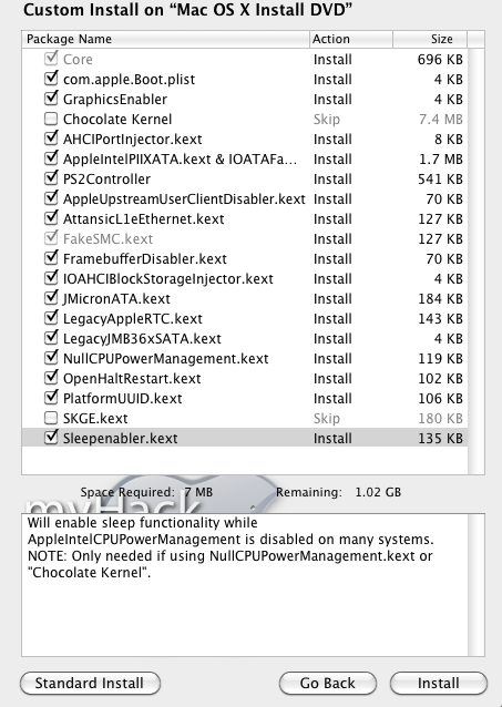

I am using the same board with a new 10.6 experiment. This guide was awesome for its time, but the myhack installer made it so much easier.
1.) Restored SL DVD image to USB drive
2.) Ran Myhack installer on the USB drive with pretty much everything that applies, leaving off the IDE stuff, chocolate kernel, and Marvel ethernet
3.) Installed from USB drive to a freshly-formatted hard drive
4.) Booted from USB drive again
5.) Installed Myhack to the hard drive
6.) copied VoodooHDA from first post of this thread to /Extras/Extensions
7.) re-ran pfix
This took me about 90 minutes, including a bit of experimenting. Everything works - everything. I even have digital and all analog audio.
My hardware is the P5QL-Pro, an E5200, 4GB DDR2, a 160GB WD drive (SATA), LG DVD-RW (SATA), Geforce 9500GT 512MB
I have not tested sleep, but it'll be running SETI@Home all the time so no need.
One problem - it does not reboot. It shuts down like it's going to but never POSTS again. Hit the reset button and it starts right up. Maybe running the dsdt.aml patcher will fix that.

Updated to 10.6.1. Had to re-run pfix to re-build my Extensions.mkext but otherwise was perfect.
Reboot has been fixed by patching DSDT.aml. At least, that's what I THINK fixed it.
