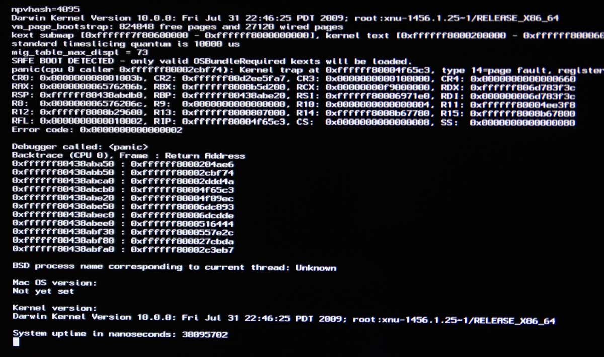

fulcrumbg Posted December 28, 2009 Share Posted December 28, 2009 I tried this method here for my Asus P5Q Pro with Ati HD 3870, but no matter what I do everything ends into a similar Kernel Panic like that one from XLR: I've got the same problem, and even after enabling ACPI 2.0 , still got the same screen, Mb: P5QL PRO Gfx: Sapphire Radeon 4870 1GB DDR5, Intel Q9400 Patched BIOS v. 0902 I have followed all the steps in the guide, and no success at all Any other solution, or maybe something else to set up in the BIOS ? on the other hand iDeneb 1.5.7 installs fine (only after installing video driver , shutdown/ restart doesn't work ) Link to comment https://www.insanelymac.com/forum/topic/183524-asus-p5q-including-p5ql-pro-series-guide-to-install-os-x-106-snow-leopard-retail/page/3/#findComment-1370961 Share on other sites More sharing options...
