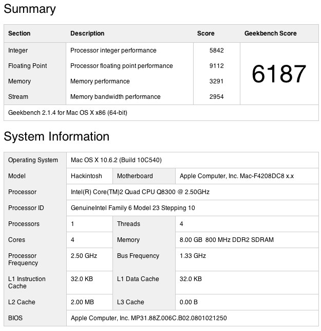

ridgeline Posted March 29, 2010 Share Posted March 29, 2010 beware sleepenabler may cause KP but best of luck. and if any updates arise sleep enabler will most likely cause a KP meaning you need tto uninstall it and then perform updates. Download Geekbench and run it 32 bit test is free but 64 bit will be more accurate. post results, glad everything is working except sleep did you ever take pics of the bios settings? please do and post them Link to comment https://www.insanelymac.com/forum/topic/182655-mini-guide-sl-working-on-gigabyte-g41m-es2l/page/9/#findComment-1436185 Share on other sites More sharing options...

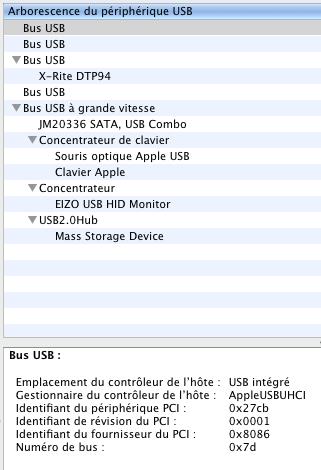

ridgeline Posted March 30, 2010 Share Posted March 30, 2010 I am not with my Hac at the moment but Cybercap do me a favor and open system profiler and select the USB key on the left and take a screen shot. If your usbs are screwed up then that could be your problem for the sleep and external drive issue. Nandor use my post installer and when it opens select customize then un check everything except audio and repair permissions using kext utility and see if that helps? according to the update there is nothing with audio fixes I have read anyway. Cybercap my system is rock solid never fails sleep and I have not installed sleep enabler since I patched the dsdt. And yes most people here are using the rev 1.0 board Time machine works it just won't save when the computer sleeps it would not do it anyway. The issue is when you are waking from sleep it kicks the USB and acts as if you unplugged it instead of ejecting first. I am running the smbios that is on the installer that I made. Mac Pro 3,1 Also google voodoomonitor download. install the kext with kext utility and the run the monitor it will show us if you speedstep is working. UPDATE: With the kext in /Extra mentioned above and using ridgelines dsdt the update to 10.6.3 went perfect. It didnt break sleep restart or shutdown and as far as i can tell everything is working fine UPDATE UPDATE UPDATE UPDATE Sorry i was wrong i didnt even pay attention until i went to play music but it DOES BREAK SOUND Did you check system preferences to make sure your speakers were correctly selected under sound system preferences Link to comment https://www.insanelymac.com/forum/topic/182655-mini-guide-sl-working-on-gigabyte-g41m-es2l/page/9/#findComment-1437449 Share on other sites More sharing options...
cybercap Posted March 30, 2010 Share Posted March 30, 2010 I am not with my Hac at the moment but Cybercap do me a favor and open system profiler and select the USB key on the left and take a screen shot. If your usbs are screwed up then that could be your problem for the sleep and external drive issue. ok. i'm busy these days but tonite i hope i can post this and the bios images FYI, sleep mode did not work with corrected smbios (imac7,1), so this did not help. i have removed sleepenabler as it "seemed" to work twice, but the third time it failed (to go to sleep). if you haven't done any mods apart from installing your package and your sleep works it might be worth looking on the usb or bios side, i will post screens of my config. Cybercap my system is rock solid never fails sleep and I have not installed sleep enabler since I patched the dsdt. Do i also have the patched dsdt, was it included in the post install package ? And yes most people here are using the rev 1.0 board Time machine works it just won't save when the computer sleeps it would not do it anyway. The issue is when you are waking from sleep it kicks the USB and acts as if you unplugged it instead of ejecting first. yes that is normal, if the computer shuts down to sleep, usb drives can be ejected nicely. I guess this does not damage the drive and harm the saves stored on it ? I am running the smbios that is on the installer that I made. Mac Pro 3,1 ok. i have yours too, macpro or imac or whatever does not solve my sleep problem. Anyway, the smbios is only "text" isn't it ? I could write that i have an eight-core with 32gb and that wouldn't matter Also google voodoomonitor download. install the kext with kext utility and the run the monitor it will show us if you speedstep is working. ok ! EDIT: if speedstep is related to the CPU EIST line in the bios, i have mine to disabled as far as i can remember (will check back home) Link to comment https://www.insanelymac.com/forum/topic/182655-mini-guide-sl-working-on-gigabyte-g41m-es2l/page/9/#findComment-1437461 Share on other sites More sharing options...

ridgeline Posted March 31, 2010 Share Posted March 31, 2010 Okay that was not what I thought of but you posted the right screen. Check each of the entries that say bus usb not the ones that show what is plugged in but the root make sure they say internal or built in. @iRobie your tried my dsdt? should eliminate the need for the extra stuff such as sleep enabler. For those that want working audio after update please run this installer credit to Tonymac great little installer re installs Applehda from 10.6.2 the easy way 10.6.2_AppleHDAInstaller.zip Link to comment https://www.insanelymac.com/forum/topic/182655-mini-guide-sl-working-on-gigabyte-g41m-es2l/page/9/#findComment-1438101 Share on other sites More sharing options...

cybercap Posted March 31, 2010 Share Posted March 31, 2010 Okay that was not what I thought of but you posted the right screen. Check each of the entries that say bus usb not the ones that show what is plugged in but the root make sure they say internal or built in. ok i'll post that at lunch in my screenshot it looks like there are hi-speed usbs but also "normal" ones ? does this board still have 1.1 or all the usb are 2.0 ? i connected the front usb and i added a 2 usb-port at the back to enable all 8 ports (but not all have an usb device plugged in at all times) I also noticed that my usb keyboard is not working anymore at post, even with legacy KB on in bios (everything usb is on) ! any ideas i have to plug a ps/2 kb to enter setup... For those that want working audio after update please run this installer credit to Tonymac great little installer re installs Applehda from 10.6.2 the easy way thanks Link to comment https://www.insanelymac.com/forum/topic/182655-mini-guide-sl-working-on-gigabyte-g41m-es2l/page/9/#findComment-1438241 Share on other sites More sharing options...
