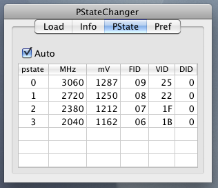

cybercap Posted April 28, 2010 Share Posted April 28, 2010 thanks, i'll try the ntfs 3g are you sure it works in full 64 bit kernel (i've browsed tuxera site and seems not so good in 64bits) here is my pstate shot (i'm actually running my Q6600 with a small oc 3,06ghz) Link to comment https://www.insanelymac.com/forum/topic/182655-mini-guide-sl-working-on-gigabyte-g41m-es2l/page/11/#findComment-1457638 Share on other sites More sharing options...

ridgeline Posted April 29, 2010 Share Posted April 29, 2010 Okay I will look into the drive thing mine do not do that unless the system sleeps. You could try the ntfs-3g I am not currently running it but have in the past. I will do your dsdt tomorrow as I am not at work today. I will check it and get back to on that asap though. People please keep in mind that with speedstepping and temp monitoring if you are running HD video and multitasking other things and running at the highest step your computer is not gonna be running at 35-45 degrees, this will be your idle temps as long as you are not running like 70 you should be okay this is running stock with stock fans and such if you are trying to OC the system your temps will be higher and you will need upgraded fans and such. Link to comment https://www.insanelymac.com/forum/topic/182655-mini-guide-sl-working-on-gigabyte-g41m-es2l/page/11/#findComment-1458239 Share on other sites More sharing options...

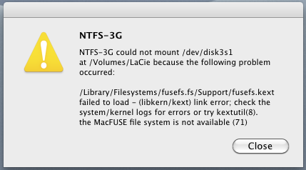

cybercap Posted April 30, 2010 Share Posted April 30, 2010 ntfs-3g does not mount; i get this error any ideas ? Link to comment https://www.insanelymac.com/forum/topic/182655-mini-guide-sl-working-on-gigabyte-g41m-es2l/page/11/#findComment-1458929 Share on other sites More sharing options...
ridgeline Posted April 30, 2010 Share Posted April 30, 2010 Okay I am confused by your install and I am guessing that some of your issues are coming from the bios settings I would recommend checking the optimized defaults and saving and then running mac I will be checking the dsdt shortly and posting a link for you on that if it is different from the one I have already made. You must have the power at st3 under bios Not sure about the ntfs-3g that was the only thing I knew about that would help and since it is a system preference not really an app it is not like you have the option of running it 32bit compatible. I will see what I can find, Link to comment https://www.insanelymac.com/forum/topic/182655-mini-guide-sl-working-on-gigabyte-g41m-es2l/page/11/#findComment-1458964 Share on other sites More sharing options...
cybercap Posted April 30, 2010 Share Posted April 30, 2010 what issues are you talking about ? bios should be well. i'm in S3, 64bit HPET, AHCI and all the hackintosh stuff no other changes apart from the little oc. i'm running full 64 bit system from boot to everything else, maybe the ntfs-3g is not 64bt compatible. i don't understand the error message anyway i *could* save and reformat my ext drive, maybe it's quicker than messing around trying to get ntfs working. if i format hfs+ will win7/XP be able to read/write to it ? or should i do fat32 ? (i think there is a limitation to 4gb file, but that's fine for me on this drive Link to comment https://www.insanelymac.com/forum/topic/182655-mini-guide-sl-working-on-gigabyte-g41m-es2l/page/11/#findComment-1458989 Share on other sites More sharing options...
ridgeline Posted April 30, 2010 Share Posted April 30, 2010 what issues are you talking about ? bios should be well. i'm in S3, 64bit HPET, AHCI and all the hackintosh stuff no other changes apart from the little oc. i'm running full 64 bit system from boot to everything else, maybe the ntfs-3g is not 64bt compatible. i don't understand the error message anyway i *could* save and reformat my ext drive, maybe it's quicker than messing around trying to get ntfs working. if i format hfs+ will win7/XP be able to read/write to it ? or should i do fat32 ? (i think there is a limitation to 4gb file, but that's fine for me on this drive For the Mac side of things you need to be HFS+ I you should be able to read NTFS natively with SL. Here is your Q6600 DSDT also let me know how that works I am not sure about why sleep is not working for you hopefully this will help with that. The numbers were off a bit from what I had in the q6600 Post installer which is where some of the issues could come from but it would be nothing to do with the NTFS-3g Once you let me know how the new dsdt works I can add it to the installer. Please test and report back. Thanks Just drag and drop this into place Q6600_DSDT.zip Link to comment https://www.insanelymac.com/forum/topic/182655-mini-guide-sl-working-on-gigabyte-g41m-es2l/page/11/#findComment-1459110 Share on other sites More sharing options...

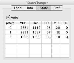

iRobie Posted April 30, 2010 Author Share Posted April 30, 2010 Hi Ridgeline, Here's my PState. This is for a stock speed E8200. I've tried editing the DSDT myself & using the rest of your installer, but whenever I do I still have sleep troubles. Just waking from sleep - it goes to sleep just fine I'll try a clean install with your installer. I probably have other conflicts going on that are causing the problems. Is there anything else you do to enable sleep? I was reading elsewhere that some need to disable something in preferences to get sleep working correctly - don't remember now. Thanks! Link to comment https://www.insanelymac.com/forum/topic/182655-mini-guide-sl-working-on-gigabyte-g41m-es2l/page/11/#findComment-1459173 Share on other sites More sharing options...
ridgeline Posted April 30, 2010 Share Posted April 30, 2010 Well you must go into system preferences and energy saver and select restart after power failure in order for sleep to work correctly not sure why that is but it is. Here is the modded dsdt let me know how it works E8200_DSDT.zip Link to comment https://www.insanelymac.com/forum/topic/182655-mini-guide-sl-working-on-gigabyte-g41m-es2l/page/11/#findComment-1459198 Share on other sites More sharing options...
cybercap Posted April 30, 2010 Share Posted April 30, 2010 For the Mac side of things you need to be HFS+ I you should be able to read NTFS natively with SL. I was able to read the NTFS on that ext disk BEFORE i switched to NTFS-3G. Now that the ntfs driver has been replaced by the 3g one, it doesn't mount anymore. Here is your Q6600 DSDT also let me know how that works I am not sure about why sleep is not working for you hopefully this will help with that. The numbers were off a bit from what I had in the q6600 Post installer which is where some of the issues could come from but it would be nothing to do with the NTFS-3g Once you let me know how the new dsdt works I can add it to the installer. Please test and report back. Thanks Just drag and drop this into place Many thanks. I'll try that and let you know on sunday afternoon (i'm staying at some friends for the week end) I guess my OC doesn't change the values the psstate shows ? on your screenshot i see that you checked "put the hard drives to sleep", this is unchecked on my system. It is very unlikely that it prevents my system to go to sleep Link to comment https://www.insanelymac.com/forum/topic/182655-mini-guide-sl-working-on-gigabyte-g41m-es2l/page/11/#findComment-1459223 Share on other sites More sharing options...
iRobie Posted April 30, 2010 Author Share Posted April 30, 2010 Well you must go into system preferences and energy saver and select restart after power failure in order for sleep to work correctly not sure why that is but it is. Here is the modded dsdt let me know how it works Thanks! I'll give it a shot. I only have 'Put the hard disk to sleep' and 'Allow power button to sleep computer' checkboxes right now. I'll let you know how it goes. Even though I don't have the wake for network access button, Wake on Lan definitely works. I use it daily. I have an Airport Extreme in my house, but it's not my router - it's just a wireless device. I wonder if that's why I don't have that checkbox. Link to comment https://www.insanelymac.com/forum/topic/182655-mini-guide-sl-working-on-gigabyte-g41m-es2l/page/11/#findComment-1459233 Share on other sites More sharing options...
ridgeline Posted April 30, 2010 Share Posted April 30, 2010 Thanks! I'll give it a shot. I only have 'Put the hard disk to sleep' and 'Allow power button to sleep computer' checkboxes right now. I'll let you know how it goes. Even though I don't have the wake for network access button, Wake on Lan definitely works. I use it daily. I have an Airport Extreme in my house, but it's not my router - it's just a wireless device. I wonder if that's why I don't have that checkbox. Mine showed up after installing a wireless card in my Hac the computer will only restart if it was on when the power failed so if the system is off when a power failure hits it will stay off I'll try that and let you know on sunday afternoon (i'm staying at some friends for the week end) I guess my OC doesn't change the values the psstate shows ? on your screenshot i see that you checked "put the hard drives to sleep", this is unchecked on my system. It is very unlikely that it prevents my system to go to sleep I was more so trying to show that it is necessary to have the restart on powerfailure box checked and where to do so. Yes please guys let me know how these work out. Link to comment https://www.insanelymac.com/forum/topic/182655-mini-guide-sl-working-on-gigabyte-g41m-es2l/page/11/#findComment-1459261 Share on other sites More sharing options...
iRobie Posted May 1, 2010 Author Share Posted May 1, 2010 It's working! Two kexts, just like you said it could be done I'll edit the front page guide very shortly. I did a clean install and, with your installer, it couldn't be simpler. There's only three things a new user will need to know: 1. After installation, a CPU specific DSDT is needed, though your installer provides many common CPUs 2. After installation, the 10.6.2 AppleHDA file is needed for sound 3. Speedstep may not appear to be working at first, but give Spotlight time to run the index Oh - the 1.5 installer didn't work for me. It kept saying it couldn't install because there was nothing to install, or no changes to be made. Something like that. Getting the 1.4 installer worked. Thanks for the great work! Link to comment https://www.insanelymac.com/forum/topic/182655-mini-guide-sl-working-on-gigabyte-g41m-es2l/page/11/#findComment-1459428 Share on other sites More sharing options...
