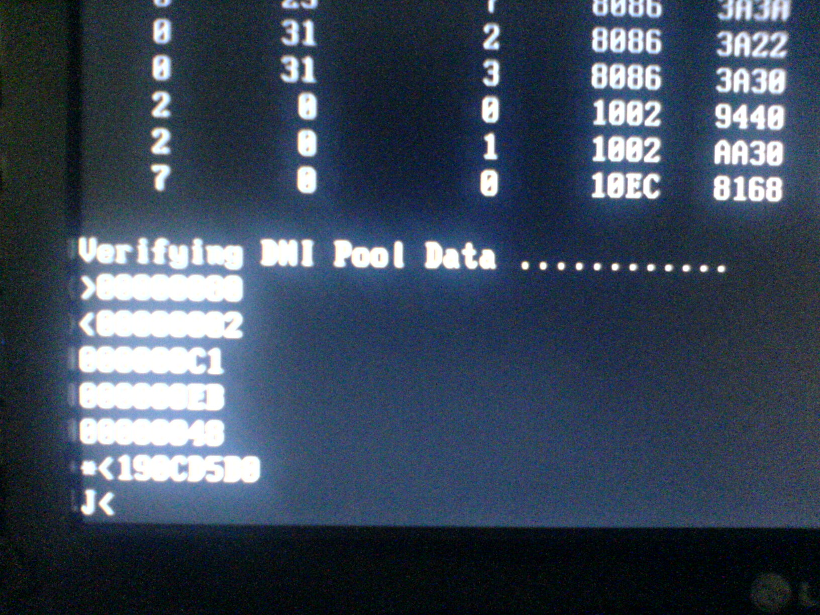

Hi JaE-V...
thanks for you kind guide.
I tried...somewhat failed.
I think my buidl is just like yours except VGA, mine ATI 3870.
Anyway, I though I could get the driver fixed for VGA later, and just go ahead following your guide exactly.
But after booting with -x -v, I got stuck. Please, check the image and if you can, help me.
Thanks again!

Hi JaE-V...
Thanks again!
Same error as the one posted in the previous image?
Also guys, try and make sure when your booting up and making sure your booting from the snow leo drive's loader not the leopard one, hence the boot files are different. That early panic is a bootloader issue

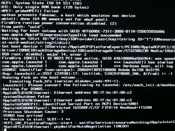

Hi
I have a empty HDD, which I'm using for the sl install.
So, I followed your guide from a seperate leopard hdd to another HDD for SL.
Sorry the pix was too big...I resized it!

Hey that looks good, all the files are registering, after the ethernet thing, it should kick into video! but if its timing out there your having a problem with your vid card. I've watched that process for a while, looks like your almost ready to go. If you find video drivers for snow for your card put them in the S/L/E directory of your snow partition and run
sudo -s
cd /Volumes/<<[SnowLeopard]>>/System/Library/Extensions
chown -R root:wheel *
chmod -R 755 *
reboot and you should be good "snow leopard" being the name of your snow partition
sudo -s
chmod -R 755 *
