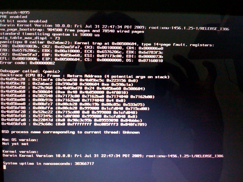

Traggr Posted September 6, 2009 Share Posted September 6, 2009 HI...A big thanks once again to bcc9 for a great step by step guide After doing all that was mentioned- on my first boot & then for all subsequent boots with experimental addition of more kexts(not needed ones) in the hope that the KPs wont happen..I kept gettin this one Kp for Kext submap. Details are almost same to what is below npvhash=4095 Darwin Kernel Version 10.0.0: Fri Jul 31 22:48:25 vm_page_bootstrap: 1977999 free pages and 119148 wired pages kext submap [0xffffff7f80600000 - 0xffffff0000000000], kernel text [0xffffff0000200000 - 0xffffff0000600000] standard timeslicing quantum is 10000 us mig_table_max_displ = 73 panic(cpu 0 caller 0xffffff80002cbf74): Kernel trap at 0xffffff00004f65c3, type 14=page fault, registers: CR0: 0x………. Debugger called: Backtrace (CPU 0), Frame: Return Address 0xffffff88a28cba50………… BSD process name corresponding to current thread: Unknown Mac OS version: Not yet set Kernel version: Darwin Kernel Version 10.0.0: Fri Jul 31 22:46:25 PDT 2009; root:xnu-1456.1.25±1/RELEASE_X86_64 System uptime In nanoseconds: 63715772 Now, I read on another forum a suggestion to fix this by formatting the entire HDD & using GPT.This solution is not very practical for me since I'll be needing to use Win & Linux too & i'll need MBR Is anyone here using MBR & successfully booting without this KP? Im running Leopard 10.5.6 on the M1340 & the external Hdd that im using has the 'Snow' partition in no.3 place. partition no1 is NTFS & no2 is HFS+ & no 4 is FAT. Link to comment https://www.insanelymac.com/forum/topic/181293-dell-xps-1340-under-osx-106-including-boot-132-install-cd/page/3/#findComment-1254466 Share on other sites More sharing options...
bcc9 Posted September 6, 2009 Author Share Posted September 6, 2009 After doing all that was mentioned- on my first boot & then for all subsequent boots with experimental addition of more kexts(not needed ones) in the hope that the KPs wont happen..I kept gettin this one Kp for Kext submap. Details are almost same to what is below npvhash=4095 Darwin Kernel Version 10.0.0: Fri Jul 31 22:48:25 vm_page_bootstrap: 1977999 free pages and 119148 wired pages kext submap [0xffffff7f80600000 - 0xffffff0000000000], kernel text [0xffffff0000200000 - 0xffffff0000600000] standard timeslicing quantum is 10000 us mig_table_max_displ = 73 panic(cpu 0 caller 0xffffff80002cbf74): Kernel trap at 0xffffff00004f65c3, type 14=page fault, registers: CR0: 0x………. So you're getting a crash right away before any kexts load? I haven't had that problem. Since it's right away I'd suspect something pretty fundamental like your DSDT.aml is corrupt. I also notice that you're booting in 64 bit mode instead of 32 (like in the instructions). Is anyone here using MBR & successfully booting without this KP?Yes of course I am I think I may have fixed the occasional boot-time panic from the AppleHDA codeUpdate: I still get this panic at boot time occasionally (unrelated to Traggr's early panic btw). Link to comment https://www.insanelymac.com/forum/topic/181293-dell-xps-1340-under-osx-106-including-boot-132-install-cd/page/3/#findComment-1254766 Share on other sites More sharing options...

Traggr Posted September 7, 2009 Share Posted September 7, 2009 So you're getting a crash right away before any kexts load? I haven't had that problem. Since it's right away I'd suspect something pretty fundamental like your DSDT.aml is corrupt. I also notice that you're booting in 64 bit mode instead of 32 (like in the instructions). Actually, no..Im not getting the crash immediately.After booting in verbose mode,I can see a whole lot of kexts being loaded & then several seconds later the screen stops at this kext submap error. I have booted in both 32 & 64bit as well..get the same panic. As for the DSDT, Im using the same one posted by you.Also is aud.dsl(the other file)from your DSDT zip post to be added in alongside Extra/DSDT.aml in the Snow Partition? .. Iv done that already.. but jus confirming... Also, if you would be kind enough to post your smbios.plist & com.apple.boot.plist , it'll really be helpful to reduce my margin of error. I am a bit unsure if I'v edited those 2 plists correctly... Thanks again.. EDIT - As posted by Itwong "Chameleon 2 RC2 V658 has been released to provide native snow leopard and 1TB hard drive support. The instruction should be updated to utilize this new bootloader. " I was wondering if the KP im getting is due to using older Chameleon RC2 v431(also using Snow Support V2 with it though). The Hdd,im using is 1Tb with a 18Gb for Snow. Link to comment https://www.insanelymac.com/forum/topic/181293-dell-xps-1340-under-osx-106-including-boot-132-install-cd/page/3/#findComment-1255876 Share on other sites More sharing options...

Traggr Posted September 7, 2009 Share Posted September 7, 2009 So do you have this problem with just the DSDT.aml, dsmos or fakesmc, & PS2 kexts, or is it only after you did more things? Yes..I got the panic in all the cases.. I started with the ones recommended in your guide & then just to troubleshoot,experimented further Very well, tho I did post my smbios.plist already a few posts backv431 is rc1, which is now 2 versions out of date. I never tried that old of a bootloader with 10.6. Thank you so very much,will try now with ur plists & report back...why i didnt use the newer Chameleon version was coz it gave me panics on my Leopard install & I had to downgrade back to v431.Not sure but maybe thats coz im still on 10.5.6. I read more on forums of ppl getting this panic & even after entire drive reformatting & re partitioning in GUID as suggested solutions, they still seem to get nowhere..So im guessing there's somethin else amiss.. Link to comment https://www.insanelymac.com/forum/topic/181293-dell-xps-1340-under-osx-106-including-boot-132-install-cd/page/3/#findComment-1256221 Share on other sites More sharing options...
Traggr Posted September 7, 2009 Share Posted September 7, 2009 @Bcc9 - I have put your plists in place & tested again... I seem to have gone slightly ahead from where I was stuck at earlier..Now Im getting a similar looking but different from the earlier panic..I am attaching a snapshot below..No indications of any kext failed while loading or anything like that.. Even if im using -x32 flag at boot , when I get the panic, the screen says 64bit enabled. Am I doing something wrong? Link to comment https://www.insanelymac.com/forum/topic/181293-dell-xps-1340-under-osx-106-including-boot-132-install-cd/page/3/#findComment-1256352 Share on other sites More sharing options...
