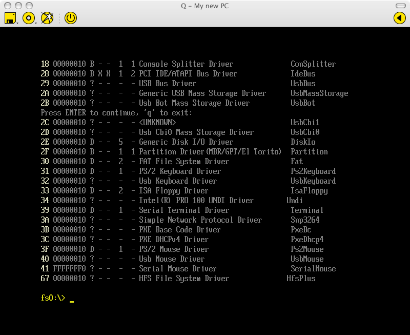

~Neo Posted July 30, 2006 Share Posted July 30, 2006 Great work man! But how can I mount my OS X install dvd? The driver is successfully loaded (see screen) Link to comment https://www.insanelymac.com/forum/topic/17917-archive-macefix86-2006-archive/page/4/#findComment-152404 Share on other sites More sharing options...
Urbz Posted July 30, 2006 Share Posted July 30, 2006 just type "map" and you'll see a list of all the drives in the virtual environment. The drives themselves are known as blk0, 1, 2, 3, etc. The filesystems mounted from the drives are fs0, 1, 2, etc. To mount a blk as an fs, just type "mount *blk of cd drive* *unused fs # of your choice*. It should tell you it forced the mount ok, and then just type the fs with the new number, followed by a colon, and you should be able to browse the dvd with the dir and cd commands. hey bofors, i'm not home right now, but i printes out some handles. I am assuming that the only useful handles are the "image" ones: the ones that use the image protocol. The others are either blank and do nothing, or point to devices, and are not drivers or programs themselves. I jst need a number. I think i went over the images and it cam out to like 112 handles...or 113. Is that pretty much correct? Link to comment https://www.insanelymac.com/forum/topic/17917-archive-macefix86-2006-archive/page/4/#findComment-152460 Share on other sites More sharing options...
