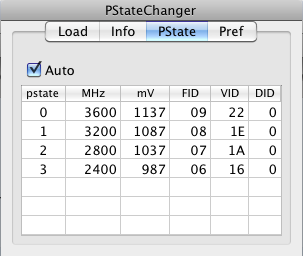

spacr Posted January 31, 2010 Share Posted January 31, 2010 Excellent result with so low temp.I am using GA-EP45-UD3L with Intel E8400 like yours. However I am seeing an idle temp of 51C and 60C at max load. I would like to try out your DSDT. Would appreciate if you can upload it here. TQ I also have a really good aftermarket cpu cooler. You can try my dsdt, Blackosx posted it above. It wont work if you dont have the same overclocking settings though. So be careful you dont mess up your system Link to comment https://www.insanelymac.com/forum/topic/177497-guide-using-dsdt-with-the-gigabyte-ga-ep45-ds3l/page/22/#findComment-1400337 Share on other sites More sharing options...

helob Posted February 1, 2010 Share Posted February 1, 2010 I also have a really good aftermarket cpu cooler. You can try my dsdt, Blackosx posted it above. It wont work if you dont have the same overclocking settings though. So be careful you dont mess up your system Hi, I have tried Blackosx dsdt with modified PState for E8400 CPU. Since you are using E8400, I like to know what PState data you are using based on PStateChanger. TQ Link to comment https://www.insanelymac.com/forum/topic/177497-guide-using-dsdt-with-the-gigabyte-ga-ep45-ds3l/page/22/#findComment-1401036 Share on other sites More sharing options...
spacr Posted February 1, 2010 Share Posted February 1, 2010 Hi,I have tried Blackosx dsdt with modified PState for E8400 CPU. Since you are using E8400, I like to know what PState data you are using based on PStateChanger. TQ Link to comment https://www.insanelymac.com/forum/topic/177497-guide-using-dsdt-with-the-gigabyte-ga-ep45-ds3l/page/22/#findComment-1401075 Share on other sites More sharing options...
helob Posted February 1, 2010 Share Posted February 1, 2010 Hi Spacr, Thanks for providing Pstates table for yout E8400. Since I am not using OC, I can't used those values. Thank you anyway Link to comment https://www.insanelymac.com/forum/topic/177497-guide-using-dsdt-with-the-gigabyte-ga-ep45-ds3l/page/22/#findComment-1401345 Share on other sites More sharing options...
