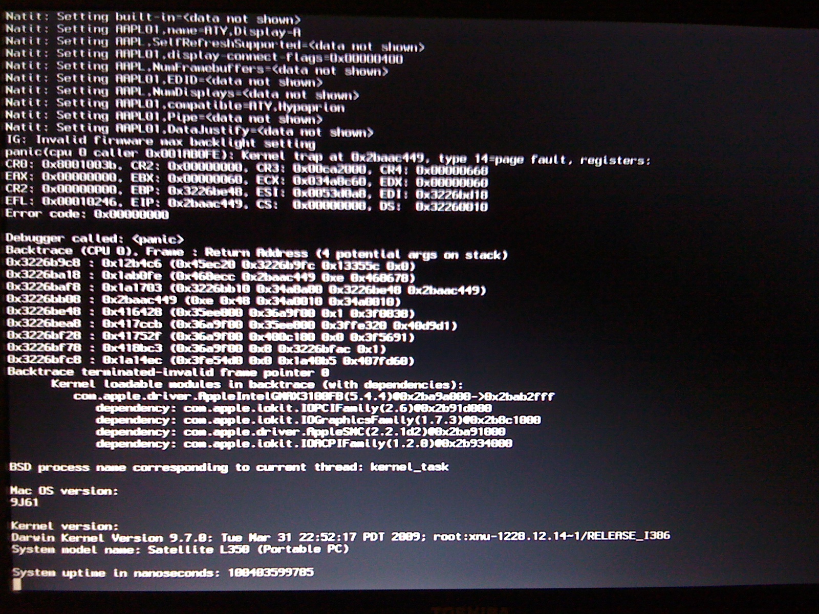

Klutsh Posted July 30, 2009 Share Posted July 30, 2009 I took the x3100 and @0 values from the kext posted here: http://www.hackint0sh.org/forum/f133/16193.htm and placed them the Unkown dict. Replacing @0 with AAPL01. This has resulted in a kernel panic. I'll post a log and the natit kext once back on a pc with Internet access. I did leave the EDID as it is in the above kext though. I did note that in the kernel panic AppleIntelGMAX3100FB.kext is in the backtrace this is the original kext not the patched one. Also since my initial corrupting on the mouse cursor using natit I've not been able to do it again. Edit: Attached natit.kext Attached image of kernel panic. Edit2: Attached natit.kext-nopanic -> does not cause kernel panic, valued changed was <key>built-in</key> Attached system.log from natit.kext-nopanic boot -> still results in kernel[0]: display: Not usable Where do I find logs of kernel panics? Natit.kext.zip Natit.kext_nopanic.zip system.log.zip Link to comment https://www.insanelymac.com/forum/topic/173338-gma-x4500/page/6/#findComment-1213522 Share on other sites More sharing options...

GP1138 Posted July 31, 2009 Share Posted July 31, 2009 Even though the patch script renames the kexts, it doesn't change the names inside the kexts or inside the plists. So it could be referring to the 2a42AppleIntelGMAX3100FB.kext. But to be sure, could you try moving the AppleIntelGMAX3100FB.kext to AppleIntelGMAX3100FB.kext.orig. Same for AppleIntelGMAX3100.kext. And then try again. Also it's strange that one of the values being set is ATY something or other. I thought that was only for ATI cards. Leopard is supposed to log panics to /Library/Logs/PanicReporter, but i never get any there. I've heard that the logging of kernel panics can't really be done on OSx86. On real Macs, the kernel panic gets dumped to NVRAM and is later written to the /Library/Logs/PanicReporter directory on reboot. -u About the random 7s-- it was worth a try. Video cards issues can also cause bad characters to appear. I've attached the ipc firewire-mount fix and uuid fixes. They are packages, so you should be able to install them easily. Remember to boot with -f (clear the cache) and -v (so you can check your logs to see if the errors go away). -u Those pkgs didn't work, I still get the Firewire GUID invalid messages. I don't mind though, it's totally cool, I appreciate the try. I'll ignore them for now. I probably should not press my luck, I'm glad I have this much working. Link to comment https://www.insanelymac.com/forum/topic/173338-gma-x4500/page/6/#findComment-1214368 Share on other sites More sharing options...
