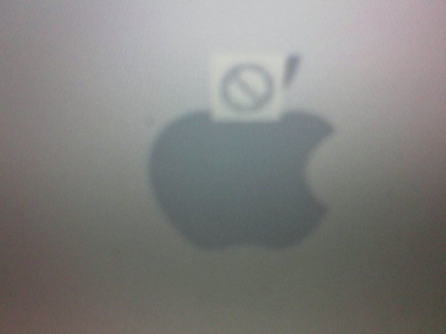

highlift Posted April 28, 2006 Share Posted April 28, 2006 Ok, I installed Jas version, got the b0 error, set my partition as active, reboot, OSX started to load. I get the grey screen with teh MAC emblem and then ticking status bar, after about 3 minutes, i get this symbol above the MAC sign. it doesnt go any further. What should I do? Installing this on a Dell D600, 40gb HDD, 512mb RAM, ATI Radeon 32mb, Link to comment https://www.insanelymac.com/forum/topic/16202-getting-a-circle-with-a-slash-in-it-when-booting-see-pic/ Share on other sites More sharing options...
aquanutz Posted April 28, 2006 Share Posted April 28, 2006 In all my days with OS X (since it's conception) I've never seen that. I suggest reinstalling but NOT formatting the drive. In options, just do a back up and install. Link to comment https://www.insanelymac.com/forum/topic/16202-getting-a-circle-with-a-slash-in-it-when-booting-see-pic/#findComment-104253 Share on other sites More sharing options...
greenman100 Posted April 28, 2006 Share Posted April 28, 2006 Same here, dual xeon, prestonia cores, I didnt get a B0 error though Link to comment https://www.insanelymac.com/forum/topic/16202-getting-a-circle-with-a-slash-in-it-when-booting-see-pic/#findComment-104279 Share on other sites More sharing options...
greenman100 Posted April 28, 2006 Share Posted April 28, 2006 appears to be an infamous "still waiting for root device" error Link to comment https://www.insanelymac.com/forum/topic/16202-getting-a-circle-with-a-slash-in-it-when-booting-see-pic/#findComment-104312 Share on other sites More sharing options...
XNT Posted April 28, 2006 Share Posted April 28, 2006 I expirienced this screen when i didnt have a correct patched DVD so maybe something to do with that? Link to comment https://www.insanelymac.com/forum/topic/16202-getting-a-circle-with-a-slash-in-it-when-booting-see-pic/#findComment-104318 Share on other sites More sharing options...
greenman100 Posted April 28, 2006 Share Posted April 28, 2006 I'm using 10.4.6.install.dvd.iso, have applied no patches, is this wrong? Link to comment https://www.insanelymac.com/forum/topic/16202-getting-a-circle-with-a-slash-in-it-when-booting-see-pic/#findComment-104470 Share on other sites More sharing options...
chromatoner Posted April 28, 2006 Share Posted April 28, 2006 this happened to me to ,but it was because i didnt check the customize instalation button in the beggining i just installed doing: -continue continue, continue........ i didnt check what was being installed Link to comment https://www.insanelymac.com/forum/topic/16202-getting-a-circle-with-a-slash-in-it-when-booting-see-pic/#findComment-104596 Share on other sites More sharing options...
TheG2 Posted April 29, 2006 Share Posted April 29, 2006 I get this error before I even get to the installer for 10.4.6. Go figure...anyhow, I'm running an AMD64 and I figure my problem might lie in there somewhere. Link to comment https://www.insanelymac.com/forum/topic/16202-getting-a-circle-with-a-slash-in-it-when-booting-see-pic/#findComment-104616 Share on other sites More sharing options...
staticuxo Posted April 29, 2006 Share Posted April 29, 2006 i've gotten this once before when i forgot to have my hdd as master and dvd drive as slave. that fixed it for me d: give it a whirl. Link to comment https://www.insanelymac.com/forum/topic/16202-getting-a-circle-with-a-slash-in-it-when-booting-see-pic/#findComment-104633 Share on other sites More sharing options...
greenman100 Posted April 29, 2006 Share Posted April 29, 2006 this happened to me to ,but it was because i didnt check the customize instalation button in the beggining i just installed doing:-continue continue, continue........ i didnt check what was being installed This was it for me.. Works like a champ now. I checked SSE2 and the intel stuff, for my dual xeon setup Link to comment https://www.insanelymac.com/forum/topic/16202-getting-a-circle-with-a-slash-in-it-when-booting-see-pic/#findComment-104661 Share on other sites More sharing options...
Colonel Posted April 29, 2006 Share Posted April 29, 2006 it has something to do with that "waiting for root device" error. try one of the guides to fix it. Link to comment https://www.insanelymac.com/forum/topic/16202-getting-a-circle-with-a-slash-in-it-when-booting-see-pic/#findComment-104662 Share on other sites More sharing options...
indy138 Posted April 30, 2006 Share Posted April 30, 2006 I had the same problem when I tried to install it natively on my AMD64 laptop. Then I tried to install it using the VMWare method, and it works Link to comment https://www.insanelymac.com/forum/topic/16202-getting-a-circle-with-a-slash-in-it-when-booting-see-pic/#findComment-105288 Share on other sites More sharing options...
rlepage Posted April 30, 2006 Share Posted April 30, 2006 sources : - DVD Drive in which the OSX media is is not primary slave - DVD Drive in which the OSX media is is not secondary master Link to comment https://www.insanelymac.com/forum/topic/16202-getting-a-circle-with-a-slash-in-it-when-booting-see-pic/#findComment-105392 Share on other sites More sharing options...
CheetinCheetah Posted October 30, 2006 Share Posted October 30, 2006 For the purpose of people searching on this "circle with a slash" logo problem, I'm going to add: That error logo pertaining to "waiting for root device" that you've just seen is called a Prohibitory Sign, as stated under Apple's Knowledge Base (Small FYI, don't bash me on it. Hopefully Google will index this or something) Link to comment https://www.insanelymac.com/forum/topic/16202-getting-a-circle-with-a-slash-in-it-when-booting-see-pic/#findComment-220258 Share on other sites More sharing options...
xp3nd4bl3 Posted October 30, 2006 Share Posted October 30, 2006 sources : - DVD Drive in which the OSX media is is not primary slave - DVD Drive in which the OSX media is is not secondary master That was it for me. Made the DVD drive Secondary Master and it went away. Link to comment https://www.insanelymac.com/forum/topic/16202-getting-a-circle-with-a-slash-in-it-when-booting-see-pic/#findComment-220359 Share on other sites More sharing options...
Soündless Posted October 30, 2006 Share Posted October 30, 2006 configure your hard drive as ide in bios, it fixed it for me Link to comment https://www.insanelymac.com/forum/topic/16202-getting-a-circle-with-a-slash-in-it-when-booting-see-pic/#findComment-220363 Share on other sites More sharing options...
3on Posted October 30, 2006 Share Posted October 30, 2006 I had this error before and it was, if I remmember well, because I wasn't selecting the good patch (I was selecting all of them beside the ones I need ^^) during the installation. Link to comment https://www.insanelymac.com/forum/topic/16202-getting-a-circle-with-a-slash-in-it-when-booting-see-pic/#findComment-220402 Share on other sites More sharing options...
Shredplayer Posted October 31, 2006 Share Posted October 31, 2006 happened to me when i turned off ACPI in the BIOS. Link to comment https://www.insanelymac.com/forum/topic/16202-getting-a-circle-with-a-slash-in-it-when-booting-see-pic/#findComment-220536 Share on other sites More sharing options...
Wenle Z. Posted October 31, 2006 Share Posted October 31, 2006 yep, i get the b0 error too. but i'm using the 10.4.6DVD, and i get this picture too. Link to comment https://www.insanelymac.com/forum/topic/16202-getting-a-circle-with-a-slash-in-it-when-booting-see-pic/#findComment-220547 Share on other sites More sharing options...
trav1085 Posted October 31, 2006 Share Posted October 31, 2006 I'm using 10.4.6.install.dvd.iso, have applied no patches, is this wrong? Correct me if I'm wrong, but he said he didn't apply any of the patches during the install. I'm sure that will be a problem. You have to select the right patches, select the Intel ones if you, well, have an Intel CPU, and AMD, if you have a, well, AMD CPU. And then ONLY the SSE2 patch or SSE3 (not BOTH if you have both) selected. Link to comment https://www.insanelymac.com/forum/topic/16202-getting-a-circle-with-a-slash-in-it-when-booting-see-pic/#findComment-220548 Share on other sites More sharing options...
