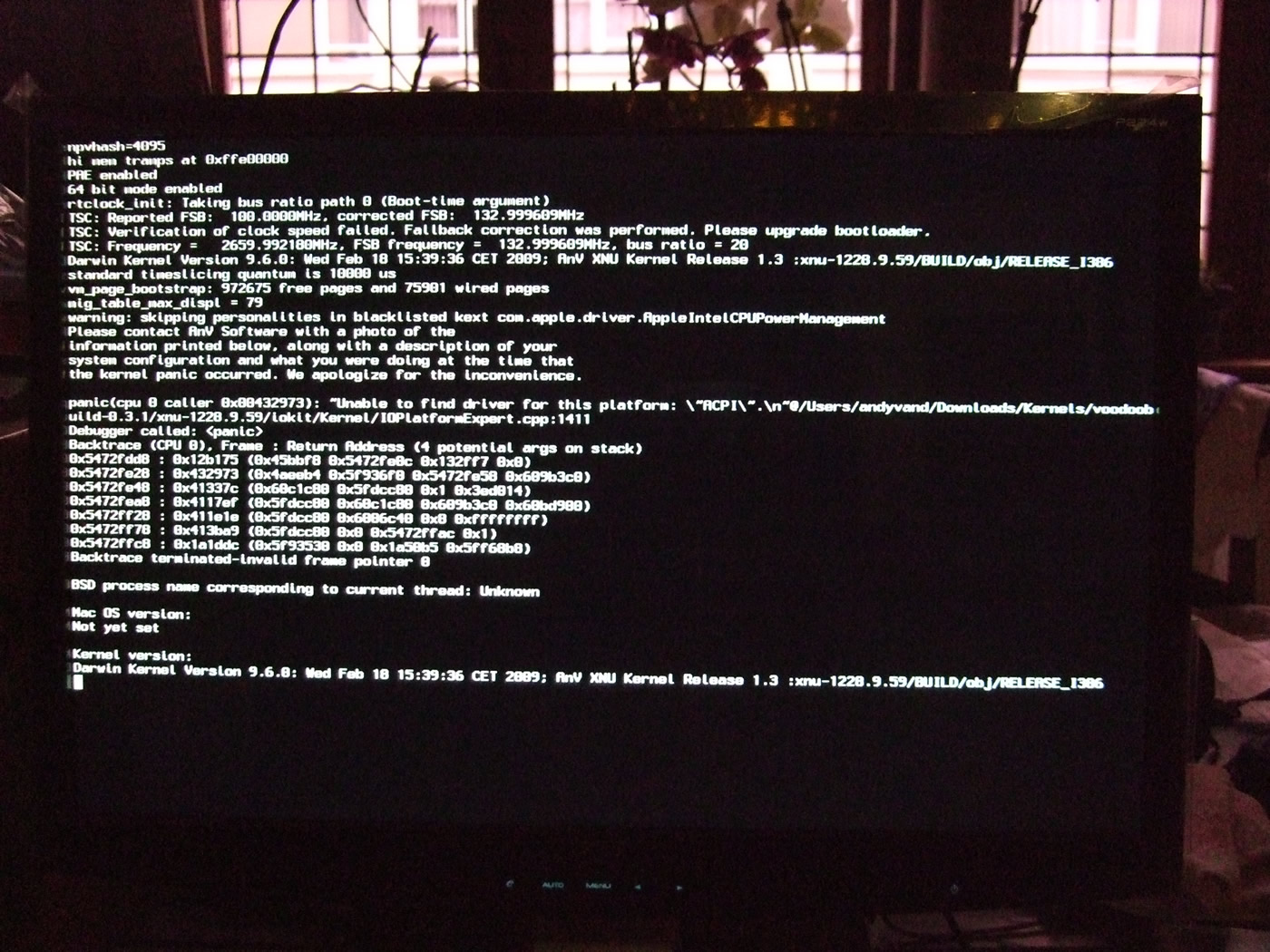

Daft Wullie Posted May 2, 2009 Share Posted May 2, 2009 Ok, so on my (store bought) 10.5.6 copy, there is no System/Library/Installation/Packages/OSInstall.mpkg it's System/Installation/Packages/OSInstall.mpkg Anyway, the installation froze... It says: "Installing Base System" "Validating package" can't even move the mouse around Ok, the dsdt patcher did not only speed up boottime something incredible but also fixed the frozen OS problem :-D I followed the entire guide, but can't boot into the leopard install. Here's what I did: everything in yardie's guide except for ethernet and sound I used his kext package and the voodoo kernel. I also replaced the system.kext twice... first time with the one in his archive and then with the one that came with voodoo kernel. At the chameleon menu when I choose to boot into Vanilla (in verbose mode) I get a quick flash of text and the menu just pops up again... I can't read the text, it goes too fast, but I can make out boot and plist (I did replace the com.apple.Boot.plist) I also did these: Copy the Voodoo mach_kernel to the root of Vanilla. Put the kexts I include into the Extensions folder. Run the PC_EFIv9 installer to set Vanilla as the default drive. Run the ATI 3650 Package to get special kexts for the 3650 and Natit.kext. Put the DSDT.aml file into the root of Vanilla Put the com.apple.Boot.plist into /Volumes/Vanilla*/Library/Preferences/SystemConfiguration Any thoughts? Link to comment https://www.insanelymac.com/forum/topic/151117-guide-installing-leopard-on-dell-studio-xps-i7/page/4/#findComment-1146598 Share on other sites More sharing options...
Daft Wullie Posted May 3, 2009 Share Posted May 3, 2009 ok, i'm officially stuck :'( I can't boot into vanilla. With Yardie's com.apple.Boot.plist installed, all I get is a quick flash and the screen goes right back to the chameleon menu (regardless of the boot options used). With the original com.apple.Boot.plist installed, I get a bit further when using -x or -f , but the result is an almost immediate reboot of the system. FYI, I have the exact same setup (HD3650 256mb, 4gig ram, 500gig HD, HD audio, etc.) Anybody? OK, found it. mach_kernel.voodoo of course... sorry for being such a noob ;-) get a kernel panic on acpi now, will deal with that tomorrow. Link to comment https://www.insanelymac.com/forum/topic/151117-guide-installing-leopard-on-dell-studio-xps-i7/page/4/#findComment-1147336 Share on other sites More sharing options...
Yardie Posted May 6, 2009 Author Share Posted May 6, 2009 ok, i'm officially stuck :'( I can't boot into vanilla. With Yardie's com.apple.Boot.plist installed, all I get is a quick flash and the screen goes right back to the chameleon menu (regardless of the boot options used). With the original com.apple.Boot.plist installed, I get a bit further when using -x or -f , but the result is an almost immediate reboot of the system. FYI, I have the exact same setup (HD3650 256mb, 4gig ram, 500gig HD, HD audio, etc.) Anybody? OK, found it. mach_kernel.voodoo of course... sorry for being such a noob ;-) get a kernel panic on acpi now, will deal with that tomorrow. Hi DW: Can you tell me where in the boot process it stops. ACPI error can be just about anything, bad kernel, bad DSDT.aml or AppleACPIPlatform.kext. I tried to use the vanilla 9.6.3 kernel from a Mac Pro 2009 and I had KPs so I stuck with my voodoo kernel. After the 10.5.7 update I'll give it another try. Link to comment https://www.insanelymac.com/forum/topic/151117-guide-installing-leopard-on-dell-studio-xps-i7/page/4/#findComment-1149743 Share on other sites More sharing options...

Daft Wullie Posted May 14, 2009 Share Posted May 14, 2009 Hi DW: Can you tell me where in the boot process it stops. ACPI error can be just about anything, bad kernel, bad DSDT.aml or AppleACPIPlatform.kext. I tried to use the vanilla 9.6.3 kernel from a Mac Pro 2009 and I had KPs so I stuck with my voodoo kernel. After the 10.5.7 update I'll give it another try. Hi Yardie, Here's a screenshot. Still trying to get past this kernel panic... Link to comment https://www.insanelymac.com/forum/topic/151117-guide-installing-leopard-on-dell-studio-xps-i7/page/4/#findComment-1156372 Share on other sites More sharing options...

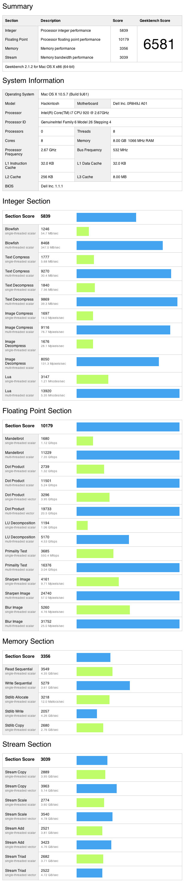

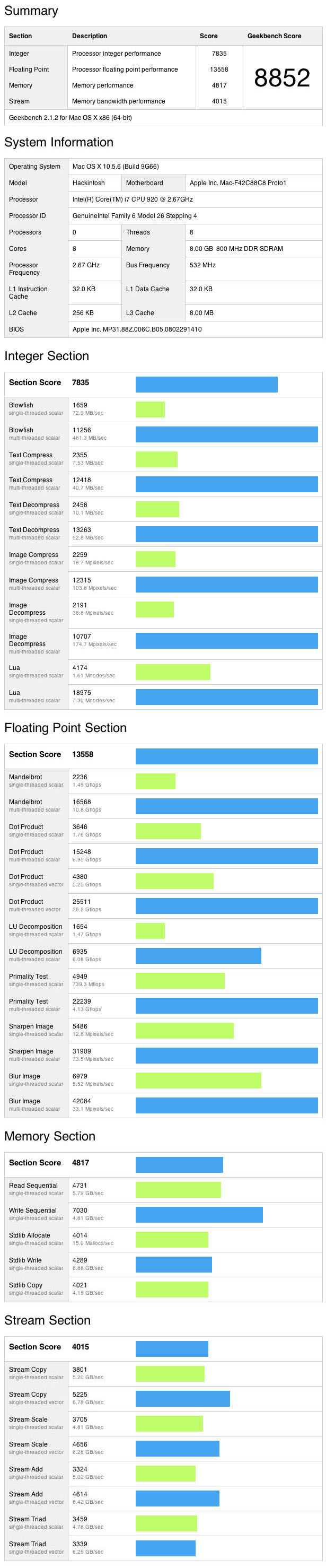

titelio Posted May 25, 2009 Share Posted May 25, 2009 Geekbench test performace has decreased in 10.5.7 I install leopard 10.5.7 in other partition and run fine, but the Geekbench test performace has decreased considerably compared to 10.5.6. Geekbench 64bit test: 10.5.6: 8852 10.5.7: 6581 Does anyone know why? Link to comment https://www.insanelymac.com/forum/topic/151117-guide-installing-leopard-on-dell-studio-xps-i7/page/4/#findComment-1163102 Share on other sites More sharing options...
