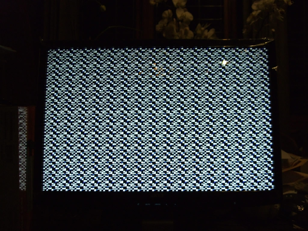

chipset Posted March 23, 2009 Share Posted March 23, 2009 @lun_IX, chipset, Have you guys had any issues getting the 48x0 drivers running properly on the Vanilla install? Last week I ordered the Sapphire Radeon HD 4870 1GB and popped it in the computer this weekend. I booted into my vanilla install and to no surprise I got a flash of blue then a blank screen. I booted into safe mode and installed the drivers and removed the EFI strings and rebooted with -f (dvi2vga adapter in second port, monitor in first port) with the same results. I figured heck, what do I have to lose, let me try installing it on my iAtkos (rescue) partition. Installed in iAtkos, rebooted, works perfectly without dvi2vga adapter, QE/CI enabled and everything. I think I will wait until 10.5.7 is released before trying to get the drivers working again in the Vanilla install. Call me naieve, but since the new Vanilla kernel will support i7 natively as well as the 4800 series of ATI cards, we shouldn't have to install special drivers. One thing to note is that the iAtkos kernel at boot time is "custom", whereas I am using Voodoo 9.6.0 "mach_kernel.voodoo" for my Vanilla install... methinks there is a slight difference in how the kext is addressed. @all Sound Making some progress getting sound working. The Vanilla AppleHDA.kext was patched using Taruga's AppleHDA Patcher 1.20 with a codec dump produced from Mandriva Linux. I just need to get the HDAEnabler.kext patched with the right pinconfig. Once I have that working I will see what I can do to integrate it with DSDT.aml Power Supply One thing I noticed this weekend is that the power supply is adequate only for stock stuff and is only good for running apps that don't draw too much power. I booted into Vista and fired up Crysis with the new card. A few seconds after it started rendering the scene in 1280x1024 at high detail, 4xAA, the computer just powered off, no warning whatsoever. I tried it a few more times and it did the same thing. I had a spare 500W PS lying around and figured I'd give that a try. Worked like a charm! If you plan on doing anything graphic intensive and plan on having more than one HDD in the computer, please upgrade your power supply! I noticed a few differences on the video card. I am using the 4850, so it may be a bit different. On mine, I had to change the port it used to display the graphics. I am not completely thrilled as the card didn't offer a 1920x1200 resolution, which is native for my 24" Samsung. So, I am running 1600x1200, which is a little distorted. My card has two DVI and one SVideo out. I am using a DVI to VGA adapter as the MBP is using the DVI connection. As for the PS, I knew it would be an issue. I am driving two drives on mine without a problem. I plan on upgrading it one day. And good luck on the sound. Link to comment https://www.insanelymac.com/forum/topic/151117-guide-installing-leopard-on-dell-studio-xps-i7/page/3/#findComment-1113680 Share on other sites More sharing options...
lun_IX Posted March 23, 2009 Share Posted March 23, 2009 @WilliamsEph97: Will try to find some time to get my brain spill out all the steps i did to get up and running. @teddiesmooth: I installed the Ati drivers from my iATKOS installation, not directly running the vanilla. Also you might try to use the second DVI port for the monitor and put the adapter on the 1st port. That worked for me. Regarding the power supply: Yeah, it's a bit on the weak side providing 360 watts. But how did you manage to connect your 4870, doesn't it need to 6-pin power connections? My system is working quite fine with two HDDs. So a 2nd HDD should be fine in any case. But if you manage to patch the audio kext's that'd be awesome! Good luck with that! @chipset: Maybe you should plug your MacBook to the VGA Port and the Hack to the DVI... that way you should be able to get both systems running at the native resolution. Link to comment https://www.insanelymac.com/forum/topic/151117-guide-installing-leopard-on-dell-studio-xps-i7/page/3/#findComment-1113707 Share on other sites More sharing options...
teddiesmooth Posted March 23, 2009 Share Posted March 23, 2009 @teddiesmooth:I installed the Ati drivers from my iATKOS installation, not directly running the vanilla. Also you might try to use the second DVI port for the monitor and put the adapter on the 1st port. That worked for me. I'll have to give it a try tonight. Regarding the power supply: Yeah, it's a bit on the weak side providing 360 watts. But how did you manage to connect your 4870, doesn't it need to 6-pin power connections? My system is working quite fine with two HDDs. So a 2nd HDD should be fine in any case. I had ordered a SATA power to 4-pin adapter with the card and used one of the two PCI-e power connectors that came with the vid card. It boggles my mind that Dell decided not to put regular 4-pin connectors with their PS. But if you manage to patch the audio kext's that'd be awesome! Good luck with that! It pains me to keep rebooting the computer every time I make a change to the HDEnabler.kext but I feel as though it's a necessary evil. I am not confident that HDAEnabler.kext can be loaded properly with kextload. Link to comment https://www.insanelymac.com/forum/topic/151117-guide-installing-leopard-on-dell-studio-xps-i7/page/3/#findComment-1113790 Share on other sites More sharing options...

chipset Posted March 24, 2009 Share Posted March 24, 2009 @chipset:Maybe you should plug your MacBook to the VGA Port and the Hack to the DVI... that way you should be able to get both systems running at the native resolution. I would, but my Mac is the new MBP with the Mini Display Port. I don't feel like buying another adapter to run VGA (as the DVI connector cannot be used with a DVI2VGA adapter). That, and 10.5.7 should be out soon with native support for the 4850. That will solve my issue. Only one known issue for 10.5.7. Link to comment https://www.insanelymac.com/forum/topic/151117-guide-installing-leopard-on-dell-studio-xps-i7/page/3/#findComment-1114554 Share on other sites More sharing options...
Daft Wullie Posted March 24, 2009 Share Posted March 24, 2009 Ok, so I decided to give it a try. Did everything the way you described without natit.kext and graphics update. First install goes ok but then after reboot I get the gray screen with apple logo and revolving timer icon for about 5-10 minutes before the screen turns to attached image and system freezes... I left it for a while, since you mentioned you thought yours had crashed, but nothing happened after 20 mins. Is this a graphics issue? I'll try with some other options. You never know... V Link to comment https://www.insanelymac.com/forum/topic/151117-guide-installing-leopard-on-dell-studio-xps-i7/page/3/#findComment-1114760 Share on other sites More sharing options...
chipset Posted March 25, 2009 Share Posted March 25, 2009 Ok, so I decided to give it a try.Did everything the way you described without natit.kext and graphics update. First install goes ok but then after reboot I get the gray screen with apple logo and revolving timer icon for about 5-10 minutes before the screen turns to attached image and system freezes... I left it for a while, since you mentioned you thought yours had crashed, but nothing happened after 20 mins. Is this a graphics issue? I'll try with some other options. You never know... V The logo pause is a known issue and there's a fix. Once you are set, you can update the system. See the first post, it talks about a pause. There's a patch (DSDT) that must be run to get rid of the pause. Yes, that's a graphics issue. However, you aren't going to be able to do much with those graphics. If you can, try booting into safe mode. I believe that option is -f at the boot options screen. Link to comment https://www.insanelymac.com/forum/topic/151117-guide-installing-leopard-on-dell-studio-xps-i7/page/3/#findComment-1114903 Share on other sites More sharing options...
lun_IX Posted March 25, 2009 Share Posted March 25, 2009 You have two options now: 1. Boot into your iATKOS install, and install the graphics driver onto your vanilla system. 2. Boot your vanilla into failsafe-mode, using the "-x" option and then directly install the graphics update. After a reboot it should be fine. If it still doesn't work try switching the DVI2VGA Adapter and the DVI-Monitor-Cable. I've had the same garbled screen and finally got it working, so no worries! Wish you best of luck! Link to comment https://www.insanelymac.com/forum/topic/151117-guide-installing-leopard-on-dell-studio-xps-i7/page/3/#findComment-1115006 Share on other sites More sharing options...

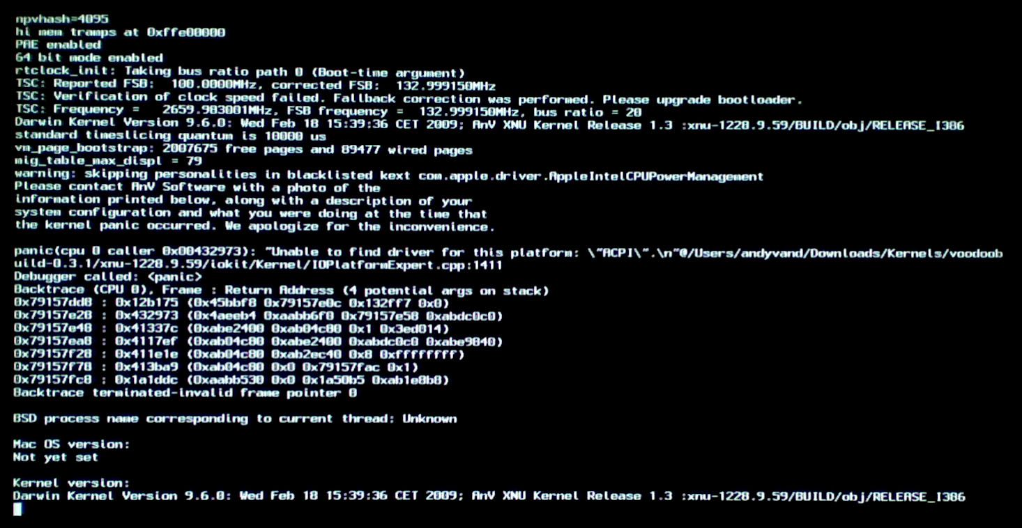

titelio Posted March 25, 2009 Share Posted March 25, 2009 Panic kernel. I have Dell Studio XPS with 8gb Ram and Ati Radeon 4850. After installing everything using the steps in this guide, I have the following problem: How can I fix it. Link to comment https://www.insanelymac.com/forum/topic/151117-guide-installing-leopard-on-dell-studio-xps-i7/page/3/#findComment-1115763 Share on other sites More sharing options...
teddiesmooth Posted March 26, 2009 Share Posted March 26, 2009 Hey all, I have some promising news on the sound front. I am able to get the kext loaded and have the proper inputs and outputs showing up in the sound pref pane and in the System Profiler. However, I cannot get sound out of any of the ports. I think it can be traced back to how the codec address is described in the dump from Mandriva. Maybe OSX uses ATI as address 2 and the onboard as address 0? I am hoping someone here has a sound system with an S/PDIF optical input to test this out. I do not get any sound unfortunately. I am switching the pin config to codec address 0 and seeing what kind of results I get. Cross your fingers and toes! ALC888kexts_beta.zip Link to comment https://www.insanelymac.com/forum/topic/151117-guide-installing-leopard-on-dell-studio-xps-i7/page/3/#findComment-1115884 Share on other sites More sharing options...
lun_IX Posted March 26, 2009 Share Posted March 26, 2009 Panic kernel. I have Dell Studio XPS with 8gb Ram and Ati Radeon 4850. After installing everything using the steps in this guide, I have the following problem: How can I fix it. Try replacing the ACPI related kexts. I think i've had the exact same problem using the kext's from digital_dreamers package. After changing them to the one's provided by Yardie it just worked. Or maybe it was the other way round? Yardie's didn't work, but digital_dreamer's?! Mhm, can't remember... just try both. @teddiesmooth: How am i supposed to get to work now? With toes and fingers crossed... damn. Should call my boss. Link to comment https://www.insanelymac.com/forum/topic/151117-guide-installing-leopard-on-dell-studio-xps-i7/page/3/#findComment-1115959 Share on other sites More sharing options...
titelio Posted March 26, 2009 Share Posted March 26, 2009 Try replacing the ACPI related kexts.I think i've had the exact same problem using the kext's from digital_dreamers package. After changing them to the one's provided by Yardie it just worked. Or maybe it was the other way round? Yardie's didn't work, but digital_dreamer's?! Mhm, can't remember... just try both. @teddiesmooth: How am i supposed to get to work now? With toes and fingers crossed... damn. Should call my boss. I made the changes and does not work Link to comment https://www.insanelymac.com/forum/topic/151117-guide-installing-leopard-on-dell-studio-xps-i7/page/3/#findComment-1116091 Share on other sites More sharing options...

lun_IX Posted March 26, 2009 Share Posted March 26, 2009 I made the changes and does not work Did you try replacing all the kext's? Link to comment https://www.insanelymac.com/forum/topic/151117-guide-installing-leopard-on-dell-studio-xps-i7/page/3/#findComment-1116309 Share on other sites More sharing options...
teddiesmooth Posted March 26, 2009 Share Posted March 26, 2009 Teddie, Good luck on the sound. I don't have one or I would try it for you. No worries. The speaker setup I have are an older (2002?) Boston Acoustic S/PDIF RCA connector type that I had received from my uncle after he got his iMac in '04 (and became useless for his computer). Great speakers but no optical input so they're pretty much useless with this PC. Luckily my monitor has audio input that works well and I have some headphones to test out with. Link to comment https://www.insanelymac.com/forum/topic/151117-guide-installing-leopard-on-dell-studio-xps-i7/page/3/#findComment-1116390 Share on other sites More sharing options...
titelio Posted March 26, 2009 Share Posted March 26, 2009 Did you try replacing all the kext's? Do not install correctly the "ketxs". This resolved and now works perfectly. Thanks. What driver you installed for the video card? And you sound card works? Link to comment https://www.insanelymac.com/forum/topic/151117-guide-installing-leopard-on-dell-studio-xps-i7/page/3/#findComment-1116467 Share on other sites More sharing options...
