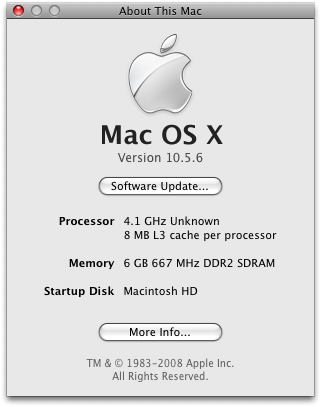

jrhende Posted April 15, 2009 Share Posted April 15, 2009 EX85-UD5 on vanilla kernel now a reality Guys I'm so excited, it seems I have managed to install and boot my Hackintosh with the vanilla Apple i7 kernel I managed to get my hands on a OS X install disk that comes with the new i7 MacPro. I made an image of it and tried the installation. Kernel on the disk is 9.6.3. 1. I booted from working OS X 10.5.5 installation, logged in as root 2. Installed OSX from install disk that comes with MacPro i7. I left "Printer Drivers", "Additional Fonts" and "Language Translations" out of the installation to minimize installation time and used space. 3. Removed /System/Library/Extensions/AppleIntelCPUPowerManagement.kext and /System/Library/Extensions/AppleHDA.kext 4. Copied my modified com.apple.boot.plist to /Library/Preferences/SystemConfiguration 5. Copied dsmos.kext, RealtekR1000.kext, AppleHDA.kext and HDAEnabler.kext from Digital Dreamers Kext package (GA-EX58-UD5_Kexts.zip) to /System/Library/Extensions 6. Installed Chameleon 2.0-rc431 7. Deleted /System/Library/Extensions.mkext - QE/CI, sound and network all work. - Shutdown quits OS X but motherboard power sometimes stays on (fans continue spinning). I removed AppleIntelCPUPowerManagement.kext because it causes a Kernel Panic in boot with the error message: panic (cpu 0 caller 0x76FC3460): "No HPETs available.. CPU(s) configured incorrectly/n"0/SourceCache/AppleIntelCPUPowerManagement I tried playing with HPET and power management options in the bios but this did not prevent AppleIntelCPUPowerManagement crashing, so I just removed the kext. I'm a bit new to this OSx86 stuff so I'm not sure what kinds of modifications Chameleon makes to the system, but this is very promising I just installed the system, so I have not yet much experience with it. In the attached Archive.zip is system.log, com.apple.boot.plist, and a couple of pictures. You can see that System Preferences / Power Management icon has been changed. Hey, the log shows that your firewire device is enabled. Nice! Tom's HW has new 920 OC'ing guide. Appears that the optimal sweet spot is 3.66GHz. Link to comment https://www.insanelymac.com/forum/topic/149505-guide-retail-os-x-install-1058-on-gigabyte-ga-ex58-ud5-core-i7-mobo/page/29/#findComment-1133587 Share on other sites More sharing options...
