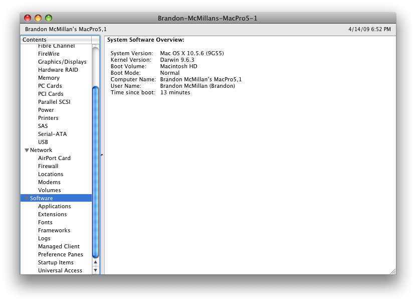

Guys I'm so excited, it seems I have managed to install and boot my Hackintosh with the vanilla Apple i7 kernel :)
I managed to get my hands on a OS X install disk that comes with the new i7 MacPro. I made an image of it and tried the installation. Kernel on the disk is 9.6.3.
1. I booted from working OS X 10.5.5 installation, logged in as root
2. Installed OSX from install disk that comes with MacPro i7. I left "Printer Drivers", "Additional Fonts" and "Language Translations" out of the installation to minimize installation time and used space.
3. Removed /System/Library/Extensions/AppleIntelCPUPowerManagement.kext and /System/Library/Extensions/AppleHDA.kext
4. Copied my modified com.apple.boot.plist to /Library/Preferences/SystemConfiguration
5. Copied dsmos.kext, RealtekR1000.kext, AppleHDA.kext and HDAEnabler.kext from Digital Dreamers Kext package (GA-EX58-UD5_Kexts.zip) to /System/Library/Extensions
6. Installed Chameleon 2.0-rc431
7. Deleted /System/Library/Extensions.mkext
- QE/CI, sound and network all work.
- Shutdown quits OS X but motherboard power sometimes stays on (fans continue spinning).
I removed AppleIntelCPUPowerManagement.kext because it causes a Kernel Panic in boot with the error message: panic (cpu 0 caller 0x76FC3460): "No HPETs available.. CPU(s) configured incorrectly/n"0/SourceCache/AppleIntelCPUPowerManagement
I tried playing with HPET and power management options in the bios but this did not prevent AppleIntelCPUPowerManagement crashing, so I just removed the kext.
I'm a bit new to this OSx86 stuff so I'm not sure what kinds of modifications Chameleon makes to the system, but this is very promising :)
I just installed the system, so I have not yet much experience with it.
In the attached Archive.zip is system.log, com.apple.boot.plist, and a couple of pictures. You can see that System Preferences / Power Management icon has been changed.
Cool stuff. Thanks for that. Now, we know what's in store rather shortly.
I'm surprised they don't have the "About this Mac" info strings recognizing the board's Core i7. Looks like it'll still need to be hacked.
Anybody else see all those certificates in the log?!
Did you have a DSDT patch installed, or did it work without it?
So, the new MacPros are running a modified version of 10.5.6, then?
I wonder if 10.5.7 will have a 9.7 kernel? If so, there are still more changes on the way.

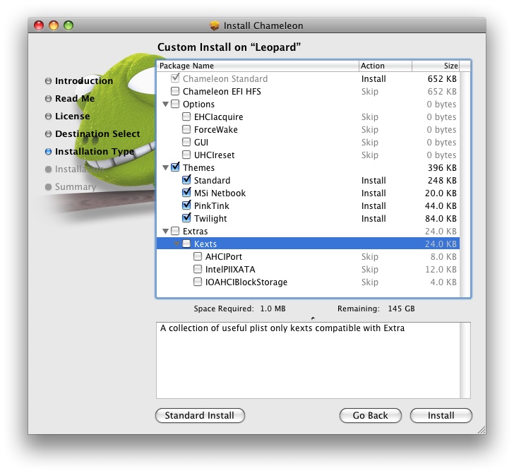

1. I didn't do any DSDT patching myself, so if Chameleon didn't somehow do it, no DSDT patch needed.
2. Yep
- I did all available updates from Apple, so far no problems.
- Tried sleep once, it worked
- Shutdowned a couple of times and it seemed work ok now
- I did a couple of new test installs. At first used Chameleon default settings, but then I noticed this installs some (S)ATA drivers. After this I installed Chameleon without these drivers, and now my internal sata disks are seen as removable drives, but no problems though.
Here is my system profiler info and a picture of Chameleon settings I used when installing it.

Ok, so I have been waiting for someone to post this....and nobody did, so I took matters into my own hands
and with out further ado....
mach_kernel 9.6.3 and it does work on the i7 just make sure you have disabler.kext and appledecrypt.kext
edit: link was broken sorry.
http://rapidshare.com/files/221439525/mach_kernel.zip
http://rapidshare.com/files/221395339/mach_kernel.zip.html
