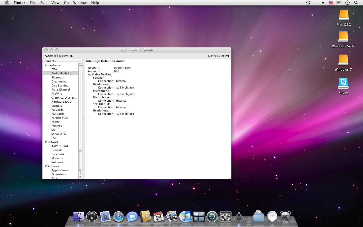

ADDmin Posted February 24, 2009 Share Posted February 24, 2009 It's my experience I do kext like this 1. Delete AppleHDA.kext:sudo rm -rf /System/Library/Extensions/AppleHDA.kext 2. Edit AppleAzaliaAudio.kext for matching codec's proper ID: sudo vi /System/Library/Extensions/AppleAzaliaAudio.kext/Contents/Info.plist in Realtek ALC663 Codec Driver key change the string to: <string>0x your card ide </string> 3. Edit AppleAzaliaController.kext for matching ICH9 HDA interface proper ID: sudo vi /System/Library/Extensions/AppleAzaliaAudio.kext/Contents/PlugIns/AppleAzaliaController.kext/Contents/Info.plist Search for (use hotkey= ctrl + w): <key>IOPCIPrimaryMatch</key> change the string to: <string>0x № </string> № - find like this: start mac calculator with programer write ide and clik Dec 4. Refresh kext caches sudo rm /System/Library/Extensions.kextcache kextcache -k /System/Library/Extensions/ 5. reboot I do like this but not work sound but in the system I see this when I install this kext: http://www.megaupload.com/?d=H3VU1AQ1 some ideas? Link to comment https://www.insanelymac.com/forum/topic/144423-the-holy-alc663-problem-solving-thread/page/2/#findComment-1089814 Share on other sites More sharing options...
