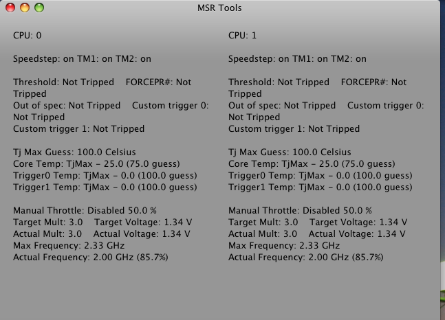

Intel Quad Core Q9300 showing -1892 and something like -1290 This was reported also in post: #65, #69, #72 and #80 Can this bug please be fixed a.s.a.p.? With help of Info.plist maybe? Thanks!
Note: System Profiler reports a bus Speed of 1.61GHz BTW.
EDIT: Apparently the application has been depreciated, so how do I get to see any of the values without the application?
EDIT 2: Using the normal/stock speed shows the 2GHz as 2003MHz, which is pretty accurate, but 2.5Ghz is still displayed as some negative value.

I testes version 1.2.1 with
sergeys-macpro31:~ sergey$ ./vpower c
Kernel Extension Name: VoodooPower.kext
		  Version: 1.2.1 Release Jan  4 2009 15:06:44
			  CPU: 2x Intel(R) Core(TM)2 CPU		  6300  @ 1.86GHz
	   Technology: Intel Core Desktop/Server [000006f6]
		 P-States: P00 FID 07 DID 00 VID 28
				 : P01 FID 06 DID 00 VID 28
sergeys-macpro31:~ sergey$ ./vpower f
CPU0 1998004812
CPU1 1998004812
It is overclocked from native 1,86 to 333x7=2,33GHz
Old version of GenericCPUPM doesn't work at all.

I'm experiencing extreme cpu temperature which exceed ~75O Celsius when it in full load. This happen when I'm using firefox & yahoo messenger but not always. This is the combination of kexts that I think responsible to the high temp:-
- AppleIntelCPUPowerManagement.kext + VoodooPower.kext (1.2.1)
It also true with VoodooPower version 1.2.2. I have to manually disable "Auto Throttle" to maintain lower cpu frequency but this effect the performance.
Right now I have disabled AppleIntelCPUPowerManagement.kext using IntelCPUPMDisabler.kext. I'm also using version 1.2.3 of VoodooPower.kext. So far so good.

I have to agree with you about the temperature bug, I have an increase of 15C with VoodooPower 1.2.3 :)
I have to agree with you about the temperature bug, I have an increase of 15C with VoodooPower 1.2.3 :blink:
Update: The temperature went back to normal, it looks like Time Machine make the temperature go up dramatically :) VoodooPower 1.2.3 is fine, I think is normal.
