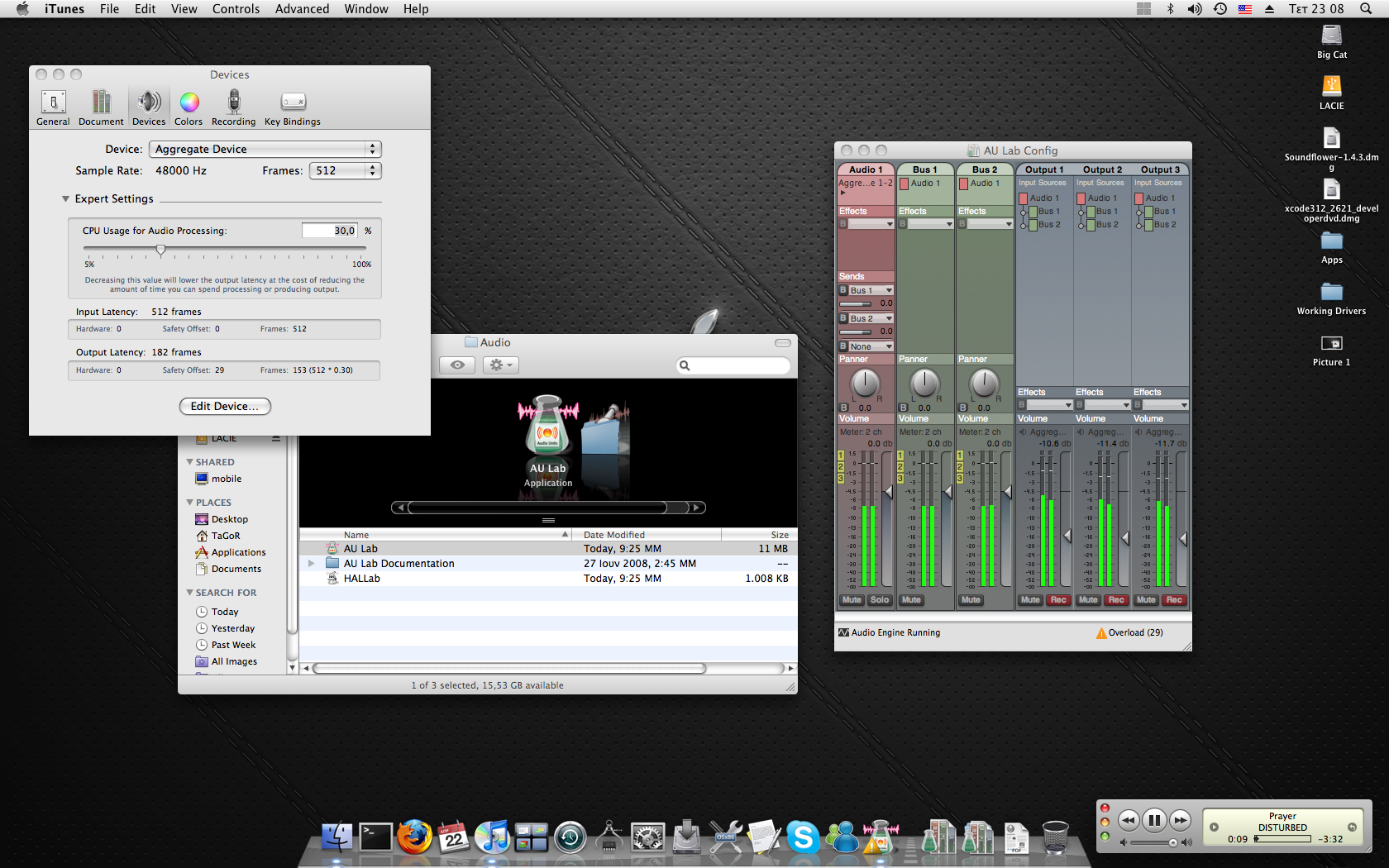

Cheezmen Posted August 14, 2009 Share Posted August 14, 2009 Thank you for the guide macgirl. Oxtie, I have the same problem than you. I'm using the 1.30b version of the drivers for my sound blaster audigy platinum ex card (Emu10k1). Try raising the latency Link to comment https://www.insanelymac.com/forum/topic/143510-how-to-have-sound-on-all-of-your-speakers/page/2/#findComment-1225928 Share on other sites More sharing options...
finrold Posted August 14, 2009 Share Posted August 14, 2009 Try raising the latency Hi, I raised the latency but it didn't work. I decreased the latency from 512 to 24 frames and now it works flawlessly Link to comment https://www.insanelymac.com/forum/topic/143510-how-to-have-sound-on-all-of-your-speakers/page/2/#findComment-1225953 Share on other sites More sharing options...

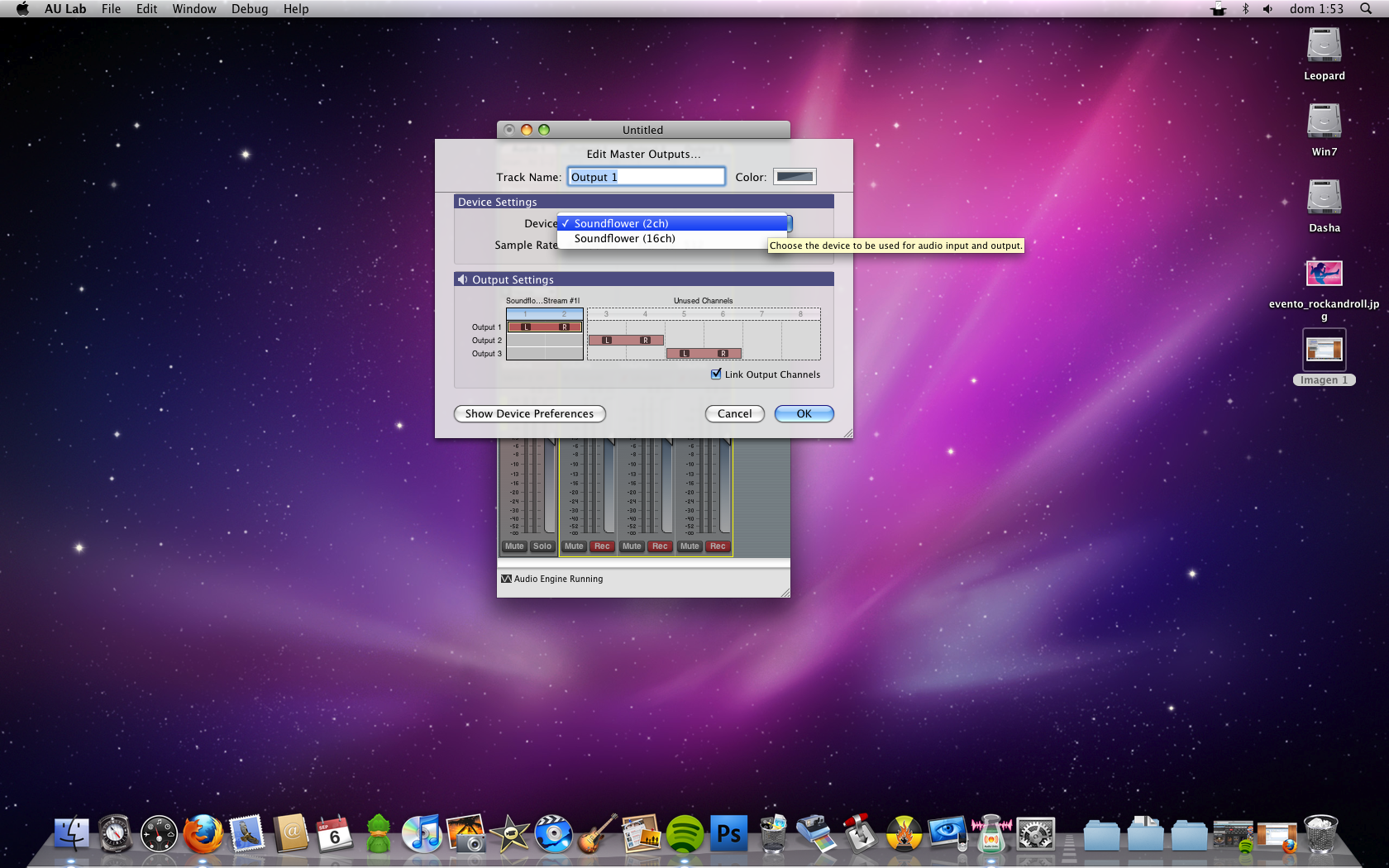

tetsuo2es Posted September 5, 2009 Share Posted September 5, 2009 i can't get this to work. when I make my agg. dev. in audio midi setup, I select my SB0350 10k2 (0 in, 8 out) and the soundflower 2chan (2in 2 out). In the box above where the name is, the agg dev still shows 0 in 8 out. So i go to au lab, i add 3 stereo outputs and 1 stereo input. i select my agg dev "6chanout" as the audio device while "output channels" is selected. It looks fine, shows 6 of 8 channels being used. then i select input channels, it shows my 6chanout device still selected as the audio device, and "Audio input not supported". so if i choose the soundflower 2chan here, i see stereo input, but then the output channels only show stereo out. If i hit "done" with my 6chanout agg dev selected, I have no inputs in the next window. If i select the soundflower 2ch, then 2 of the 3 output channels are not used, and I get no sound output too. what am i missing? how do i pick my 6chanout as the output, and soundflower 2ch as the input? +1!!!!! same problem & configuration, and hope ......and after this.....the stereo 5.1 channel(in my case)doesn't appears optional in my output options to place like a output channel(pic): thx again,anyway.....can someone help? pd.:sorry my poor english XD Link to comment https://www.insanelymac.com/forum/topic/143510-how-to-have-sound-on-all-of-your-speakers/page/2/#findComment-1253299 Share on other sites More sharing options...
dakku Posted November 11, 2009 Share Posted November 11, 2009 after i double click on output 1, i dont see my aggregate device there, only soundflower. can someone help? Link to comment https://www.insanelymac.com/forum/topic/143510-how-to-have-sound-on-all-of-your-speakers/page/2/#findComment-1327854 Share on other sites More sharing options...
troe666 Posted January 7, 2010 Share Posted January 7, 2010 I had distortion after random 3 - 10 minutes but it was totally fixed not by latency setting but simply by changing Clock Source from internal to The SB Audigy sound card. did this in Audio & MIDI. No more distortion now and sounds wonderful even after hours. Thanks again for this guide. Just going to set mine to start up minimised at login now and away I go. Trav Link to comment https://www.insanelymac.com/forum/topic/143510-how-to-have-sound-on-all-of-your-speakers/page/2/#findComment-1378921 Share on other sites More sharing options...

Hardflip Posted May 10, 2010 Share Posted May 10, 2010 +1!!!!! same problem & configuration, and hope ......and after this.....the stereo 5.1 channel(in my case)doesn't appears optional in my output options to place like a output channel(pic): thx again,anyway.....can someone help? pd.:sorry my poor english XD after i double click on output 1, i dont see my aggregate device there, only soundflower.can someone help? Same here. I tried many different configurations. Sometimes i can see the green bars moving when i play music in itunes, but theres no sound. I'm using 1.11b (audigy 2 zs) driver for snow leopard(10.6.3) and i can get full sourrund sound with a 5.1 source in vlc. Any Ideas? Link to comment https://www.insanelymac.com/forum/topic/143510-how-to-have-sound-on-all-of-your-speakers/page/2/#findComment-1465567 Share on other sites More sharing options...
