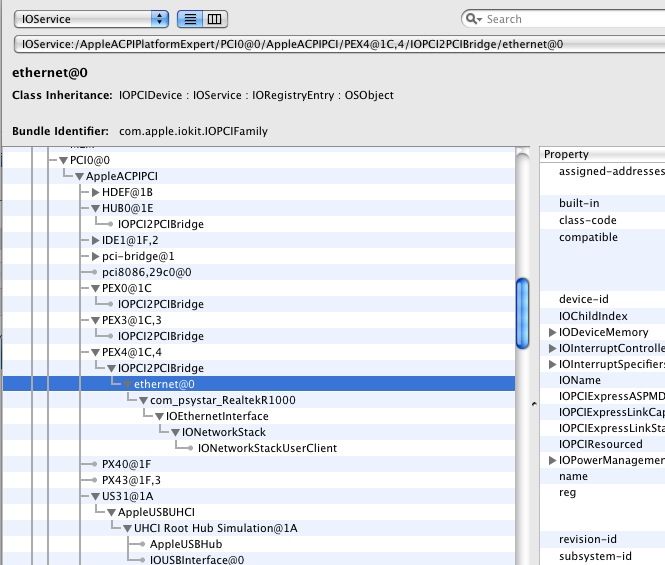

mitch_de Posted January 7, 2009 Share Posted January 7, 2009 Question about fixing LAN (Timemachine fix) patch function- i think that makes same as setting LAN to internal by EFI string. What must i select in the device tab of LAN ? There are some PCI ,.... (all 3 charact) things i must select one of them. How can i find out what i must set - using an running+working OS X Leo. I can see that there is such PEX4@1C,4 shown in the IOREGISTERYEXPLORER (screenshoot added( which belongs to lan/ethernet device. What , if tools doesnt work , can i manual change/add to do same (LAN/TM fix) ? Thanks Part of my orig. GA-EP35-DS3 dsdt PEX4 Device (PEX4) { Name (_ADR, 0x001C0004) Method (_STA, 0, NotSerialized) { Return (0x0F) } Method (_PRW, 0, NotSerialized) { Return (Package (0x02) { 0x09, 0x05 }) } Name (PIC4, Package (0x04) { Package (0x04) { 0xFFFF, 0x00, \_SB.PCI0.LNKA, 0x00 }, Package (0x04) { 0xFFFF, 0x01, \_SB.PCI0.LNKB, 0x00 }, Package (0x04) { 0xFFFF, 0x02, \_SB.PCI0.LNKC, 0x00 }, Package (0x04) { 0xFFFF, 0x03, \_SB.PCI0.LNKD, 0x00 } }) Name (API4, Package (0x04) { Package (0x04) { 0xFFFF, 0x00, 0x00, 0x10 }, Package (0x04) { 0xFFFF, 0x01, 0x00, 0x11 }, Package (0x04) { 0xFFFF, 0x02, 0x00, 0x12 }, Package (0x04) { 0xFFFF, 0x03, 0x00, 0x13 } }) Method (_PRT, 0, NotSerialized) { If (LNot (PICF)) { Return (PIC4) } Else { Return (API4) } } } Link to comment https://www.insanelymac.com/forum/topic/142434-acpi-dsdt-patcher-for-bios-and-aml/page/7/#findComment-1030426 Share on other sites More sharing options...

koalala Posted January 7, 2009 Author Share Posted January 7, 2009 mitch_de, you should select PEX4 as hardware location. If it's not working use the first patcher with network fix (GIGE fix). You can also use Export DSDT option, modify manually and then Import DSDT (it uses dsdt.dsl so no you only need Patcher 0.1.8 or 0.2 with Wordpad). OneSman, I will delete PEGP since it's more compatible. olegpronin, what post you're talking about ? Link to comment https://www.insanelymac.com/forum/topic/142434-acpi-dsdt-patcher-for-bios-and-aml/page/7/#findComment-1030631 Share on other sites More sharing options...

mitch_de Posted January 7, 2009 Share Posted January 7, 2009 mitch_de, you should select PEX4 as hardware location. If it's not working use the first patcher with network fix (GIGE fix).You can also use Export DSDT option, modify manually and then Import DSDT (it uses dsdt.dsl so no you only need Patcher 0.1.8 or 0.2 with Wordpad). OneSman, I will delete PEGP since it's more compatible. olegpronin, what post you're talking about ? Thanks, i will do that and try that fix for TM. So you mean that are two differenr fixes ? (I remember only an extra selectable TM-fix ceckbox. , No GIGE fix) Its very good that your tool also can patch as .aml file, which can redisasemled also. Link to comment https://www.insanelymac.com/forum/topic/142434-acpi-dsdt-patcher-for-bios-and-aml/page/7/#findComment-1030726 Share on other sites More sharing options...
