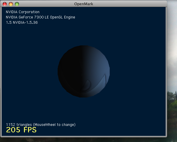

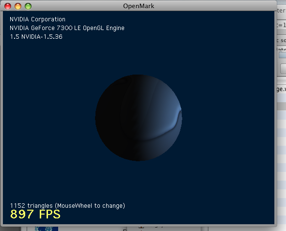

Slice Posted December 16, 2008 Share Posted December 16, 2008 OK! I wait sources too. But what about DSDT patch as for HPET? EDITED With new IOPCIFamily I have big lost of OpenMark while screenshot. With my version 2.4.4 I had score 800. Link to comment https://www.insanelymac.com/forum/topic/141161-1056-pci-device-lost-interrupt/#findComment-1001802 Share on other sites More sharing options...

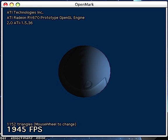

mitch_de Posted December 18, 2008 Share Posted December 18, 2008 This is a working version. Try, please. IOPCIFamily254.kext.zip Thanks !!! Runs good, i can see no problems with that. (For my knowledge that Slice / Andy... modds are do better Interruthandling for us OSX86 users) Q: Without any other doings Openmark spins around 1900 FPS. But doing something (window shift ) goes to 800. Or put other app in foredround dies same. Is that OpenMark FPS down not normal, independed from ioPCI ? Because in that test OpenMark i cant see a major diff in that case using orig. IOPCI and SLice IOPCI. Link to comment https://www.insanelymac.com/forum/topic/141161-1056-pci-device-lost-interrupt/#findComment-1004057 Share on other sites More sharing options...

Slice Posted December 18, 2008 Share Posted December 18, 2008 Thanks !!!Runs good, i can see no problems with that. (For my knowledge that Slice / Andy... modds are do better Interruthandling for us OSX86 users) Q: Without any other doings Openmark spins around 1900 FPS. But doing something (window shift ) goes to 800. Or put other app in foredround dies same. Is that OpenMark FPS down not normal, independed from ioPCI ? Because in that test OpenMark i cant see a major diff in that case using orig. IOPCI and SLice IOPCI. Hi mitch_de! About OpenMark it is marketing trick. Yes, it always slow down. But with my PCI the influence is less. Other users found mouse move more smooth. My IOPCIFamily has no direct influence on any device, it only reorganize whole PCI bus. If it help you - enjoy, if no - don't use. 2All About KernelPanic. Be careful! We can't work with double kext. Don't use it from Extra folder. Delete mkext after replacement. Clear cache. Clear CMOS. Reboot with -f and may be twice after installation to be sure Device Tree and cache updated. Link to comment https://www.insanelymac.com/forum/topic/141161-1056-pci-device-lost-interrupt/#findComment-1004130 Share on other sites More sharing options...

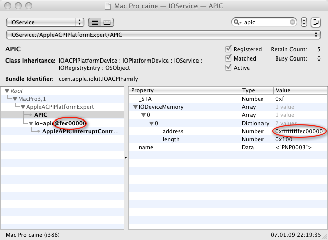

_caine Posted December 27, 2008 Share Posted December 27, 2008 Problem finally solved! All interrupt troubles goes from two copies of APIC - interrupt controller. One is declared in dsdt as PNP0003 device, but AppleAPIC.kext does not recognized it as apic. Second is matched with "io-apic" property and works with kext (see picture). Both uses the same memory area - 0xFEC00000 in my case and seems like conflicts this way. I've removed APIC device code from dsdt and got rid of all the troubles with USB and sound distortions so AppleLPC.kext, AppleHPET.kext and AppleIntelCPUPowerManagement.kext works fine in 10.5.6. Device (APIC) { Name (_HID, EisaId ("PNP0003")) Name (_CRS, ResourceTemplate () { Memory32Fixed (ReadOnly, 0xFEC00000, // Address Base 0x00000100, // Address Length ) }) } Link to comment https://www.insanelymac.com/forum/topic/141161-1056-pci-device-lost-interrupt/#findComment-1016293 Share on other sites More sharing options...
