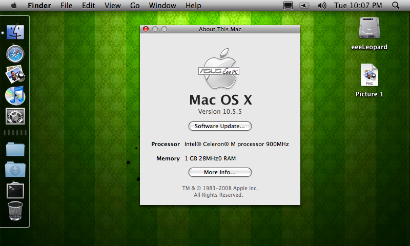

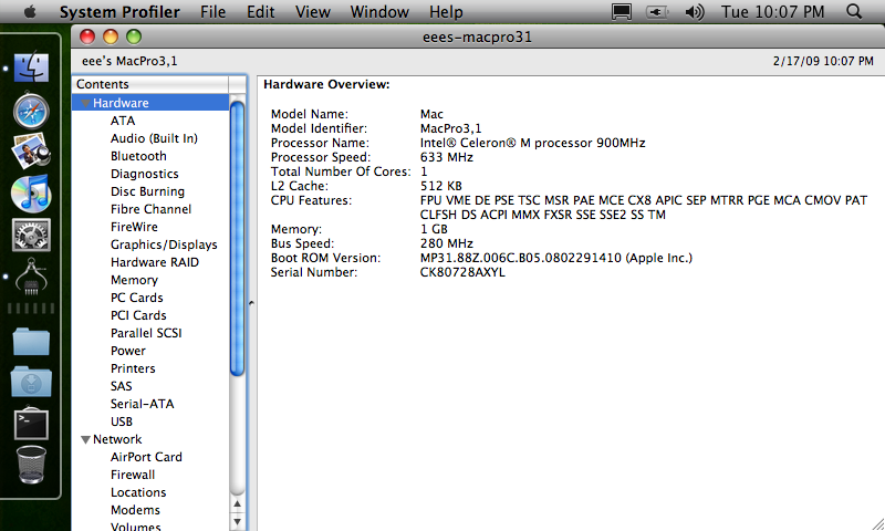

Some screenshots of EeePC 701 running Leopard on the native 4 GB SSD with Voodoo kernel

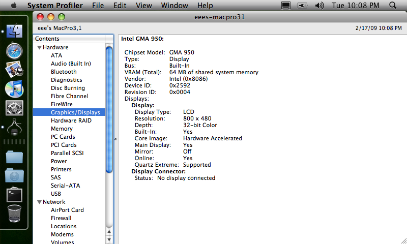

What works : video (including vga out - minor problem once in a while a small artifact, no issues), speakers, battery-awareness (battery time about 1.40 hours), usb devices, shutdown/restart/sleep support (fast too),webcam(though dumped ichat and photobooth), external WL167g_v2 wifi_dongle
Not working : headphone/mic, native wifi, lan
Tweaking in progress... Either way it is a heavily hammered down version ( of course ) Activity monitor does not work (permissions problem? doesn't even fit on the screen so who needs it) but the few applications left run ok

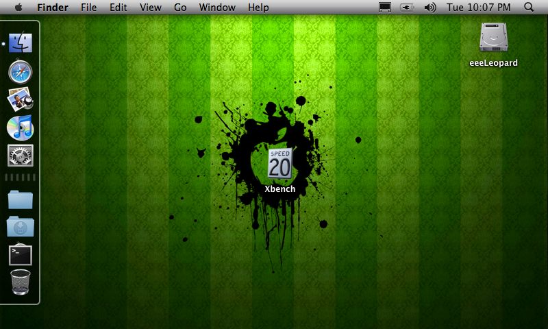

XBENCH result : 22.66 (excluding SSdrive in test - with it is about 16.6) YEAH BABY ! Beat that :P

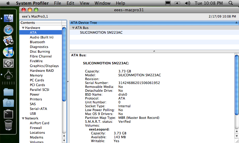

I don't want to release it yet because there is a somewhat serious issue : Internal disk performance is very poor .... xbench disk-only result ~6. I don't get it ... SSD are supposed to be fast as hell, right ?

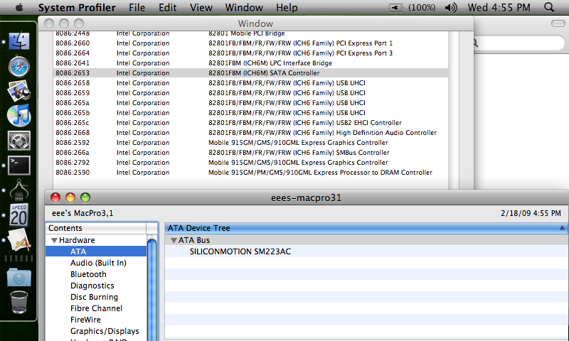

Edit: well it seems that cheap comes with poor quality, seems this is all it can (actually) - checked some benchmarks on windoze and it's about the same... plus it seems the controller is neither a sata nor a usb - it seems it's something in the middle :) it's IDE (PCI detection is bugged)
Attached is a pic of the dcpi output and also of the disk xbench result
i don't want to release it yet because there is a somewhat serious issue ... Edit: I'm starting to xbench result is false due to the little space left (155MB) - most people recommend 10% at least for proper performance..
internal disk performance is rather poor .... xbench disk-only result ~6. I don't get it ... SSD are supposed to be fast as hell, right ? If you can , please help, this is the only thing that needs to be fixed, and then i'll post result on the bay. Strange thing is that the dcpi manager lists a sata controller, but i know 701 4G is soldered in ... that makes it what ??? IDE/SATA ? I've read that the sata version is called 701SD. I don't recall, what is the read/write speed on the windows platform, and how does XP list the disc in device manager ? Thanks
Either way the general speed is ok, but fixing this disk controller should make it fly...
Attached is a pic of the dcpi output and also of the xbench result
