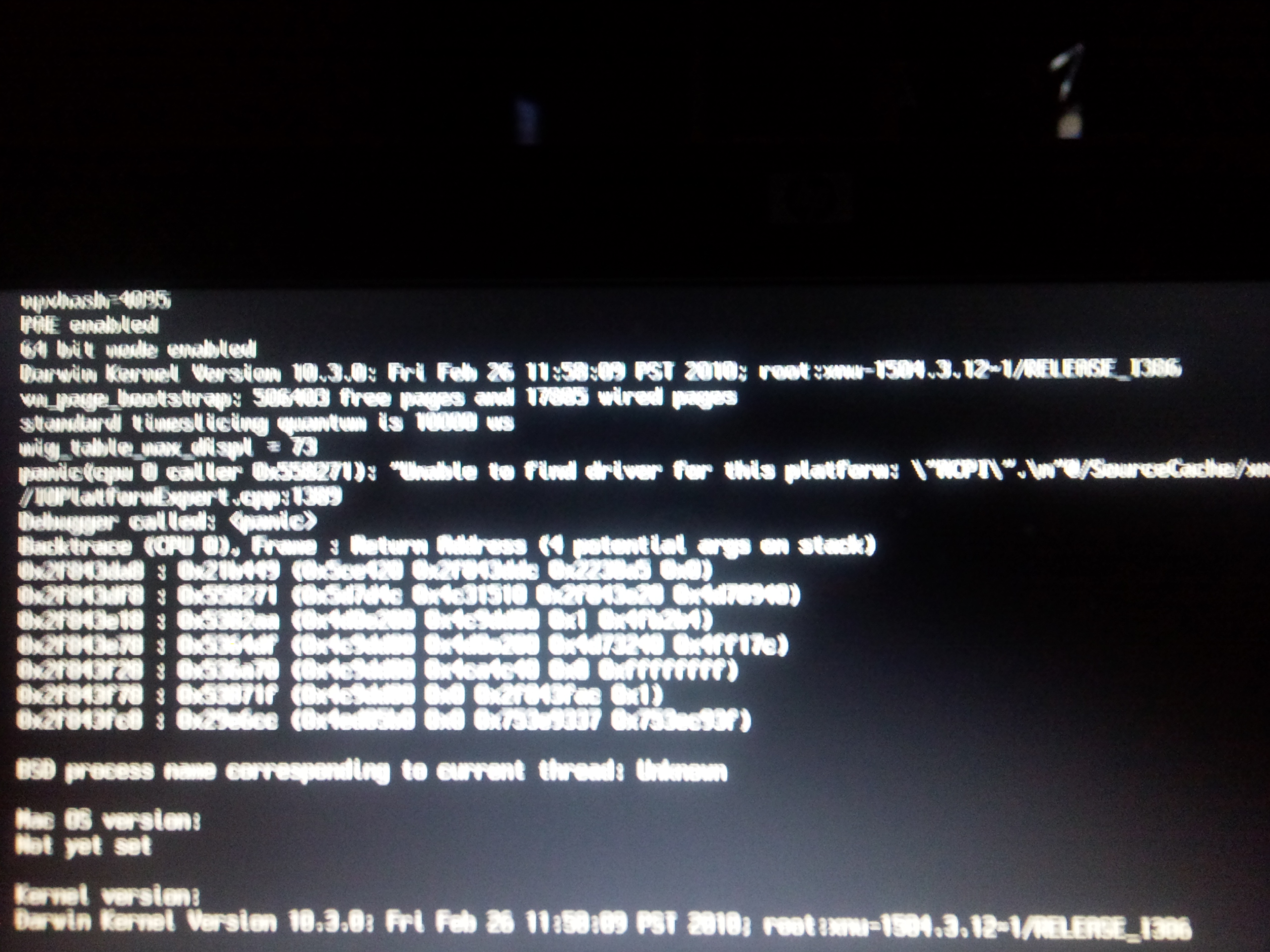

hatim5691 Posted May 30, 2010 Share Posted May 30, 2010 kernel panic I have removed my extra and install the new in the thread with DSDT and add kext to extension i dont now why Link to comment https://www.insanelymac.com/forum/topic/135410-hp-6520s-6720s-6820s-550-sl-install-package/page/18/#findComment-1478710 Share on other sites More sharing options...
BlackCH Posted May 30, 2010 Author Share Posted May 30, 2010 kernel panic I have removed my extra and install the new in the thread with DSDT and add kext to extension i dont now why boot with -f flag, maybe that helps. But, I recommend you to do a re-install with the boot CD from post #1, and follow the instructions on the README file to the letter. Otherwise is difficult to help, 'cos I have to guess many things Link to comment https://www.insanelymac.com/forum/topic/135410-hp-6520s-6720s-6820s-550-sl-install-package/page/18/#findComment-1478777 Share on other sites More sharing options...

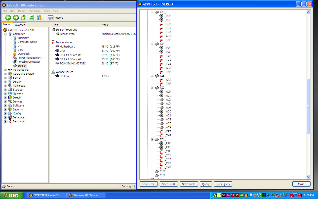

BlackCH Posted May 31, 2010 Author Share Posted May 31, 2010 get the last version (at the moment rev 93) from the topic and install in S/L/E (otherwise it panics). Comment out ALS0 device from the DSDT or you get a lot of errors... The value 'GPU Diode' is locked, but this is in an early state of development Theres some DSDT customizations to do in order to get the ACPI plugin going (I havent try anything yet), and the sensor chip from my 6720s is not yet supported by the LPC plugin... Anyway it looks very promesing! Edit: This code will make the ACPI plugin to load, but yet we need to find the right addreses to do the readings... Device (\_SB.C003.C004.C3D6) { Name (_HID, EisaId ("PNP0C02")) Name (_UID, 0x02) Name (_CID, "monitor") //my addition Name (\_SB.C003.C004.C267, ResourceTemplate () { IO (Decode16, 0x0010, // Range Minimum 0x0010, // Range Maximum 0x01, // Alignment 0x10, // Length ) IO (Decode16, 0x0024, // Range Minimum 0x0024, // Range Maximum 0x01, // Alignment 0x1C, // Length ) IO (Decode16, 0x004E, // Range Minimum 0x004E, // Range Maximum 0x01, // Alignment 0x02, // Length ) IO (Decode16, 0x0050, // Range Minimum 0x0050, // Range Maximum 0x01, // Alignment 0x04, // Length ) IO (Decode16, 0x0063, // Range Minimum 0x0063, // Range Maximum 0x01, // Alignment 0x01, // Length ) IO (Decode16, 0x0065, // Range Minimum 0x0065, // Range Maximum 0x01, // Alignment 0x01, // Length ) IO (Decode16, 0x0067, // Range Minimum 0x0067, // Range Maximum 0x01, // Alignment 0x01, // Length ) IO (Decode16, 0x0074, // Range Minimum 0x0074, // Range Maximum 0x01, // Alignment 0x04, // Length ) IO (Decode16, 0x0090, // Range Minimum 0x0090, // Range Maximum 0x01, // Alignment 0x10, // Length ) IO (Decode16, 0x00A4, // Range Minimum 0x00A4, // Range Maximum 0x01, // Alignment 0x1A, // Length ) IO (Decode16, 0x0500, // Range Minimum 0x0500, // Range Maximum 0x01, // Alignment 0x80, // Length ) IO (Decode16, 0x0800, // Range Minimum 0x0800, // Range Maximum 0x01, // Alignment 0x10, // Length ) Memory32Fixed (ReadOnly, 0xFFB00000, // Address Base 0x00100000, // Address Length ) Memory32Fixed (ReadOnly, 0xFFF00000, // Address Base 0x00100000, // Address Length ) }) OperationRegion (TMIF, SystemMemory, 0xFF800160, 0x20) Field (TMIF, ByteAcc, Lock, Preserve) { THS0, 8, // thermometer, used by Thermal Zone THS1, 8, // unknown sensor THS2, 8, // one more Offset (0x08), FAN1, 8, // FAN, the only one I have Offset (0x10), TSP0, 8, // hot point? TSC0, 8, // critical temperature used by Thermal Zone TSP1, 8, // ?? TSC1, 8 // catastrophic value? } Method (SMC0, 0, NotSerialized) //System FAN0 { Store (FAN1, Local0) Return (Local0) } Method (SMCA, 0, NotSerialized) //CPU heatsink { Store (THS0, Local0) Return (Local0) } Method (SMCB, 0, NotSerialized) //MCH Northbrige { Store (THS1, Local0) Return (Local0) } Method (SMCC, 0, NotSerialized) //AUX sensor { Store (THS2, Local0) Return (Local0) } } My machine has an ADM1021A which is a temperature monitor only, so I guess I cannot read fan speed: http://www.onsemi.com/PowerSolutions/produ...id=ADM1021AARQZ Link to comment https://www.insanelymac.com/forum/topic/135410-hp-6520s-6720s-6820s-550-sl-install-package/page/18/#findComment-1479237 Share on other sites More sharing options...
yushir Posted June 1, 2010 Share Posted June 1, 2010 I'm getting mad at this. I've got speedstep enabled and custom p-states (in fact, i even gave up my p-states and i'm loading blackch's dsdt, who has the same configuration as i do), but my cpu won't change the p-state. It stays always at it's lowest (600 mhz). Please note that if i comment _PSS on CPU's i got my cpu throttling as it should be. Anyone has a clue about this? EDIT: I've been trying brightness and it does simply not solve our problem. What it does is that it lets us to slowly turn off brightness, but it isn't the values it should be. We ought to try tell OS X how our backlight works via DSDT (i posted the fix, but the methods it uses aren't on 6720s DSDT). —EDIT3: Device C1AE = LCD. EDIT2: @BlackCH. I see that in your DSDT you've these p-states among others: on AC 1600@1.0250 and on Battery 1400@1.0375. It's that fine? It's pretty weird that you're ov one p-state and uv another one (well it's just a quest, i may be wrong anycase). EDIT4: You said we can't get to know at which speed is the fan currently running because we do not have any sensor that does the job. But really, we don't need a sensor to do it. That's because we're telling OS X at which speeds the fan can go, so that we must only ask OS X which is the current speed and it'll be done. There's a kext (CpuI.kext) that returns the voltage and the current mhz of the cpu (not exactly but does the job). Link to comment https://www.insanelymac.com/forum/topic/135410-hp-6520s-6720s-6820s-550-sl-install-package/page/18/#findComment-1479772 Share on other sites More sharing options...

yushir Posted June 4, 2010 Share Posted June 4, 2010 Yes, we don't know the actual RPM. But as you said we know the % and we do know the maximum (2500 rpm). We won't get real rpm's, but who cares? We do want the fan speed to simply change it in case we don't like the actual one. Yes, i do have that values but coolbook is reporting me invalid values then. Related what i said on speedstep, do you have any clue why it won't change state when p-states are defined on bios? Link to comment https://www.insanelymac.com/forum/topic/135410-hp-6520s-6720s-6820s-550-sl-install-package/page/18/#findComment-1481922 Share on other sites More sharing options...
BlackCH Posted June 4, 2010 Author Share Posted June 4, 2010 bLACKch what is your cooling method which Kexts are you using because voodoopowermini is not loading after reboots. appreciate if you could advise the best cooling solution.brian We are currently using native speedstep (no extra kexts needed). Read the thread for the guidelines Related what i said on speedstep, do you have any clue why it won't change state when p-states are defined on bios? No Idea. Could be you forgot to uninstall some CPU related kext? Did you try with last juanerson DSDT? I will recheck here, but for how the machine is working I guess the CPU is throttling just fine EDIT: Is working here and the voltage seems right too Link to comment https://www.insanelymac.com/forum/topic/135410-hp-6520s-6720s-6820s-550-sl-install-package/page/18/#findComment-1481940 Share on other sites More sharing options...
yushir Posted June 5, 2010 Share Posted June 5, 2010 In case, do you still have coolbook kext installed? I guess it's the one causing the trouble. Also, have anyone noted that to get sound after sleep we do need to silence volume and then volume up/down. I've always had problems with p-states. Sometimes it stayed at max, sometimes it didn't go down… I'll recheck all my kexts. Link to comment https://www.insanelymac.com/forum/topic/135410-hp-6520s-6720s-6820s-550-sl-install-package/page/18/#findComment-1482781 Share on other sites More sharing options...
