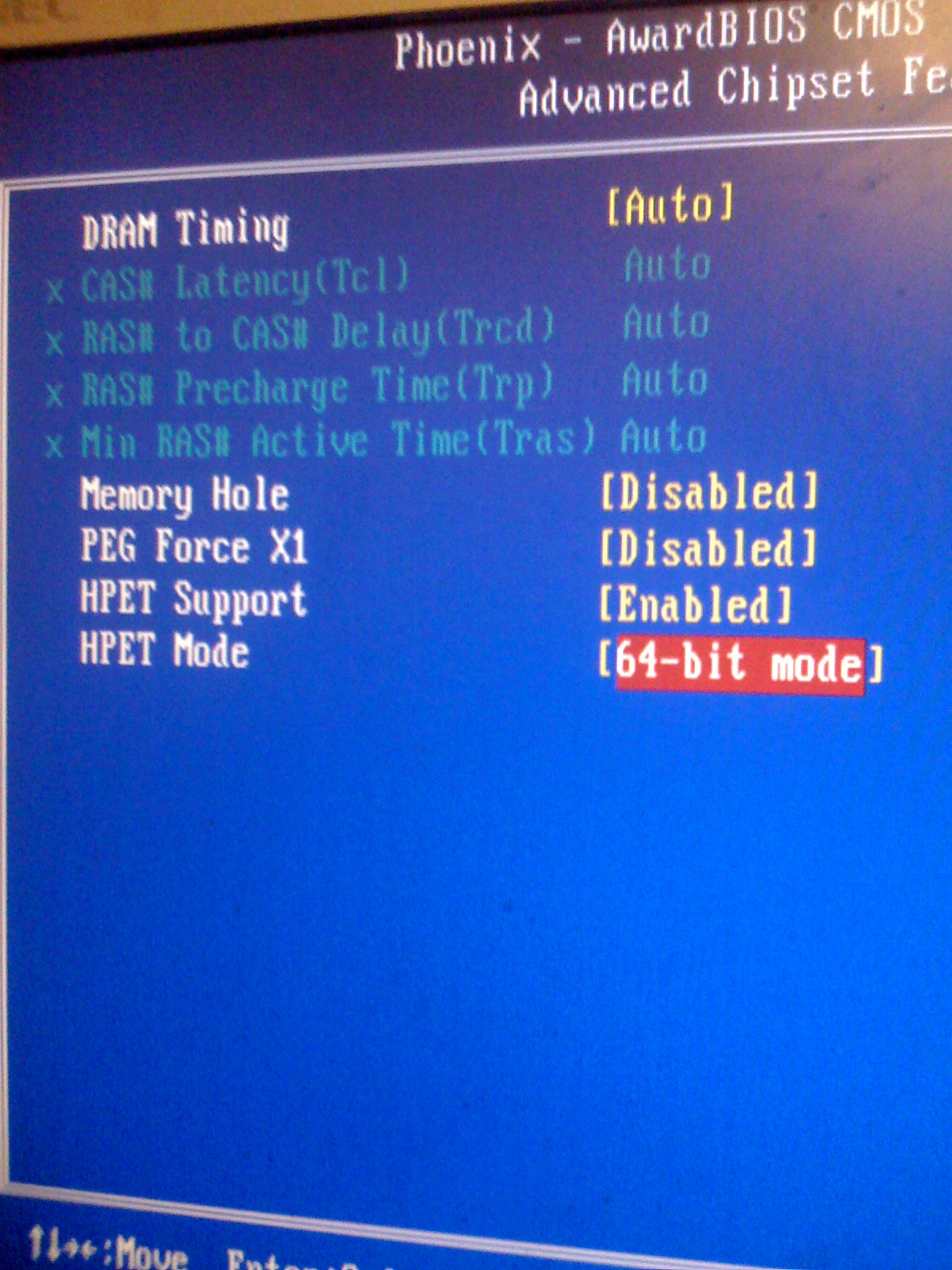

mitch_de Posted November 1, 2008 Share Posted November 1, 2008 Thanks to dev ! I used the debug (newest) and now i could see all - it works and no errors shown. To the HPET user: Do you have HPET in the bios enabled ?(i have also GA-EP35-DS3 (noP). Link to comment https://www.insanelymac.com/forum/topic/132757-chameleon-with-dsdt-override/page/4/#findComment-951342 Share on other sites More sharing options...
relikwie Posted November 1, 2008 Share Posted November 1, 2008 Thanks to dev !I used the debug (newest) and now i could see all - it works and no errors shown. To the HPET user: Do you have HPET in the bios enabled ?(i have also GA-EP35-DS3 (noP). Hi mich_de, yes HPET is enabled in BIOS. Could you maybe post your dsdt? And what patched kexts do you use? -relikwie. Link to comment https://www.insanelymac.com/forum/topic/132757-chameleon-with-dsdt-override/page/4/#findComment-951371 Share on other sites More sharing options...

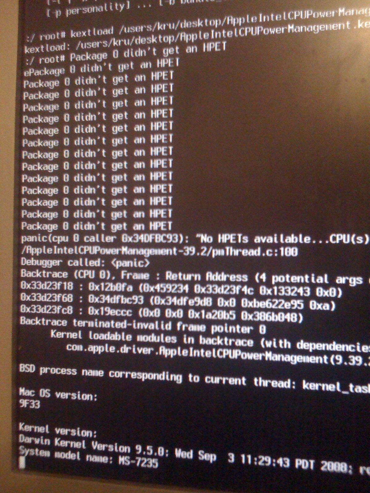

kruteshok Posted November 1, 2008 Share Posted November 1, 2008 Same problems with HPET. I tried DSDT on fully vanilla system! But HPET dont work anyway MSI P965 Neo. Link to comment https://www.insanelymac.com/forum/topic/132757-chameleon-with-dsdt-override/page/4/#findComment-951706 Share on other sites More sharing options...

cparm Posted November 1, 2008 Share Posted November 1, 2008 Same problems with HPET. I tried DSDT on fully vanilla system! But HPET dont work anyway MSI P965 Neo. i have the same problem (Package 0 didn't get an HPET) on my GA-P35-DS3L, but only with the last 1.0.1b version of the patcher this one work for me Link to comment https://www.insanelymac.com/forum/topic/132757-chameleon-with-dsdt-override/page/4/#findComment-951788 Share on other sites More sharing options...
fassl Posted November 1, 2008 Share Posted November 1, 2008 i have the same problem (Package 0 didn't get an HPET) on my GA-P35-DS3L, but only with the last 1.0.1b version of the patcher this one work for me This is because on the first patcher i choosed to overwrite the existing HPET and write a new hardcoded HPET, the newer ones just add IRQ's to your HPET. I will add a function, so you can choose whether you want to modify your existing HPET or overwrite the existing one in the next version. Thanks for pointing that out. Link to comment https://www.insanelymac.com/forum/topic/132757-chameleon-with-dsdt-override/page/4/#findComment-951831 Share on other sites More sharing options...

kruteshok Posted November 2, 2008 Share Posted November 2, 2008 This is because on the first patcher i choosed to overwrite the existing HPET and write a new hardcoded HPET, the newer ones just add IRQ's to your HPET. I will add a function, so you can choose whether you want to modify your existing HPET or overwrite the existing one in the next version. Thanks for pointing that out. Patcher 1.0.1c2 solve my problems! THANKS! Link to comment https://www.insanelymac.com/forum/topic/132757-chameleon-with-dsdt-override/page/4/#findComment-952216 Share on other sites More sharing options...

fassl Posted November 2, 2008 Share Posted November 2, 2008 @All people still suffering "Package 0 didn't received a HPET", use the newest patcher: http://forum.insanelymac.com/index.php?act...st&id=37485 Drag the patcher into terminal and then write -newHPET press enter, your HPET should now work with AppleIntelCPUPowerManagement.kext pls report if it worked or not greetz Link to comment https://www.insanelymac.com/forum/topic/132757-chameleon-with-dsdt-override/page/4/#findComment-952530 Share on other sites More sharing options...
