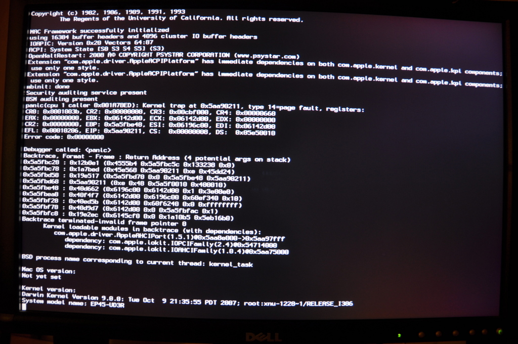

Chromakey Apple Posted February 7, 2009 Share Posted February 7, 2009 hi peach! My system has arrived. I get more and more kernel panic during installation of Kaly 10.5.1... I cannot get it to work. Some ideas? Link to comment https://www.insanelymac.com/forum/topic/132695-daw-based-on-ga-ep45-incl-hardware-list/page/7/#findComment-1072386 Share on other sites More sharing options...
peach-os Posted February 7, 2009 Author Share Posted February 7, 2009 hi peach! My system has arrived. I get more and more kernel panic during installation of Kaly 10.5.1... I cannot get it to work. Some ideas? did you switch to ahci? at which point do you have the panic? is the hardware list still the same you mentioned before? Link to comment https://www.insanelymac.com/forum/topic/132695-daw-based-on-ga-ep45-incl-hardware-list/page/7/#findComment-1072612 Share on other sites More sharing options...
Chromakey Apple Posted February 8, 2009 Share Posted February 8, 2009 Hi peach basically I get kernel paniic during installation of Kaly. The exact point is when the istallation program transfers all the data to my hard disk. SATA is set to AHCI. My config is: 1 x ARCTIC COOLING FREEZER 7 PRO 1 x Cooler Master Cabinet CENTURION 590 1 x LC-POWER Green Power LC6550GP V2.2 550W 1 x Western Digital VelociRaptor 150Gb SATA2 WD1500HLFS 10.000rpm 2 x WESTERN DIGITAL CAVIAR SE16 640GB SATA2 16MB WD6400AAKS 1 x LG DVD±RW 22x GH22NS40 2 x OCZ DDR2 1066Mhz 4GB PC2-8500 Platinum (OCZ2P10664GK) 1 x INTEL CORE 2 QUAD Q9550 2830Mhz 12MB Box 1 x Gigabyte GA-EP45-DS3 1 x XFX 9600GT 512MB DDR3 2DVI 2 x Arctic Cooling 120x120x38 5mm FAN 12 PWM 2 x LG LCD 22" W2242T-PF 5ms 1 x Mac OSX 10.5 Leopard Retail DVD I'm installing Kaly on one of 640Gb Western digital hard drive with two partitions HFS+ Journaled and GUID. After 10-12 installations I've found that motherboard recognize correctly my DDR2 ram clocked at 1066MHz but I've forced to run at 800MHz and the kernel panic is GONE AWAY!!!! After this discover I've correctly installed Kaly, but at reboot my system hangs at some point. (Before switching to graphic mode). So I've reinstalled once again Kaly, selecting only Vanilla Kernel, BUT NO GRAPHIC CARD KEXT. Finally I've rebooted and I get Kaly installed and running!!! This evening I will try to make a retail install of Leopard and then I write feedback on my experience! THANKS A LOT FOR YOUR SUPPORT, seeyou! Link to comment https://www.insanelymac.com/forum/topic/132695-daw-based-on-ga-ep45-incl-hardware-list/page/7/#findComment-1073355 Share on other sites More sharing options...
Chromakey Apple Posted February 9, 2009 Share Posted February 9, 2009 Hi peach! Finally ALL IS WORKING! (with some minor issues). The problem was the RAM timings. I don't know why the motherboard automatically set them wrong... I manually override these setting and all is going fine!! THANK YOU! The only issue I report is that when i go in Stop mode the computer shutdown... Is it normal?? My video card works in 10.5.6 with only EFI string!!! I'm so happy!!! This evening I try to understand more of my system!! Link to comment https://www.insanelymac.com/forum/topic/132695-daw-based-on-ga-ep45-incl-hardware-list/page/7/#findComment-1074485 Share on other sites More sharing options...
peach-os Posted February 9, 2009 Author Share Posted February 9, 2009 Hi peach! Finally ALL IS WORKING! (with some minor issues). The problem was the RAM timings. I don't know why the motherboard automatically set them wrong... I manually override these setting and all is going fine!! THANK YOU! The only issue I report is that when i go in Stop mode the computer shutdown... Is it normal?? My video card works in 10.5.6 with only EFI string!!! I'm so happy!!! This evening I try to understand more of my system!! STOP mode? if you mean SLEEP - read the solution here http://forum.insanelymac.com/index.php?showtopic=76404 Link to comment https://www.insanelymac.com/forum/topic/132695-daw-based-on-ga-ep45-incl-hardware-list/page/7/#findComment-1074731 Share on other sites More sharing options...
