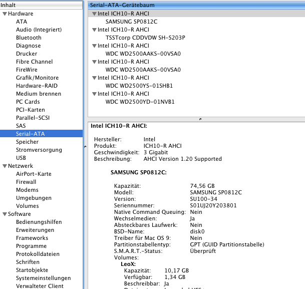

peach-os Posted February 12, 2009 Author Share Posted February 12, 2009 I was careful to only install the 7 kext files you had indicated in your guide. I'll have to figure out how to remove those kext files and try again in a more incremental fashion. that´s very easy for you: boot into LeoX, go to MacHD/System/Library/Extensions and remove the kexts. at least now you should know what the second install is for Link to comment https://www.insanelymac.com/forum/topic/132695-daw-based-on-ga-ep45-incl-hardware-list/page/8/#findComment-1078340 Share on other sites More sharing options...
garmone Posted February 12, 2009 Share Posted February 12, 2009 now you should know what the second install is for Is that all there is to it? If I simply remove all 7 I installed, I'll be back to the initial state? I certainly see the advantage of the other install - much better method than I had previously. Once I figure out which was the offending kext file, I'll pass the info along. Link to comment https://www.insanelymac.com/forum/topic/132695-daw-based-on-ga-ep45-incl-hardware-list/page/8/#findComment-1078363 Share on other sites More sharing options...
peach-os Posted February 12, 2009 Author Share Posted February 12, 2009 Is that all there is to it? If I simply remove all 7 I installed, I'll be back to the initial state? I certainly see the advantage of the other install - much better method than I had previously. Once I figure out which was the offending kext file, I'll pass the info along. yes - that´s all: back to the initial state. after that you could install one after the other to see which one is causing the trouble. Link to comment https://www.insanelymac.com/forum/topic/132695-daw-based-on-ga-ep45-incl-hardware-list/page/8/#findComment-1078503 Share on other sites More sharing options...
garmone Posted February 13, 2009 Share Posted February 13, 2009 yes - that´s all: back to the initial state. after that you could install one after the other to see which one is causing the trouble. Following your advice to install one at a time, i found that it was the AppleAHCIPort.kext which caused the biggest problem. Not only did I get a kernel panic when I installed it but then I had some "still waiting..." error on boot. I restored to the old one thanks to your method of a second install. Of note, I did not follow your advice on one point: after the first install, f-disk, chameleon and removal of the two offensive kexts, I used the comboupdate to 10.5.6. No booting into the new installation first, no kext installs, just jumped right in. This re-installed the two offending kexts so I took them out again. Rebotted and ... worked like a charm. That's when I did the one-by-one install of the kexts (actually using the kext files from the board specifically for my MB). I used UInstaller to update the video card string (works perfectly) and the time machine fix. I'm just installing the rest of the software updates now but don't expect too many issues with them (famous last words!). I'm not necessarily advocating my hybrid method over your well-tested approach but I did want to share my experience and extend my thanks for your help. Now I just need to see what that AppleAHCIPort.kext does... Thank you again. Link to comment https://www.insanelymac.com/forum/topic/132695-daw-based-on-ga-ep45-incl-hardware-list/page/8/#findComment-1078980 Share on other sites More sharing options...
peach-os Posted February 13, 2009 Author Share Posted February 13, 2009 the compability of the kexts is changing. if you install these kexts not before updating (exception smbiosenabler with 10.5.2) something like this could happen. you need the original AHCIPort.kext from the 10.5.6 update. I will upload some 10.5.6 files the next days. Link to comment https://www.insanelymac.com/forum/topic/132695-daw-based-on-ga-ep45-incl-hardware-list/page/8/#findComment-1079012 Share on other sites More sharing options...
garmone Posted February 13, 2009 Share Posted February 13, 2009 the compability of the kexts is changing. if you install these kexts not before updating (exception smbiosenabler with 10.5.2) something like this could happen. you need the original AHCIPort.kext from the 10.5.6 update. I will upload some 10.5.6 files the next days. Because I used kexthelper to install each kext while booted onto the retail hard drive, I believe a back up was made (I found it in an appropriately named backup folder). Using the combo updater to 10.5.6 from Kalyway right after installing the retail DVD, I guess I already had the 10.5.6 version of AppleAHCIPort.kext. When I subsequently "updated" this kext using the file from the EP45-UD3R thread, I got the panic. Booting back into kaly and re-installing the backed up Kext worked. This is all to say that if I understand things (and I certainly don't claim to) the current version I have installed should be the 10.5.6 version. How would I know if I need to update this kext? What 'symptom' is this fixing? I hope this isn't pushing the thread "off-topic" in that I didn't follow your guide completly... Thanks Link to comment https://www.insanelymac.com/forum/topic/132695-daw-based-on-ga-ep45-incl-hardware-list/page/8/#findComment-1079239 Share on other sites More sharing options...
peach-os Posted February 13, 2009 Author Share Posted February 13, 2009 yes, that´s going a little bit off topic - but I have a little bit time to explain it. the AHCIPort.kext includes the AHCI ports identifiers. if you use the modded kext it will recognize the ICH10, which is on the GA-EP45. using this kext your system profiler looks like this: if you use the original vanilla you will see only generic ahci ports. to change this is only cosmetics - but it´s fun make copies of both AHCIPort.kexts. rightklick on the kext and choose "show package contents".go to contents and open the info.plist with texteditor. compare the original and the modded plist, and you will know what you have to do to make the 10.5.6 kext also show the ICH10 port - it´self explaining. for editing gfx plists you should use something like "plistedit pro", but in this case texteditor does the job.copy only the parts you need - not the whole text or plist! take care about every single sign in the plist! after you changing the plist, install your modded original kext with kexthelper. Link to comment https://www.insanelymac.com/forum/topic/132695-daw-based-on-ga-ep45-incl-hardware-list/page/8/#findComment-1079398 Share on other sites More sharing options...
