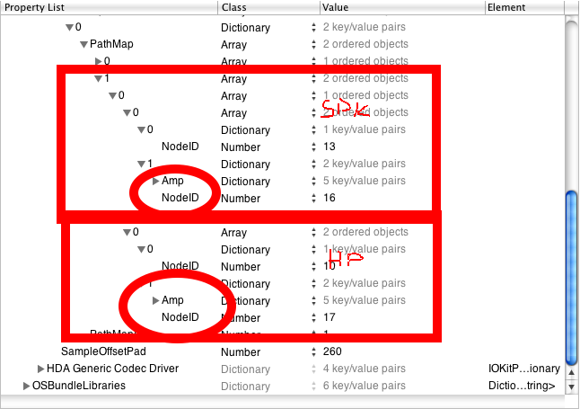

ridgeline Posted November 11, 2008 Share Posted November 11, 2008 I would just like to point out that Areos you are the man.... I had been putting too much info into my path and that is why I lost audio control...... I had the pins correct but, I was trying to hard. I was tracing all through the codec and inputing everything.... such as mixers and selectors..... I can now use my folume control for everything I see my mic but I have no options with it and it appears 7o be non-working at the moment of course this is my Internal Mic I am talking about..... Thanks Again, I will be working further and post my updates. Link to comment https://www.insanelymac.com/forum/topic/132495-how-to-getting-idt-audio-working/page/4/#findComment-962459 Share on other sites More sharing options...
AREOS Posted November 11, 2008 Share Posted November 11, 2008 I would just like to point out that Areos you are the man.... I had been putting too much info into my path and that is why I lost audio control...... I had the pins correct but, I was trying to hard. I was tracing all through the codec and inputing everything.... such as mixers and selectors..... I can now use my folume control for everything I see my mic but I have no options with it and it appears 7o be non-working at the moment of course this is my Internal Mic I am talking about..... Thanks Again, I will be working further and post my updates. I have your codec dump, and I think your Int Mic will be audio input 0x1a dec 26 this one alone in plist audio selector 0x20 dec 32 this with a boost value in plist Pin complex 0x13 dec 19 this inside plist need an amp value see the attach image. Inside this amp mod there are other values if you are using plist edit pro just copy and paste it. Good luck Link to comment https://www.insanelymac.com/forum/topic/132495-how-to-getting-idt-audio-working/page/4/#findComment-962567 Share on other sites More sharing options...

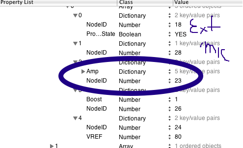

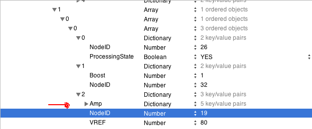

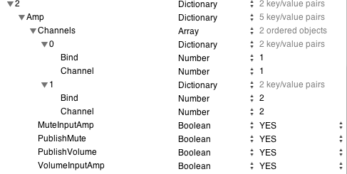

ridgeline Posted November 11, 2008 Share Posted November 11, 2008 I will try that now and hopefully have it work soon.... I get a detect on my headphone insertion however I get no sound any ideas? P.S. can you give me a view of what your amp layout is like for that mic? Okay I tried the method mentioned and I see it as a built in input but, I still can not get it to do anything I even entered the config data under the controller...... I am also still having issues with headphones, but that is what I am working on now.... I have attached what I have done so far so any Dell Studio guys it mwill save you some time and I will update as I get more done. Thanks, Mark Link to comment https://www.insanelymac.com/forum/topic/132495-how-to-getting-idt-audio-working/page/4/#findComment-962641 Share on other sites More sharing options...
AREOS Posted November 12, 2008 Share Posted November 12, 2008 I will try that now and hopefully have it work soon.... I get a detect on my headphone insertion however I get no sound any ideas? P.S. can you give me a view of what your amp layout is like for that mic? Here you go Good luck Link to comment https://www.insanelymac.com/forum/topic/132495-how-to-getting-idt-audio-working/page/4/#findComment-962844 Share on other sites More sharing options...
bartont Posted November 12, 2008 Share Posted November 12, 2008 I will try that now and hopefully have it work soon.... I get a detect on my headphone insertion however I get no sound any ideas? P.S. can you give me a view of what your amp layout is like for that mic? Okay I tried the method mentioned and I see it as a built in input but, I still can not get it to do anything I even entered the config data under the controller...... I am also still having issues with headphones, but that is what I am working on now.... I have attached what I have done so far so any Dell Studio guys it mwill save you some time and I will update as I get more done. Thanks, Mark Thank you! Internal sound is working well. No internal mic either. Link to comment https://www.insanelymac.com/forum/topic/132495-how-to-getting-idt-audio-working/page/4/#findComment-963049 Share on other sites More sharing options...
