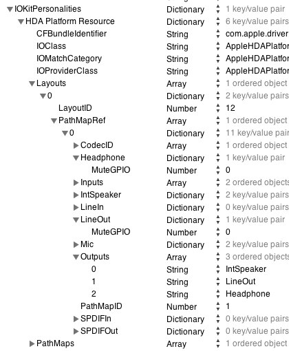

admezor Posted December 15, 2008 Share Posted December 15, 2008 I used a value from a more recent driver to stop the speakers from not muting when headphones were plugged in. Not sure what the value does, or if others will work, but this seems to work for me. In the applehda.kext/info.plist - under the headphone key set mutegpio to 1342242840 I left the IntSpeaker mutegpio at 0 I have only one small problem now, when I plug a headphone, it switch in sound properties but I still hear sound by internal speakers. Do you have any idea to resolve this? Thanks very much. Link to comment https://www.insanelymac.com/forum/topic/132495-how-to-getting-idt-audio-working/page/6/#findComment-998974 Share on other sites More sharing options...

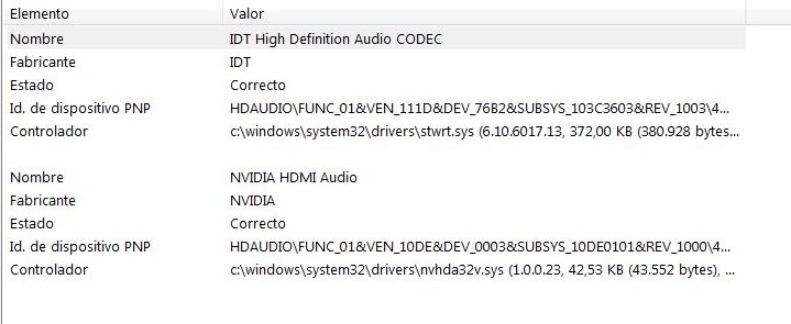

soyraro Posted January 4, 2009 Share Posted January 4, 2009 Hi all, first of all thanks to all for your help, this is my first post here so a little story about me... i have worked since 1986 with PC and Apple computers, since now i didn't care too much about working with pcs or macs but last week i bought an hp pavilion dv5-1132es, it came with Vista, i didn't care i thought because if i don't like it i can put XP, but i can't because XP doesn't support SATA drivers and HP doesn't support XP for my laptop. And... i hate Vista... is twice slower than XP. So i installed ideneb 10.5.5 and everything was fine, i patched the wi-fi and now works perfect, but sound doesn't work. These are the steps i took 1) I installed Azalea driver - no success My Chipset is nVidia 9200 M GS, Audio: Vendor 10DE Device 0003 Codec: Vendor 111D Device 76B2 2) I have edited the AppleHDA kext posted here and followed the steps posted here and the steps posted in Pin Config, which are 00a71c1f 00a71d10 00a71e21 00a71f02 00b71c20 00b71d10 00b71ea1 00b71f02 00c71cf0 00c71d00 00c71ef0 00c71f40 00d71c10 00d71d11 00d71e17 00d71f90 00e71c2e 00e71d10 00e71ea1 00e71f28 00f71cf2 00f71d00 00f71ef0 00f71f40 01471cf3 01471d00 01471ef0 01471f40 01871c70 01871d03 01871ea6 01871f90 01971cf5 01971d00 01971ef0 01971f40 01e71ca0 01e71d10 01e71e44 01e71f21 01f71cf5 01f71d00 01f71ef1 01f71f40 02071cf6 02071d00 02071ef1 02071f40 02771cf7 02771d00 02771ef0 02771f40 but not success, i get the device recognized in the Apple Profiler but not in the Sound Preference Pane, and i haven't got sound at all I post all the screen captures Any help would be appreciated, thanks in advance. Link to comment https://www.insanelymac.com/forum/topic/132495-how-to-getting-idt-audio-working/page/6/#findComment-1026388 Share on other sites More sharing options...
